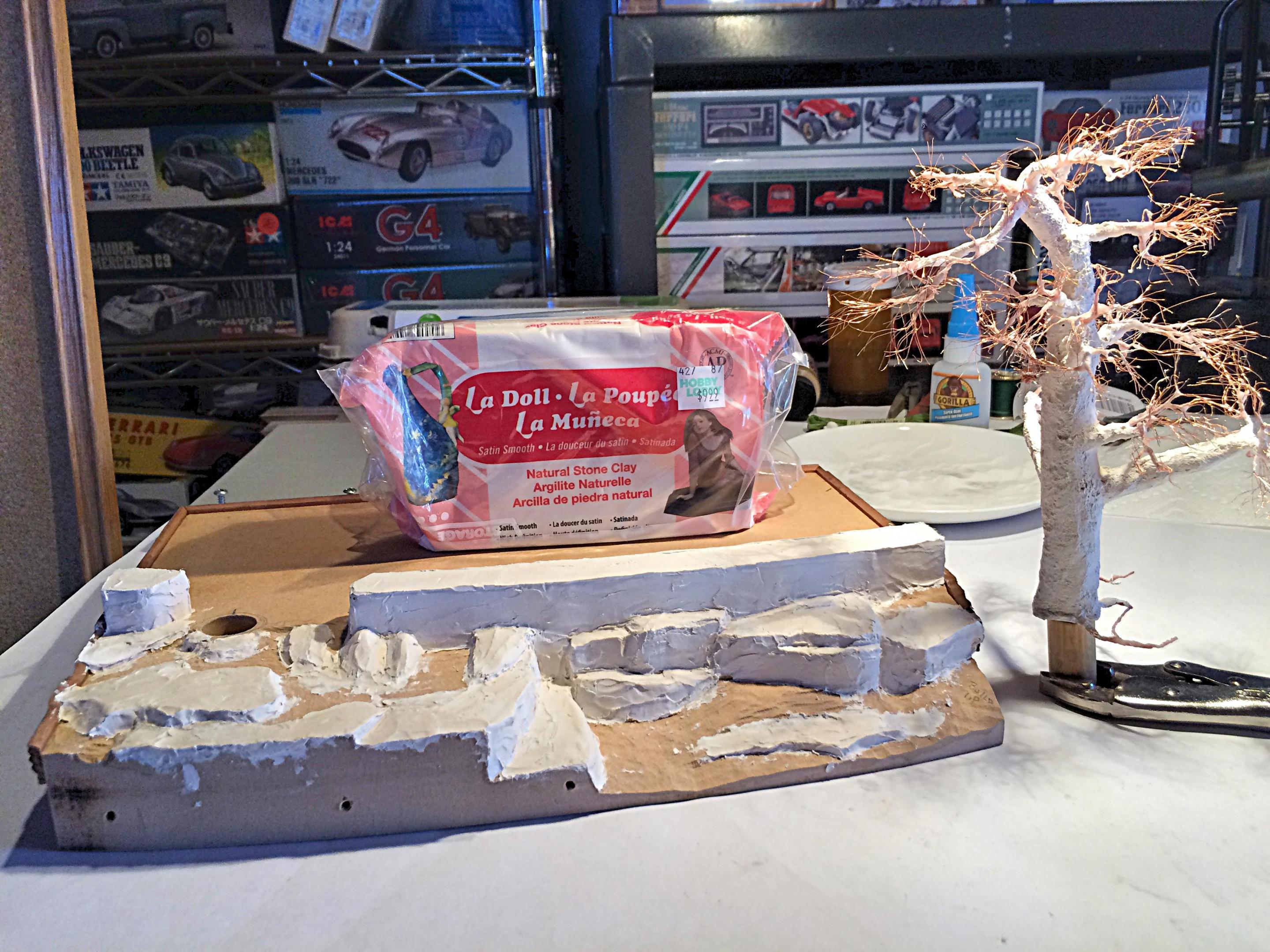

89AKurt Posted January 16, 2021 Posted January 16, 2021 I did a technique, for the first time, using a clay for crafts. I now see that I didn't do a WIP for this diorama, Grand Canyon Roadster. I can elaborate if you want.
