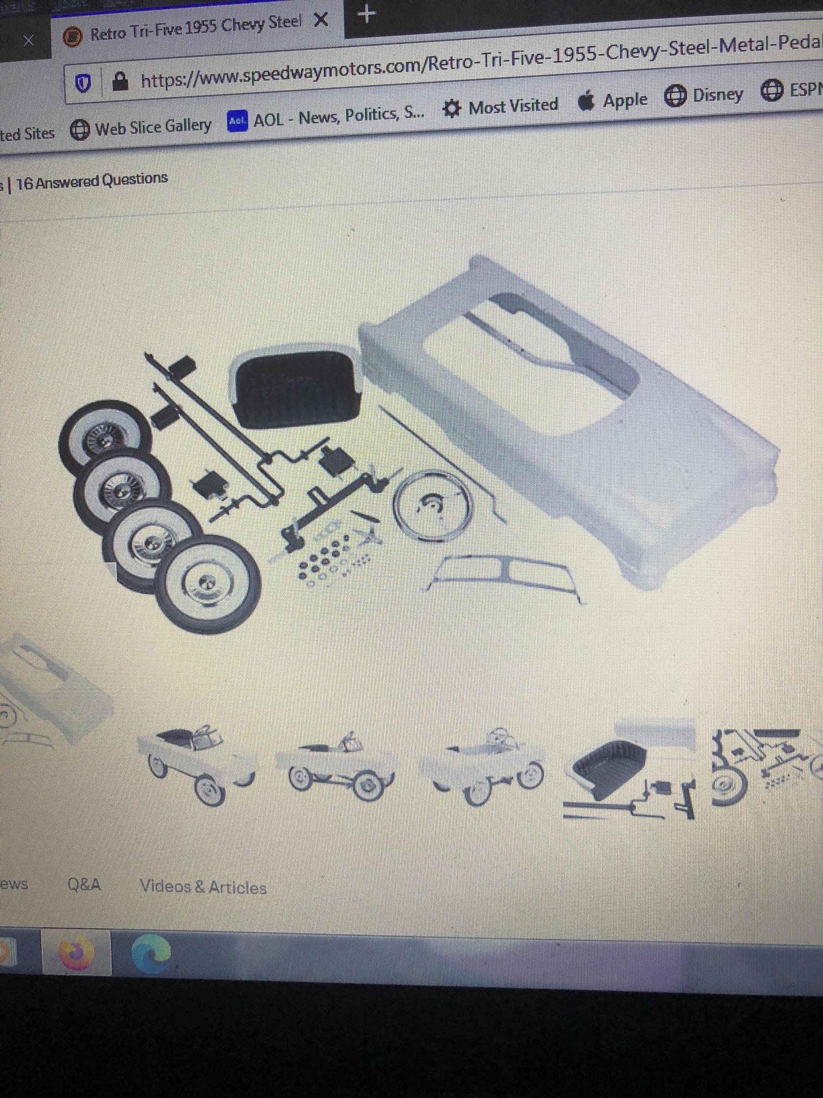

cobraman Posted January 11, 2021 Posted January 11, 2021 Wondering if anyone here ever painted and built one of these kits ?
doorsovdoon Posted January 12, 2021 Posted January 12, 2021 Is it an actual pedal car? I have one like that rusting away in my back garden, been meaning to restore it for years.
cobraman Posted January 12, 2021 Author Posted January 12, 2021 Yes it is a kit for kids under 5 or so. Thinking of building one for my 15 month old grandson.
Tom Geiger Posted January 13, 2021 Posted January 13, 2021 Hey Ray- I don't know what they have it listed for on eBay, but go directly to their website... The unpainted kit is $199 with free shipping. And they'll give you $10 off your first order to join their mailing list. There are also painted versions for $239. https://www.speedwaymotors.com/Search?query=pedal+car
cobraman Posted January 13, 2021 Author Posted January 13, 2021 Thanks Tom. The finished ones don't cost much more but I am thinking like it could be a fun project.
Toner283 Posted January 13, 2021 Posted January 13, 2021 I don't have one exactly the same as that but I did get the little speedster from Speedway Motors. Looks a bit like a Model A Roadster. I bought mine pre-painted as we were on a deadline for our wedding and my little guy needed something to ride down the aisle in because he couldn't walk yet. My observations on the kit that I bought were: Take all of the hardware (nuts bolts washers) that came with the kit, save yourself the aggravation and pitch them. They are twist and toss offshore garbage. You just about get them tight and they either strip or they skip. That and the cheapy Chrome that was on the ones that came with the kit - after the car sat outside overnight after the wedding were rusty already in the morning. Hate to see what they look like after they've been the summer outside. Replace them with good quality mild steel bolts or if the pedal cars going to get played with a lot and be outside a lot, replace them with stainless. Minimal cost for the number of bolts and nuts etc that you need to buy. The ones on my son's pedal car are getting replaced now that the wedding is over with. As an added bonus, quality stainless Hardware can be polished to a pretty nice shine. Don't expect any two holes to line up while assembling the pieces. If they do it's a bonus. Several of the parts that I had the holes were not a big enough diameter for the provided nuts and bolts to go through. In addition to this, most of the holes were not round, off center, or both. A couple of the pieces, the hole pitch was off causing me to have to re-drill 1/2 a hole to get things to line up. Other than those minor assembly irritations, the car looked really cool at the wedding and was a big hit with both people taking pictures and other kids taking it for a ride after the ceremony. I can't wait for my little guy to get big enough to be actually be able to pedal it. My biggest advice if you were buying an unpainted one, would be to totally assemble it and make sure everything fits properly and runs smooth then blow it apart to paint it. That would save any nasty surprises and having to drill holes in the freshly painted body.? I've been there and it's no fun. ???
