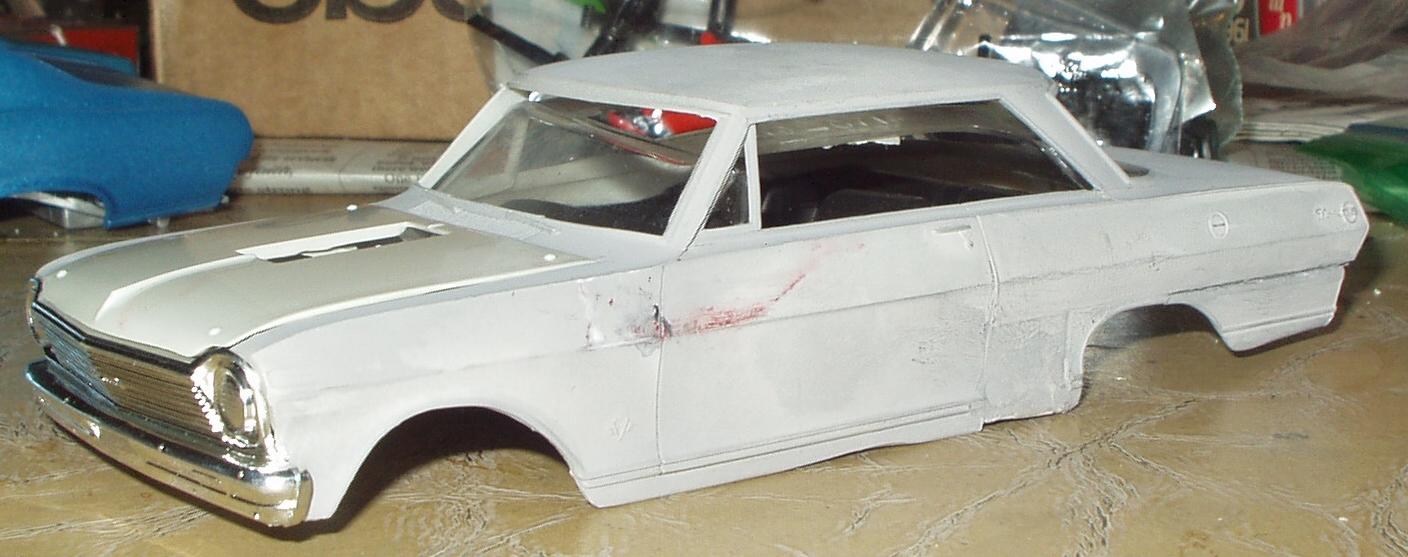

Snake45 Posted January 17, 2021 Posted January 17, 2021 (edited) 18 hours ago, ranma said: Your welcome! There are a few of the factory stock copies on ebay for decent price.. Look for the stock red nova on the cover either copy of it . Oh I have several copies of that kit. I'm currently working on building up a Pro Street version using junk and castoff parts, and was thinking of seeing if I could build up an equally junk '65 Nova body to swap onto it, "Switchers" style. Your details told me exactly what to look for, and where. I think I can trim down the PS chassis to fit under the earlier body and still have it usable under the '66. Here's the junk '65 body I want to rehabilitate and put on the same chassis, too. Sorry, didn't mean to hijack your thread. I apologize. Edited January 17, 2021 by Snake45
