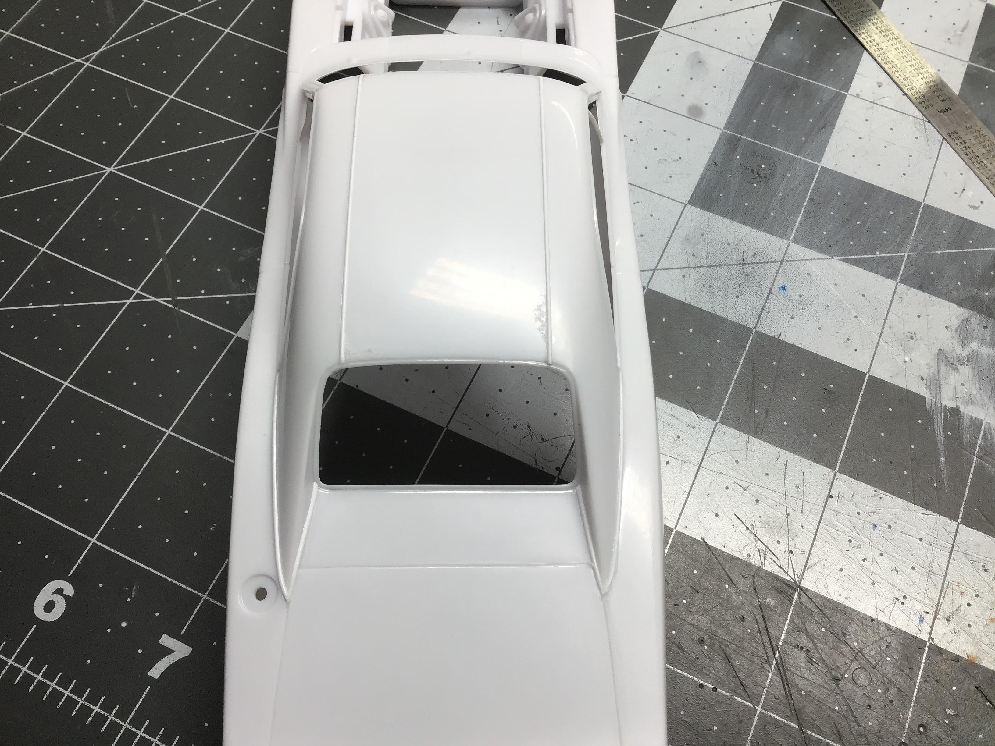

MrObsessive Posted January 16, 2021 Posted January 16, 2021 Ooooh...........If it were me doing this, I would add those strips before putting down any paint. Please do NOT use super glue. That'll make more of a mess than it's worth. Frankly, I'd strip the roof of the paint, put down your strips using a liquid cement (Tenax, or some other MEK equivalent) and then paint afterwards once I was satisfied with the roof. Here's a project I was working on (and will get back to within this year hopefully), where I added strips to simulate the seams for a vinyl roof. Note that there's no paint on the roof as of yet......that will come MUCH later after all is said and done with anymore bodywork and interior done. BTW, you mention cutting strips. Out there in the aftermarket there are those size strips made by Evergreen which will save you a LOT of work. The ones I used were a tad smaller and I did sand them down a bit as on the 1:1, they are not overly intrusive to the eye as far as seams. Hope this helps!
Paul Payne Posted January 16, 2021 Posted January 16, 2021 Bill, just had to ask- will the 1/8 Mustang have the working windshield defrosters?!?!?!? Seriously, the pictures for the vinyl roof show beautifully separated vent windows and really tight panel lines- immaculate work as usual!
MrObsessive Posted January 16, 2021 Posted January 16, 2021 Thanks Paul! As time moves on and my eyesight is not as good as it was even four years ago, the Mustang you see may be one of the last superdetailed ones I do from here on out. I had lost a bit of interest in it, but definitely want to get back to it and see it done. Right now I recently finished repainting the '55 Ford Victoria project which had its own issues with bodywork a while back. Now clearcoating is the next step in a little bit. I'll be shortly putting pics up of the SECOND time I've had to paint the Ford. Hopefully it's the last.
