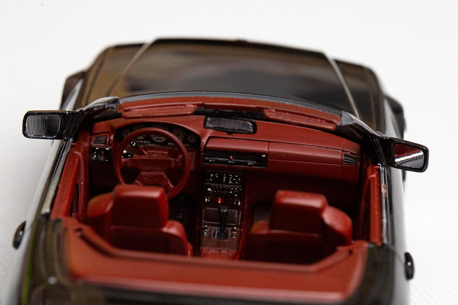

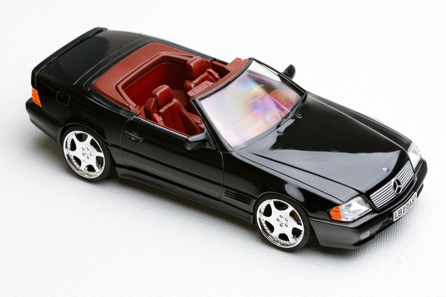

Hey all, while I’m waiting to finish up my second build for 2021, thought I’d share one of my old builds from 2010 (It's not the cleanest build I've done - with lots of sloppy work around the details). Overall it’s a great Tamiya kit to build box stock, and I wanted to replicate R129 modified by Carlsson, so I added larger & wider Aoshima Carlsson wheel and larger muffler. (The OZ aero wheels from the kit were used for my 500SEC build)
Build details
- Tamiya grey primer
- Three coats of Tamiya TS-14 then polished w/o clear coat
- TS-33 dull red for interior
- BMF’d window trims
- Lowered suspension
- Used later style headlamp/tailight pattern
- Added PE seatbelts and metal transfer amblem
Hope y'all enjoy!

Thanks! I love painting in black! I forgot to mention I masked the center console and spray painted with red and black to simulate woodgrain.

Thanks! I remember building this in hot summer,  where paint would get micro holes (especially on front & rear bumpers )after laying wet coats which was PITA to fix! Dark color helps hiding the flaw.
