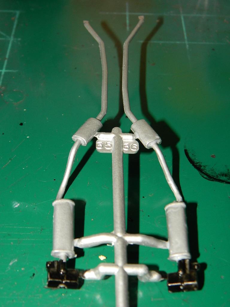

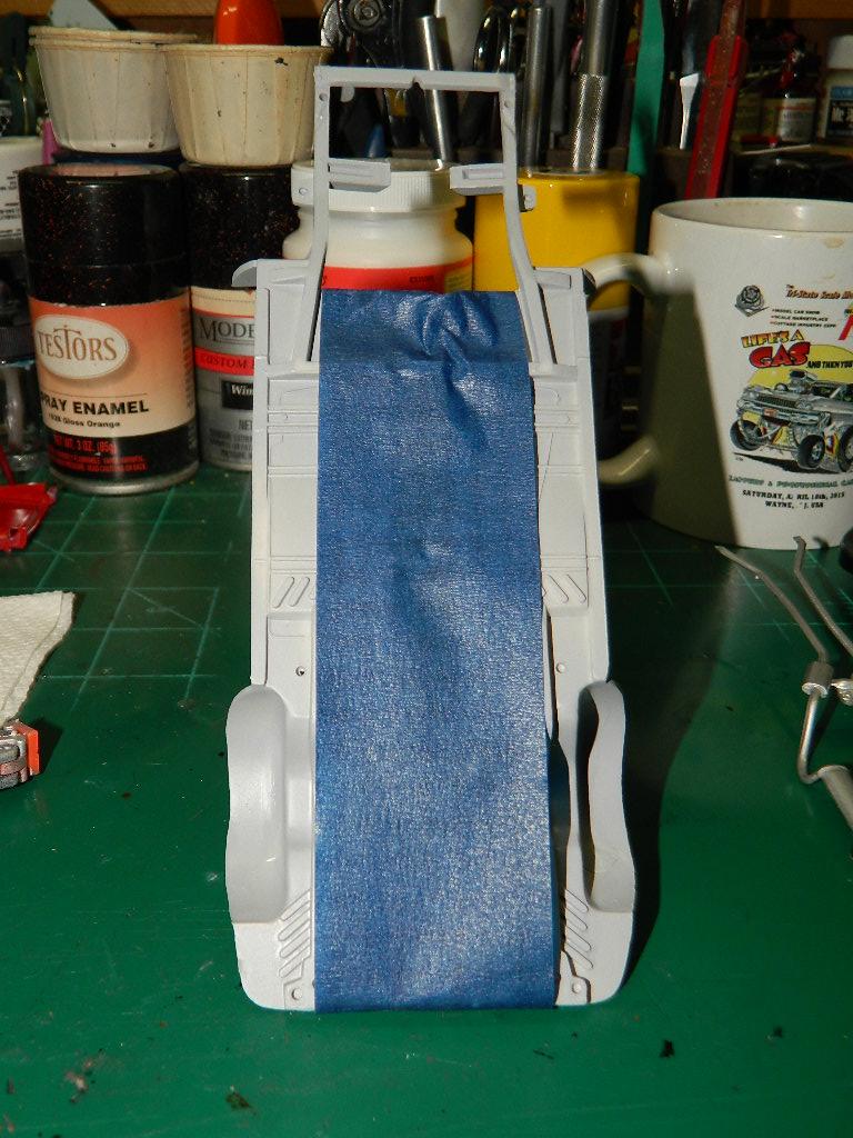

mrmike Posted February 12, 2021 Author Posted February 12, 2021 A little time spent on Gibbs '71 Challenger Hemi R/T. The front and rear suspension has been painted with Tamiya TS-29 Semi Glosss Black. I painted the exhaust system with Model Master Aluminium Spray and after a few days of drying, a coat of Model Master Acryl Semi Gloss Clear. The exhaust tips were painted with Alclad II Gloss Black Base in prep for some Alclad II Chrome. On the chassis, I added a piece of 1 1/2" wide painters tape and I'll spray directly from above some Tamiya TS-16 Yellow for overspray. More NCIS to come...

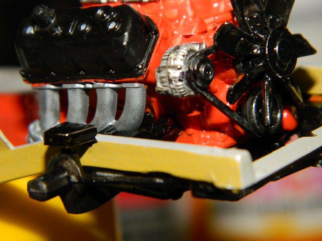

mrmike Posted February 12, 2021 Author Posted February 12, 2021 I got the chassis and engine mostly assembled. I have to wire the engine, distributor and the ignition coil. I placed the engine in the chassis and I expected the engine mounts to interfere with the exhaust headers. Behind the right side header is a tab on the engine that is supposed to fit into the slot on the engine mount. I'll clearance the engine mount until the tab fits into the slot. More NCIS to come...
mrmike Posted February 13, 2021 Author Posted February 13, 2021 Thanks Carl! After modifing the engine mounts, it is on to the wheels and tires.
mrmike Posted February 13, 2021 Author Posted February 13, 2021 I clearanced the engine mount for the right exhaust header and I clearanced the left engine mount a little just for the Hell of it. I then paint detailed the mounts and the upper A arms. More NCIS to come...

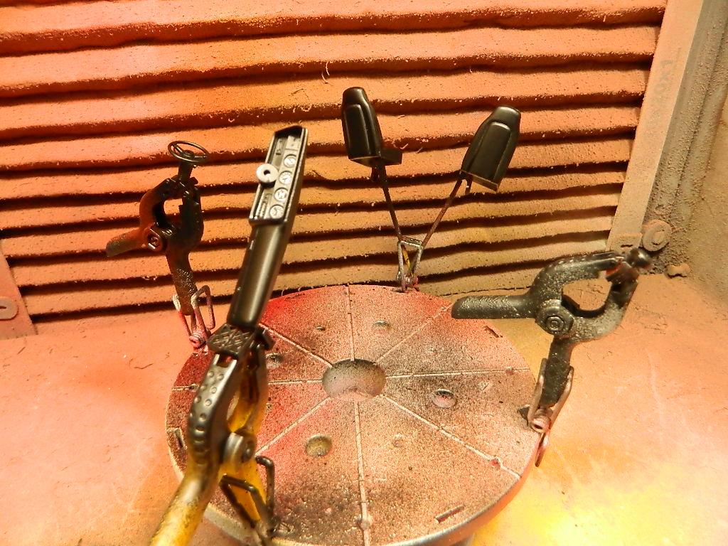

mrmike Posted February 15, 2021 Author Posted February 15, 2021 I decided to strip the hood since I didn't like how the primer coat went down on it. I also decided to strip the from valance panel, too. I painted the interior bucket and the interior pieces with Tamiya TS-29 Semi Gloss Black. Now for some detailing! NCIS will continue...

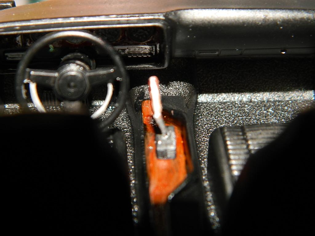

mrmike Posted February 16, 2021 Author Posted February 16, 2021 I have detailed and assembled the interior. NCIS will continue...
mrmike Posted February 17, 2021 Author Posted February 17, 2021 Thanks Carl! It's not the best interior to detail, but I tried.
FLHCAHZ Posted February 17, 2021 Posted February 17, 2021 Looks really good. Nice job on the wood grain and pistol grip!
mrmike Posted February 18, 2021 Author Posted February 18, 2021 Thanks Chaz! The pistol grip shifter is from the Revell '70 'Cuda. The woodgrain was made by applying Tamiya XF-10 Flat Brown and letting it dry. Then I applied Tamiya X-26 Clear Orange.

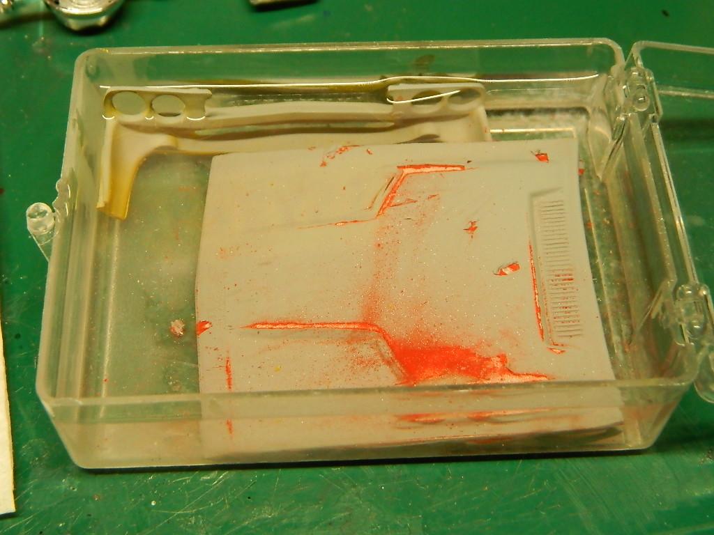

mrmike Posted March 1, 2021 Author Posted March 1, 2021 After leaving the front panel and the hood in 91% alcohol for over a week, I washed them this morning with Dawn Dish Detergent. The alcohol did its job of removing the old paint. Now to primer and paint them both after a good sanding. Momre NCIS to come...

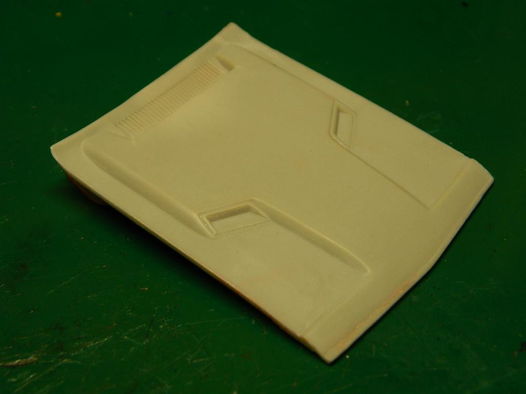

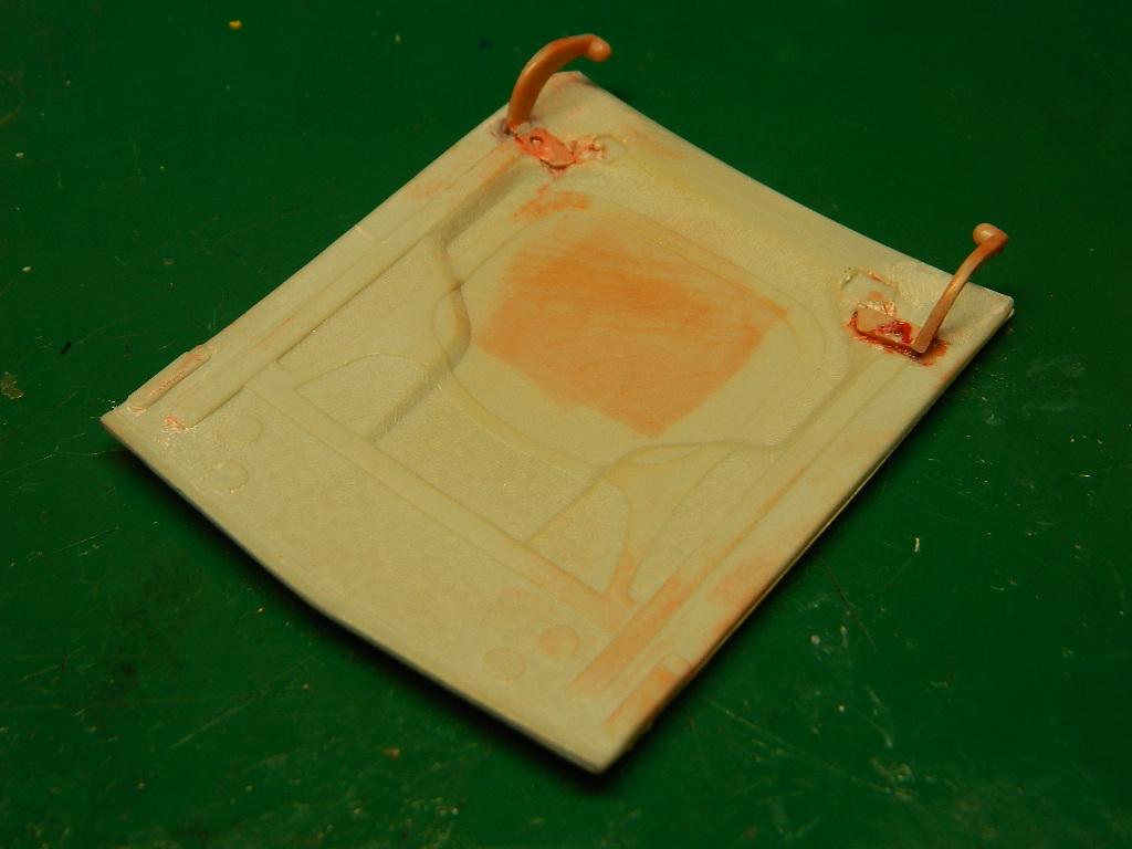

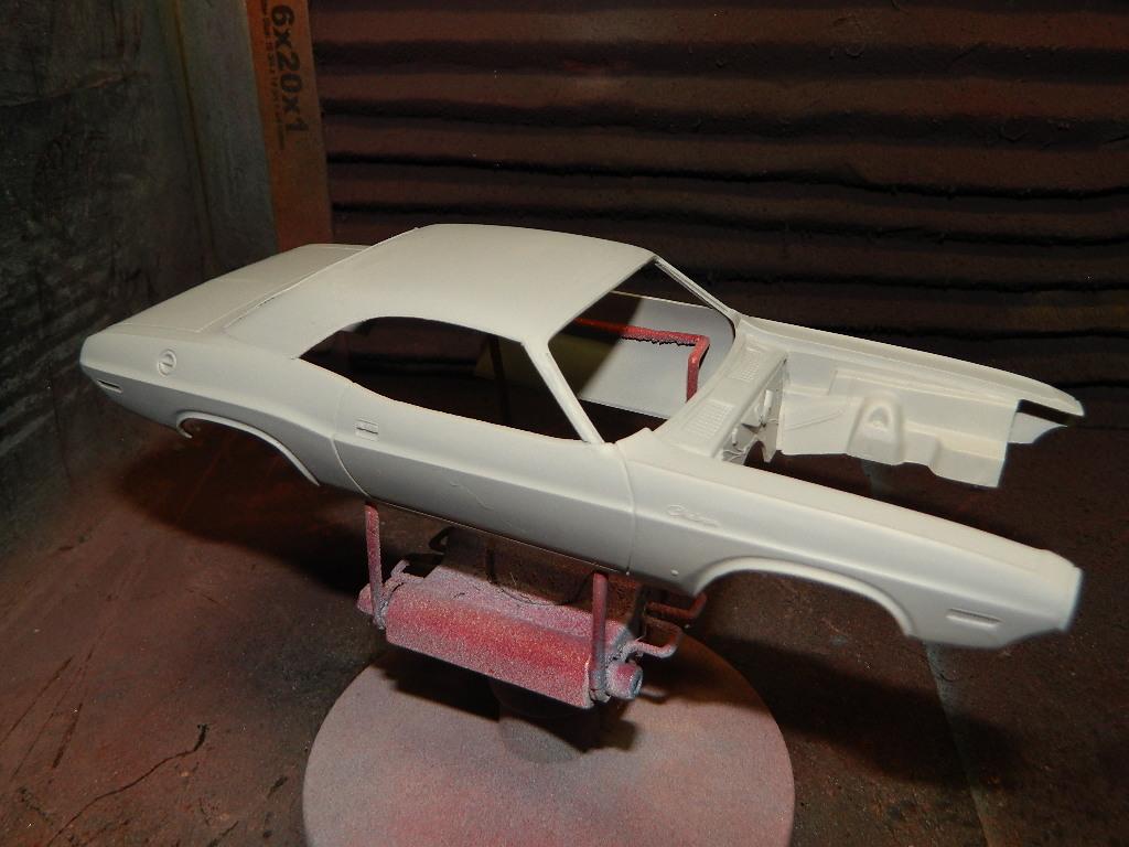

mrmike Posted March 14, 2021 Author Posted March 14, 2021 Been working on the C pillars of the Challenger roof today. Still needs more work. I also primered the hood and front valance. More NCIS to come...

Just Jim Posted March 16, 2021 Posted March 16, 2021 Challenger looks great. I have seen several models like yours where the chassis was over sprayed with body color on the edges. Is that a late 60's / early 70's GM thing? I admittedly haven't spent much time under many old cars so I've never seen this in real life. However, I do have a 69 Charger and a 70 Challenger working their way to the top of my build rotation so would like to get it right.
mrmike Posted March 17, 2021 Author Posted March 17, 2021 Just imagine a 1:1 Chrysler being assembled on the production line. The body assembly is quite different from what we get in the form of a model kit. When the body is painted, the chassis is part of the body assembly and the chassis is painted along the edges as the body gets painted. I have seen some models with the entire chassis (bottom of the entire body assembly) painted in one color and either the modeler doesn't care or they don't know how the body and chassis is painted. I have learned a lot from the late Fury3 aka Dave Greibling who once worked for Chrysler Corporation.
