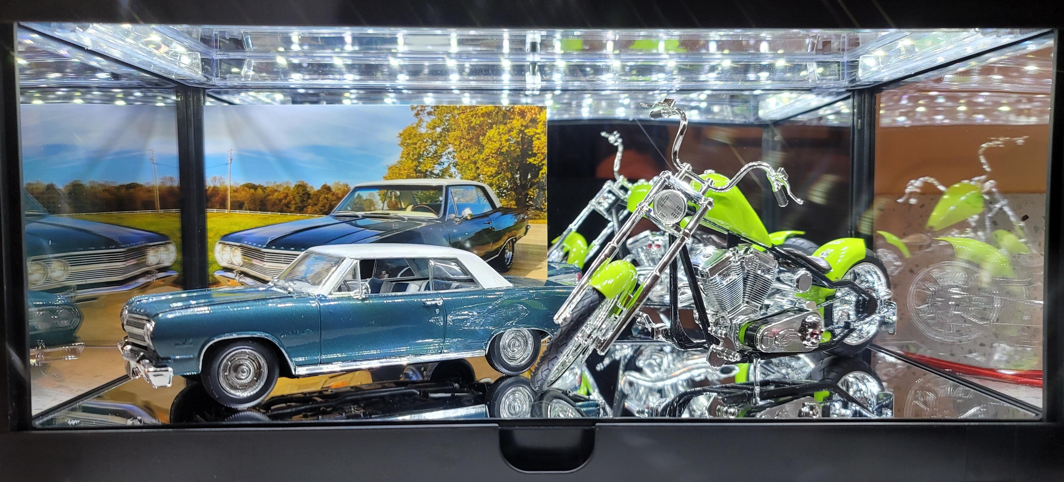

SpeedShift Posted March 21, 2024 Author Posted March 21, 2024 4 hours ago, TopherMcGinnis said: MCW paints are great. I've used their lacquer with great results. Their factory colors are spot on. I like Createx paints as well. I painted the Chevelle with MCW lacquer Tahitian Turquoise and the bike with Createx(can't recall the name right off). I've heard MCW 's line of enamels is very good as well. They have a hardening additive to speed the drying time, and their own gloss, which according to some isn't needed.

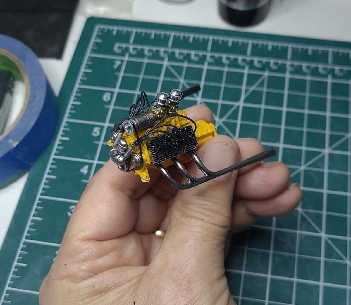

SpeedShift Posted April 12, 2024 Author Posted April 12, 2024 Took some time to add a few things, added distributor and wiring for the flathead engine, trial fit the windshield frame and wheels on disc backing plates, dashboard interior fitting and steering column. 6

Zippi Posted May 4, 2024 Posted May 4, 2024 I'm really diggin the flatty. What color is that on the chrome parts? Looks nice.

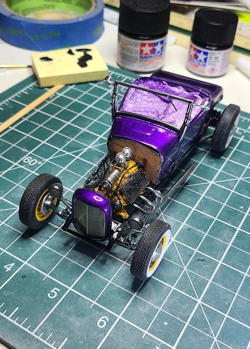

SpeedShift Posted May 4, 2024 Author Posted May 4, 2024 (edited) Worked on chopped 32 Ford grill with PE insert, trial fit major parts. Had to mask over body shell for gloss (Testors Wet Look) spray. Edited May 4, 2024 by SpeedShift 5
SpeedShift Posted May 4, 2024 Author Posted May 4, 2024 (edited) 11 hours ago, Zippi said: I'm really diggin the flatty. What color is that on the chrome parts? Looks nice. I've been using a light spray of Alclad chrome or aluminum over a black gloss undercoat, but handling the chrome parts during fit up tends to tarnish them. I'm now using AK super chrome which is really good stuff. The air cleaners and little moon hub caps are metal aftermarket parts. Edited May 4, 2024 by SpeedShift
SpeedShift Posted May 21, 2024 Author Posted May 21, 2024 (edited) Getting close to finishing this one. Frustrating story time: Paint After taking a close look at the paint finish on the body, I had to decide if I could live with it and proceed to finish this one. It doesn't show in the pictures, but the first paint job had so much tiny pitting from the Testors rattle can paint frothing up along the raised body panel lines, I ended up wet sanding the pitting and putting on another coat. That second coat was better - but still not very good, the paint frothed up again - so I wet sanded some more and tried a third coat but this time only after decanting the paint and letting it settle down and gas off in a jar, and then airbrushing rather than spraying direct from the can. Third try was better, but after wet sanding and polishing the blemishes, the raised detail by now was pretty much gone and worse...inconsistent overall, and close inspection of the surface revealed a lot tiny scratches that just would not polish out. Every time I looked at the paint job ......I imagined myself looking at this project in the future - and seeing nothing but the imperfections. So, I pulled out a "backup" resin body (a Jimmy Flintstone), with idea to transfer the interior tub from the first body shell to a new resin body, and if there was enough paint left in the can, I could try and get a better finish by decanting and airbrushing the backup resin body. Surprise, the backup resin body was just different enough in dimension from the original body (All American Resin) that the interior tub would not fit. So, while I primed and painted the new body shell, I scratch built a second interior with a few modifications to fit the new back up body (not as hard a task as I thought since I had scratch built the first interior - so it was just a matter of copying the first interior and trial fitting it to the second body), Took only two evenings but I got that done, and the second paint job is much better, as good as I can do with what's left in the discontinued Testors rattle can (if anyone has a can of Testors Ultraviolet Pearl let me know, I really like that color). At this point, moving along again on this build, I put some more detail on the engine - radiator hoses fuel bowl and now outfitting the fire wall with the fuel log and beehive oil filter. Long story short: As much as I wanted to get this one finished, sometimes you have to set the bar higher ......for yourself. Edited May 21, 2024 by SpeedShift 4
customline Posted May 21, 2024 Posted May 21, 2024 Looks pretty dam good to me, Jim. I've got a thing for the '27 roadster. Put the other body in the pond. It deserves a second chance. That ultraviolet pearl is freakin' awesome. 1

SpeedShift Posted May 21, 2024 Author Posted May 21, 2024 (edited) 15 hours ago, customline said: Looks pretty dam good to me, Jim. I've got a thing for the '27 roadster. Put the other body in the pond. It deserves a second chance. That ultraviolet pearl is freakin' awesome. Thanks Jim - I really like the color too. Purple and yellow are complementary colors on the color chart so the combination of the two works. I went through a testing process to find the color.... retrieved this from my earlier posts on this build (OMG - has it really been 3 years?) : Posted January 23, 2021 (edited) I've been debating the color scheme for this '27 T in my head ...what I was sure of...I wanted a dark body/grill color with complementary (opposite) color on the wheels/engine Black is a bit too often used, I like red too, but that is a bit common as well. Been reading Al Drakes book on fifties hot rods, there were purple cars back then, even some on the dry lakes. I thought I maybe a very dark blue/violet metallic with red or maybe yellow orange steelie wheels. After searching the rattle can racks I couldn't find exactly what I wanted....the choices: Tamiya Blue Violet........ value too pale, hue a bit bland light blue, a solid color, a metallic might be better Tamiya Deep Metallic Blue......right value, dark, but hue was too blue, not enough violet Model Master Deep Pearlescent Purple enamel.........dark enough but not exciting Model Master/Rustoleum Ford Ultra Violet Pearl Lacquer.........the right value, dark, and a deep violet hue, and its a fast drying lacquer "Put the other body in the pond. It deserves a second chance." Yes, maybe if I stripped it and somehow revitalized the raised detail and got a good coat of primer on it - it could have a second life. Kinda burnt out on the '27 T for the time being, but I got a thing for 27 Ts myself. Edited May 21, 2024 by SpeedShift
SpeedShift Posted May 21, 2024 Author Posted May 21, 2024 14 hours ago, styromaniac said: Modlbldr saw my plea for a can of the discontinued Ultraviolet Pearl in my "Wanted" post. He found a can in his stash that he thinks has some left in it. Its on its way to me now. Well, thanks for looking for me.... I may need to think about a new project that uses that Ultraviolet color...not sure if I should mess around with this one further....and just go with this third paint job and give it a wax job and not tempt fate.
