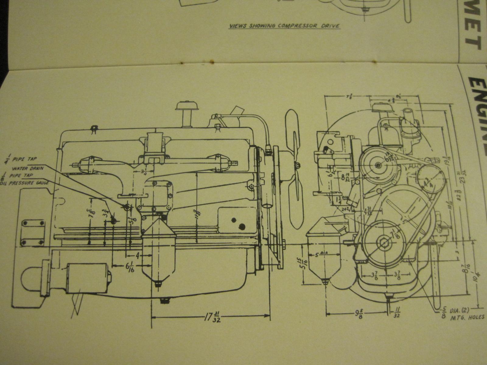

leafsprings Posted February 13, 2021 Posted February 13, 2021 (edited) Very nice work on this classic. Some Gold Comet dimensions for you. The Mack diesel might be a good donor block candidate Edited February 13, 2021 by leafsprings
Chariots of Fire Posted February 13, 2021 Author Posted February 13, 2021 Oh,Wow! thanks for the drawings! I found a block to start with but now I will have to check the dimensions to see if it is close. These also give me some details I was looking for. Images I found are not that clear. thanks again "Leafsprings!!
DRIPTROIT 71 Posted February 13, 2021 Posted February 13, 2021 14 hours ago, leafsprings said: Very nice work on this classic. Some Gold Comet dimensions for you. The Mack diesel might be a good donor block candidate I used to think that I had some good reference materials. You seem to have it all. I’ve been wanting to find something like this for a couple years. White bought this engine and used it under their name from what I understand, and I’m wanting to build a 9000 project with one of these. Thank you for posting this!!
Chariots of Fire Posted February 16, 2021 Author Posted February 16, 2021 Using the images above and the dimensions shown I was able to capture a reasonable engine. I found that the Opel Blitz engine was close to the correct size but I had to make some changes. The manifold and spark plugs are completely reversed so I cut off the bell housing from one end and glued it to the opposite end of the block. Then some fabrication was done for where the crank case pulley and water pump pulley are located. The outside water jacket was a pieceo of exhaust manifold from the parts box. I made the distributer and added the Opel carb and manifold pieces without any changes. The air cleaner was too small however so I found a clear wiggly eye in the parts box and attached it to some tubing and painted it black. Three pulleys were turned on the lathe. I'll keep them unpainted aluminum. A strip of black electrical tape will be wound around the pulleys for the fan belt. The driveshaft was in the parts box but the shaft itself was made of brass tubing so that it could be put in place, and slid to its full length in the holes in the end of the transmission and the differential The paint color is a bit light for a Gold Comet engine but the engine will be given a dark wash to give it some tone and some highlights. The exhaust manifold needs some browning up as well. The engine sits in the frame using front and rear mounting points. The mounts are drilled for pins so it can be located in the same place each time it is set in. During the building process it will be taken out and put back any number of times for fitting various other details.
