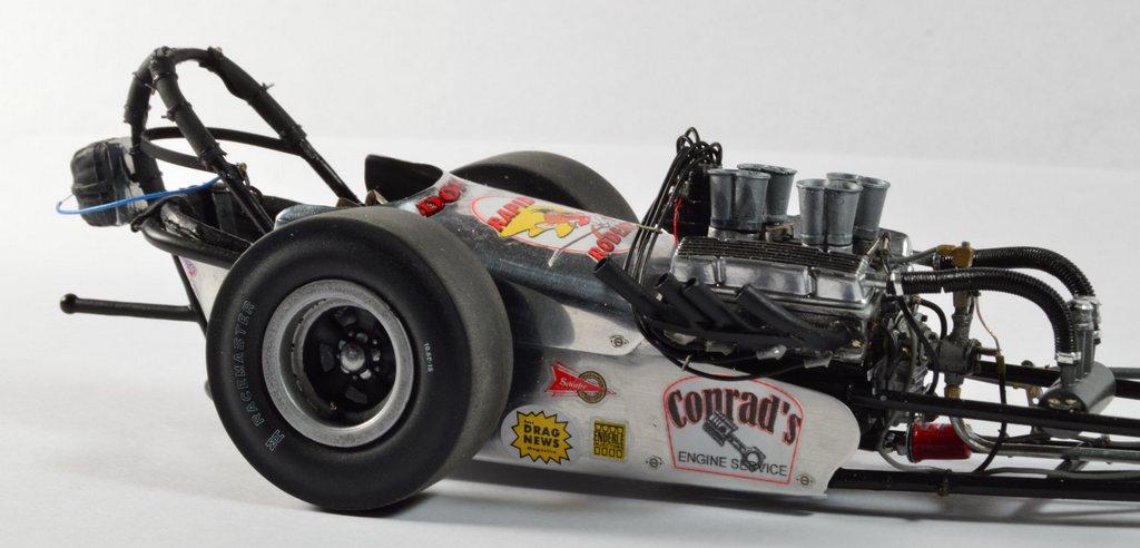

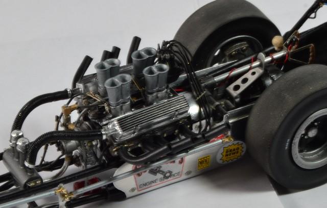

Straightliner59 Posted February 8, 2021 Posted February 8, 2021 I used some springs for the puke hoses on my junior fueler. This also illustrates just how long these have been in use. This represents a car from '68-'70, and they were in use at that time. I used the copper conductor wire from some Romex, to hold their shape. Clamps are aluminum duct tape. 1
