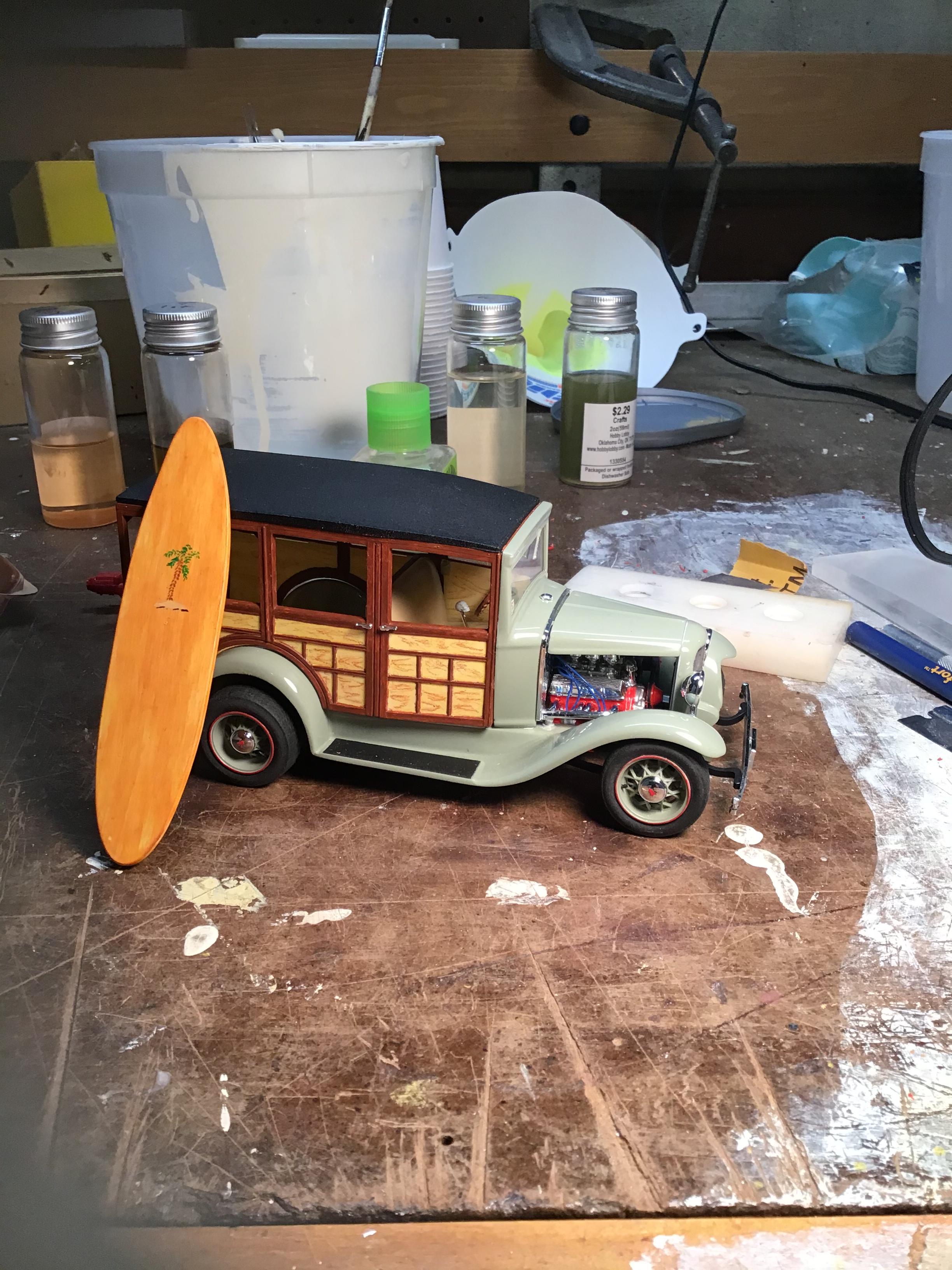

Rick L Posted February 9, 2021 Posted February 9, 2021 On this surfboard I started with Model Master chrome yellow over white styrene. Then a Vallejo rust wash over that. If you want a deeper color such as walnut or mahogany go lastly with a third darker color such as Model Master rust. Use a coarse dry brush technique and let each color dry before putting on the next. This is a case where you WANT to see the brush strokes. Just be sure not to completely cover the previous coat.
