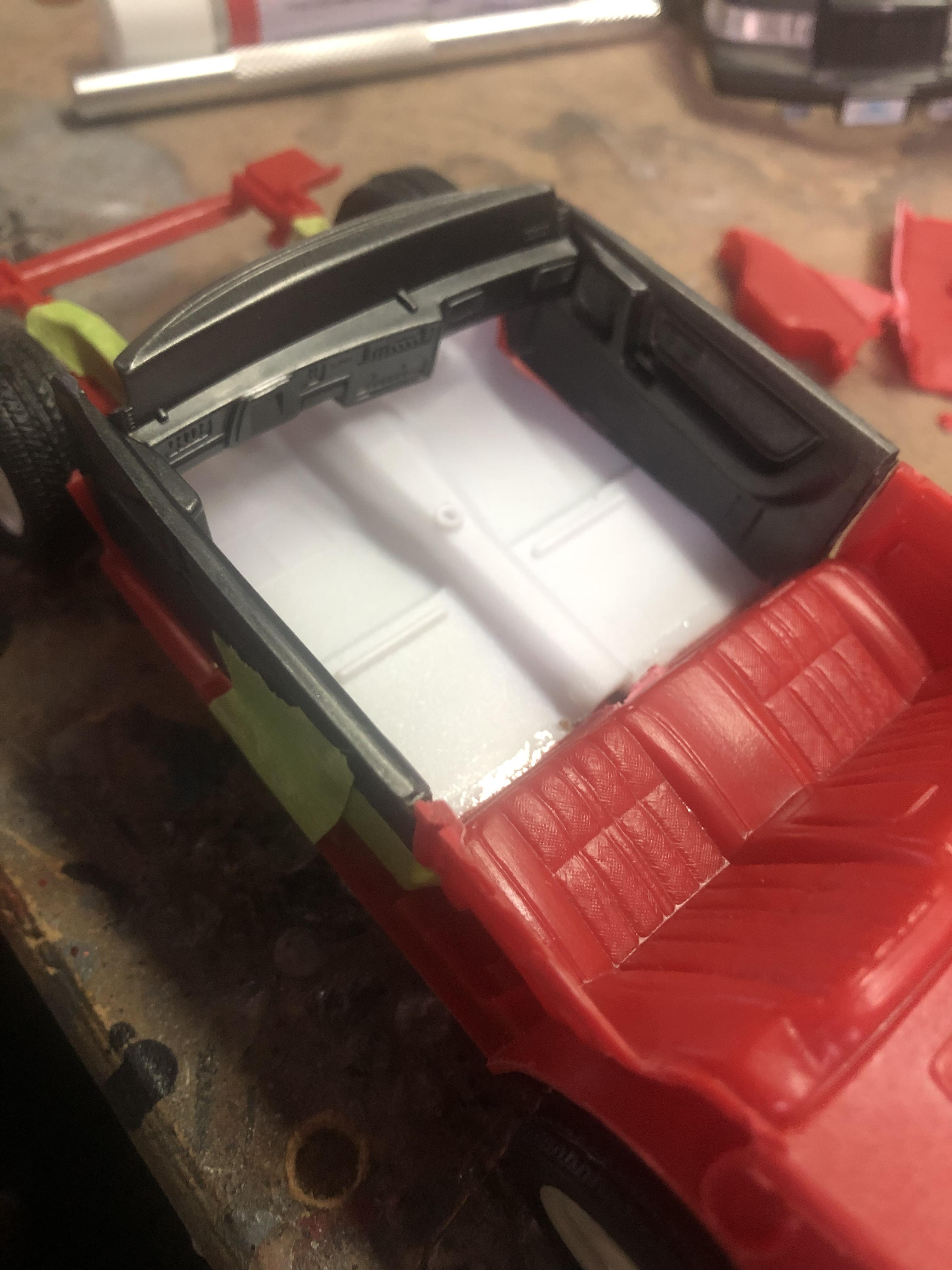

added the inner fender/strut towers from the Mustang kit. Also decided the Thunderbird interior tub needed to be modified. I used the floor from the Mustang kit while the back seat and package shelf are Thunderbird.

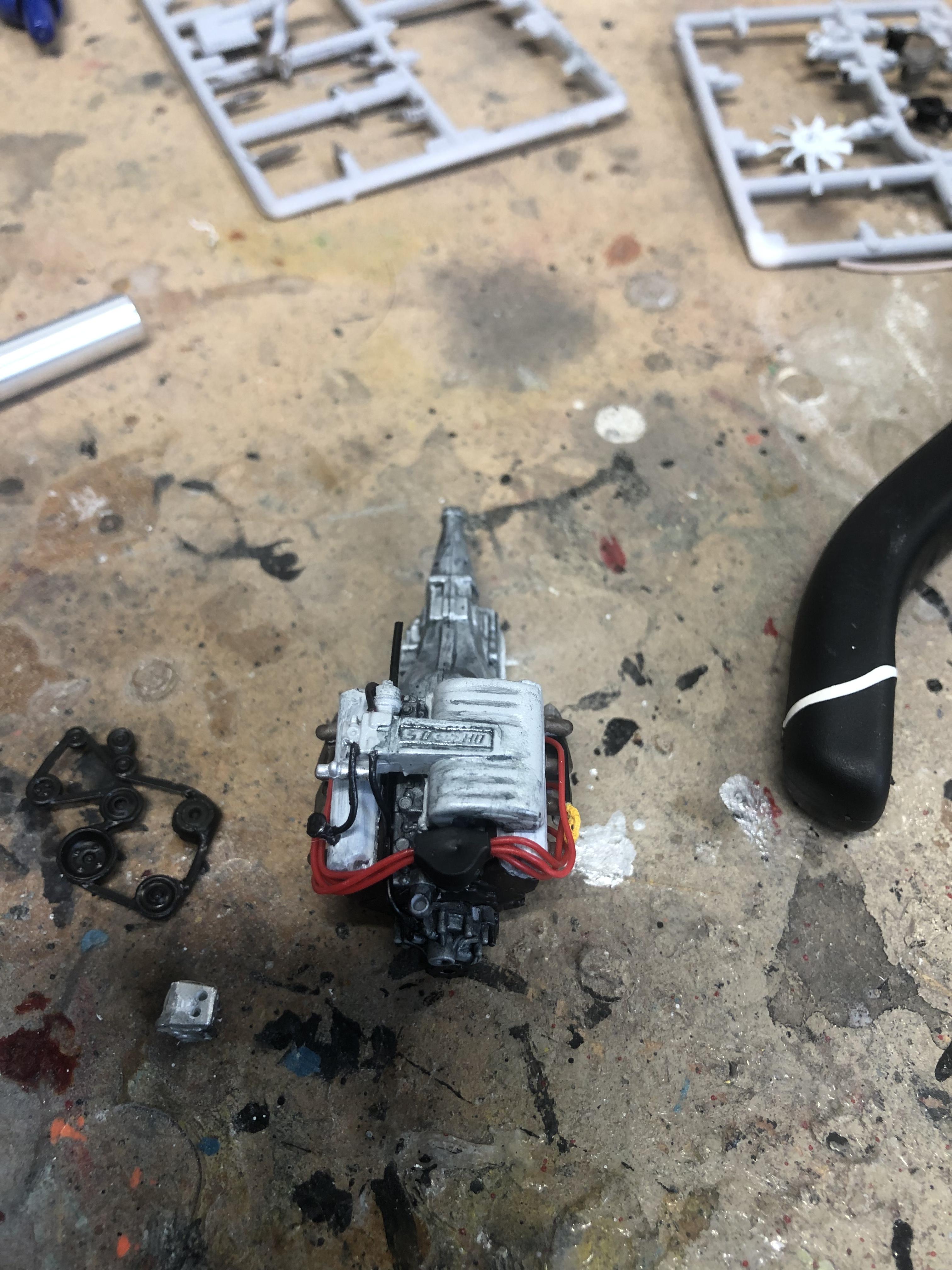

test fitting a 302. Will be using the one from the Mustang kit as it is more detailed then the one from my parts bin in this pic. Also have to cut off the T5 and adapt the AOD trans.

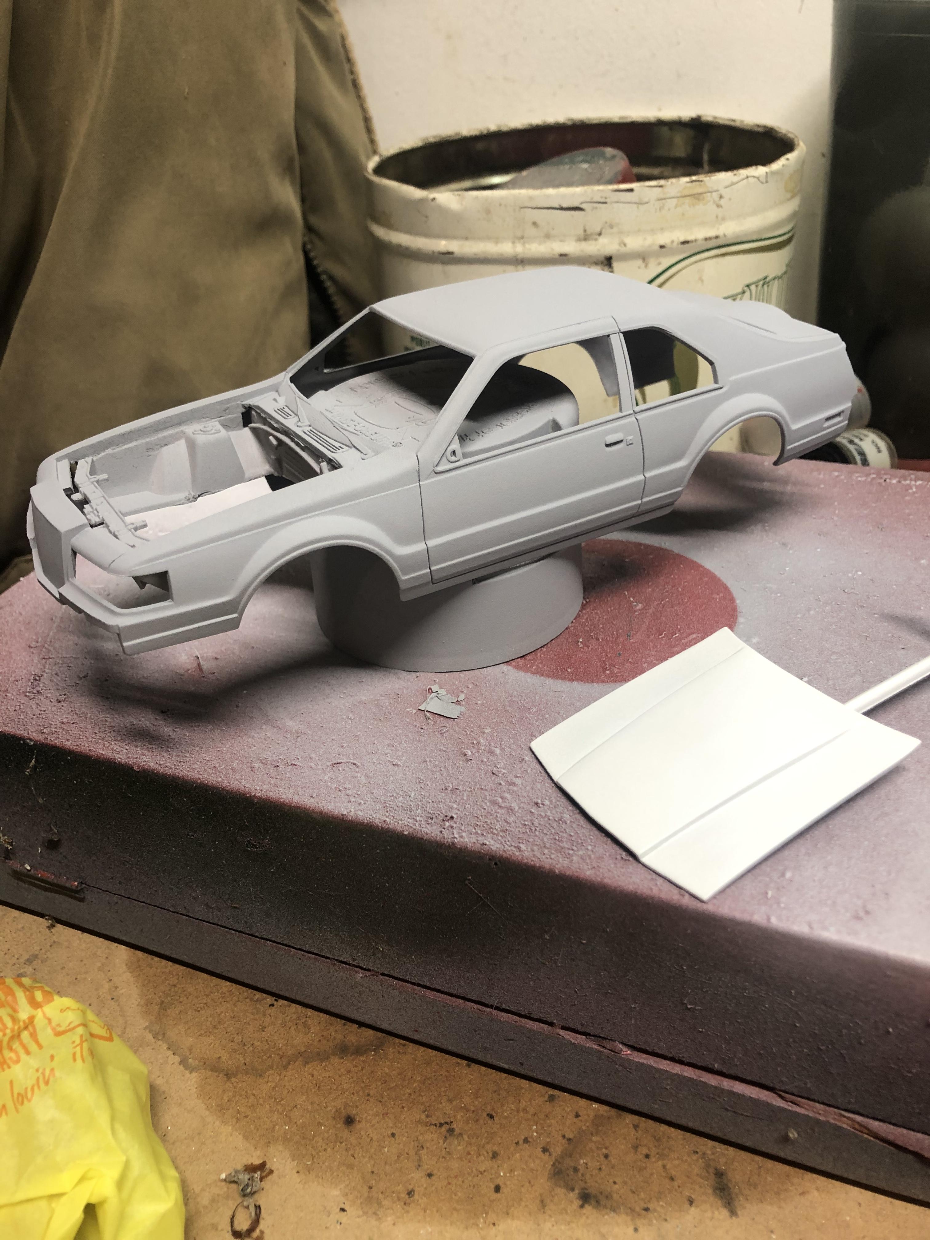

reshaped the Hot Rod scooped hood to a stock style. Also extended the rockers and reshaped them. Originally the rockers are too flat and straight even if all I did was cut out the side exit exhaust. Also filled in the incorrect body line on the lower front fenders between the door and wheel arch.

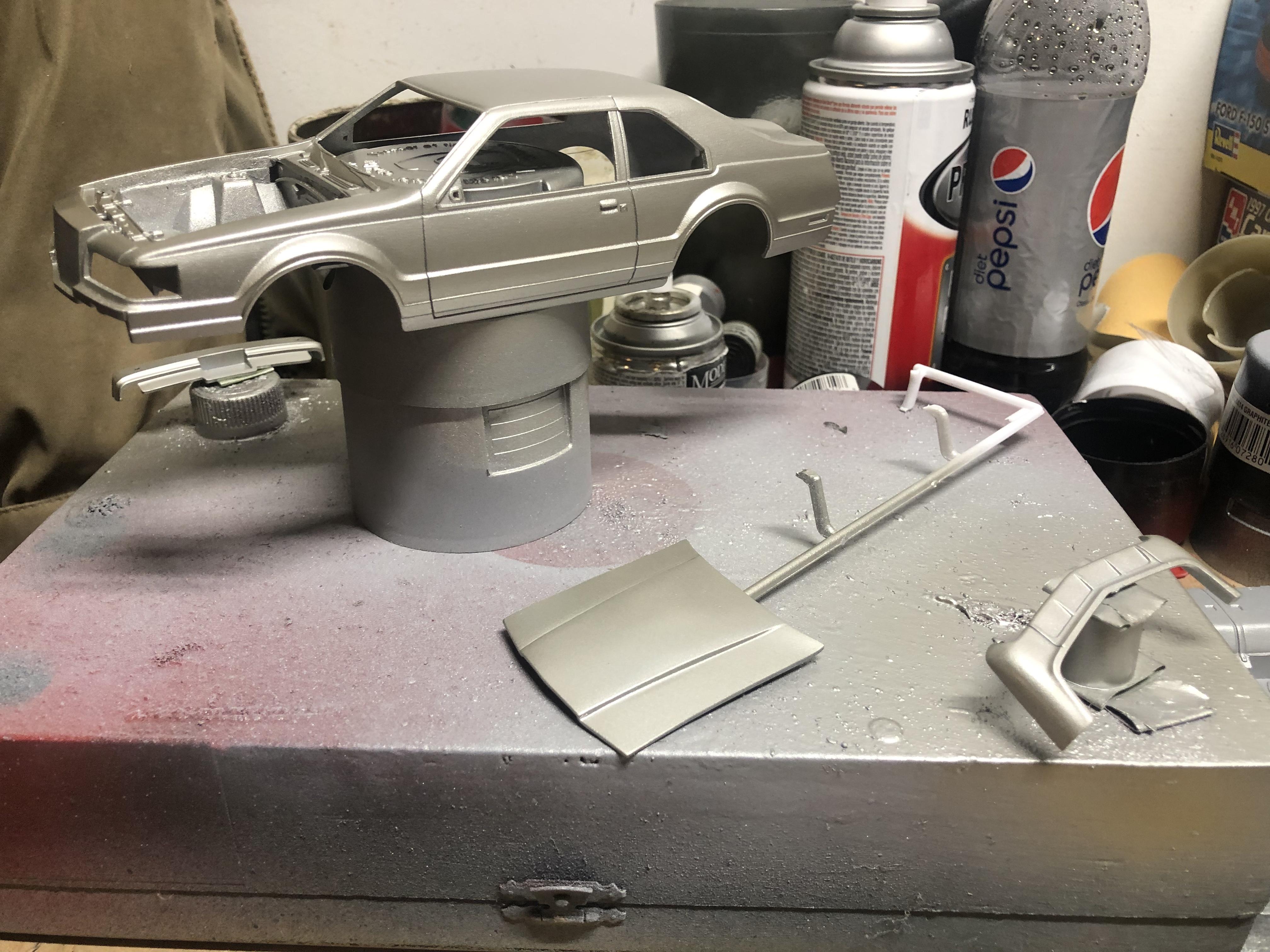

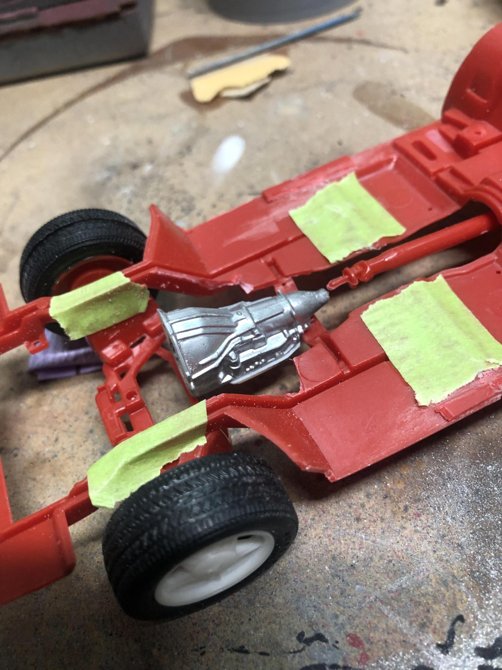

Thanks for the compliments, Didnt make much progress today. Laid down some primer and base coat. Color is going to be Tamiya TS-88 Titanium Silver. Also test fit the automatic transmission

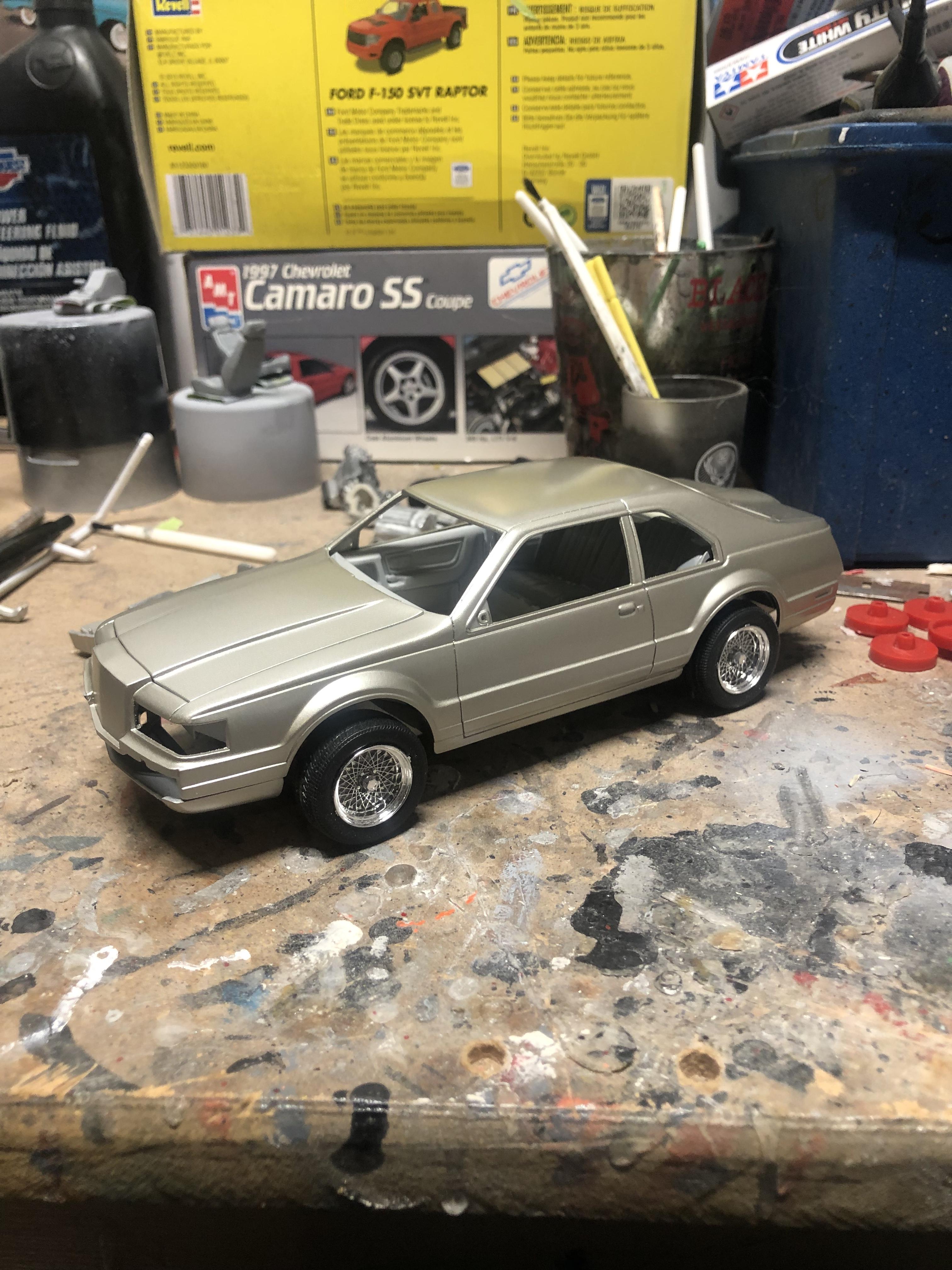

Been awhile since I’ve updated, because I haven’t done much with it. Been sitting idle on the bench. Decided to throw together what I had. Still have a lot of work to modify the track width and ride height using the Thunderbird suspension bits.

Mustang floor (white), Thunderbird chassis with visual underside floor pans and rear half (red)

did some detailing to the Windsor. Had to do more parts rummaging, distributor/boot from an sn95 5.0 Mustang kit, also had to modify the serpentine system as the Mustang drag racer kit doesn’t have AC, so clutch and compressor from a 90s Cougar 5.0
