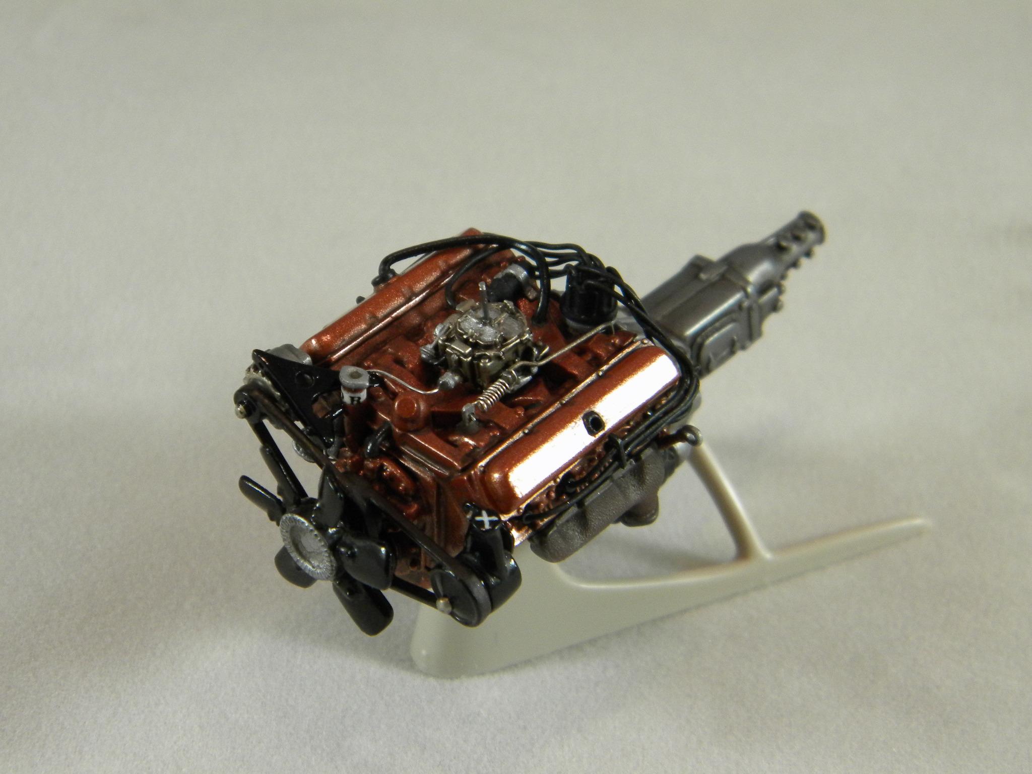

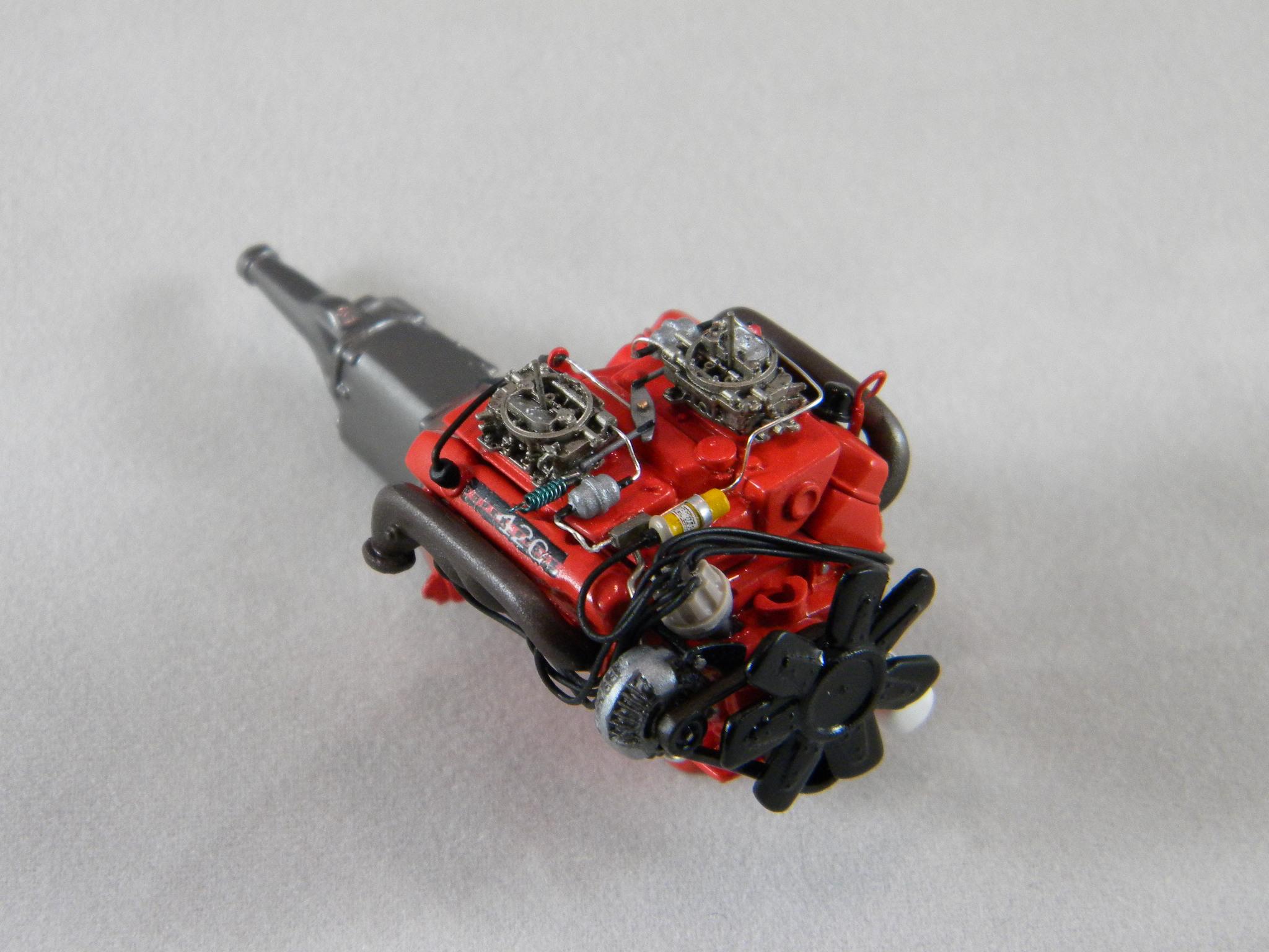

StevenGuthmiller Posted February 10, 2021 Posted February 10, 2021 (edited) With Alclad paints, I usually mix one of the many aluminum shades with a little bit of "Pale Gold" for carburetors. Although I recently bought some Alclad "Pale Burnt Metal" that should be a very good option for carbs. Here are a couple with the aluminum/pale gold mix. This is the "pale burnt metal" that I'll try on my next project. Steve Edited February 10, 2021 by StevenGuthmiller 1
Dan Hay Posted February 10, 2021 Author Posted February 10, 2021 24 minutes ago, StevenGuthmiller said: With Alclad paints, I usually mix one of the many aluminum shades with a little bit of "Pale Gold" for carburetors. Although I recently bought some Alclad "Pale Burnt Metal" that should be a very good option for carbs. Here are a couple with the aluminum/pale gold mix. This is the "pale burnt metal" that I'll try on my next project. Steve Holy Moly! That carb color is perfect! Nice detailing job!
StevenGuthmiller Posted February 10, 2021 Posted February 10, 2021 3 hours ago, Dan Hay said: Holy Moly! That carb color is perfect! Nice detailing job! Detailing carbs is a lot easier when you're starting with Chief Joseph's carbs! Steve
