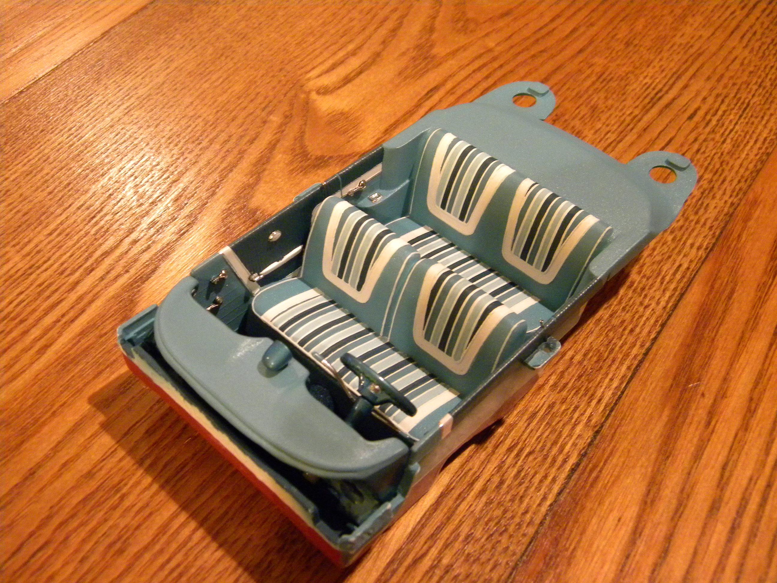

StevenGuthmiller Posted February 13, 2021 Posted February 13, 2021 I agree with the others. You're opening yourself up for all sorts of problems using regular masking tape. I use Tamiya tape for the edges and then mask the rest of the body with masking paper. I've found from many years of experience that it's best to not let any garden variety tapes of any kind touch my painted surfaces. You can get perfect edges with Tamiya, so why risk all of the bleed under and paint lift that you can get with masking tape. Thin strips of Tamiya tape makes effects like this '61 Buick interior relatively easy. Steve
TransAmMike Posted February 13, 2021 Posted February 13, 2021 Wow Steve, thats a lot of stripes on those seats. After reading this, I guess it's time to get the Tamiya.
StevenGuthmiller Posted February 13, 2021 Posted February 13, 2021 2 hours ago, TransAmMike said: Wow Steve, thats a lot of stripes on those seats. After reading this, I guess it's time to get the Tamiya. That's part of the reason why I love American cars from this era. Back when interiors had some character instead of just monotone gray. Steve
TransAmMike Posted February 13, 2021 Posted February 13, 2021 Just now, StevenGuthmiller said: That's part of the reason why I love American cars from this era. Back when interiors had some character instead of just monotone gray. Steve I especially loved the big Pontiac interiors.
