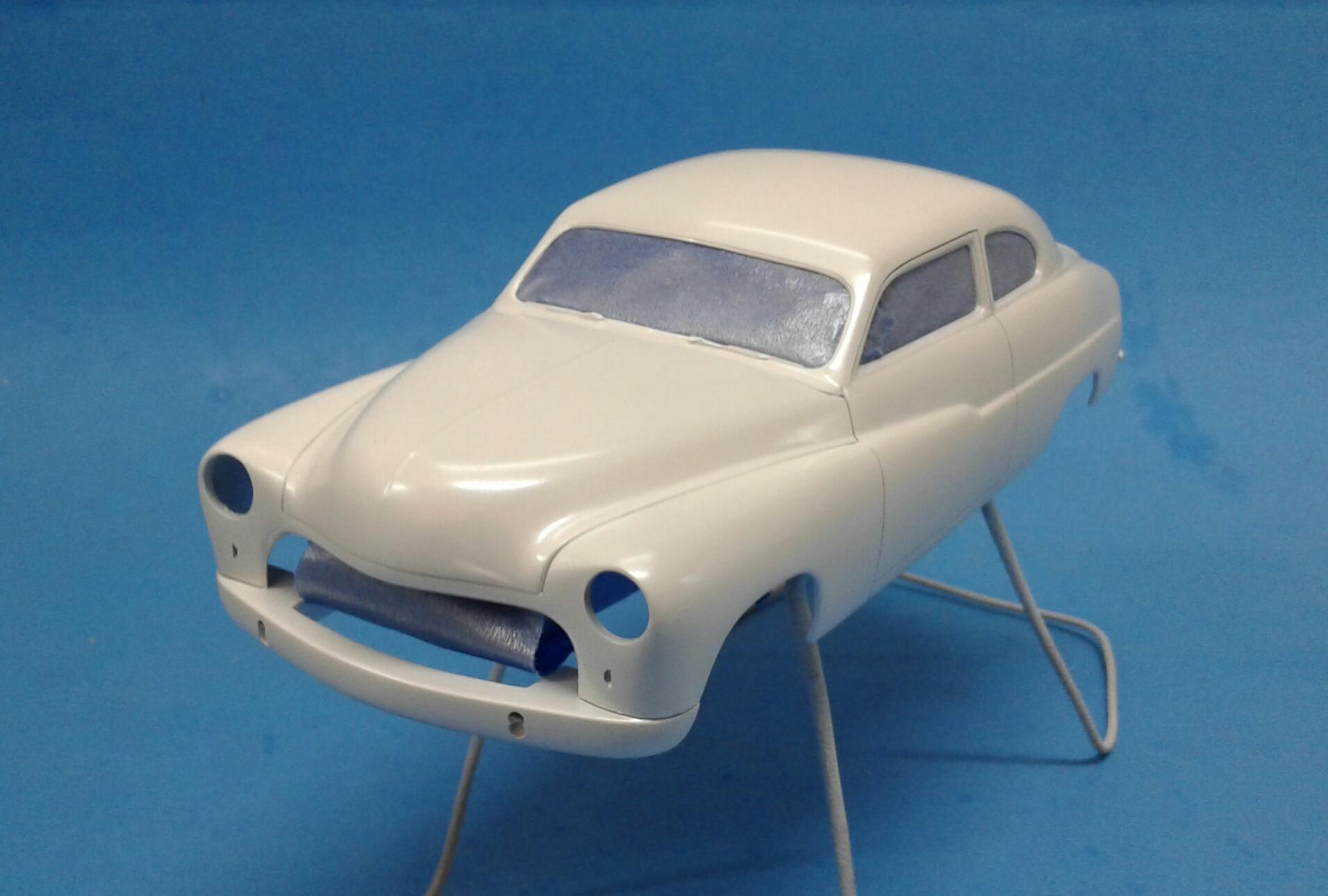

Plowboy Posted February 17, 2021 Posted February 17, 2021 One coat of Pearl White is all you'll need over a good white base color. Then you can add clear. This is one coat over white. Even though I painted it all together, the hood and trunk were off a shade. You can see how transparent the Pearl White is by the tape in the windows.

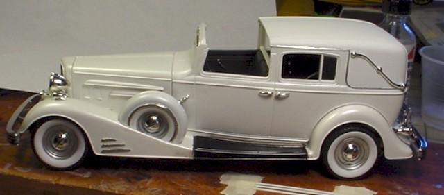

Dave Van Posted February 17, 2021 Posted February 17, 2021 (edited) The pearl over Tamiya white primer....... I taped off the roof and left it. I like it. Edited February 17, 2021 by Dave Van

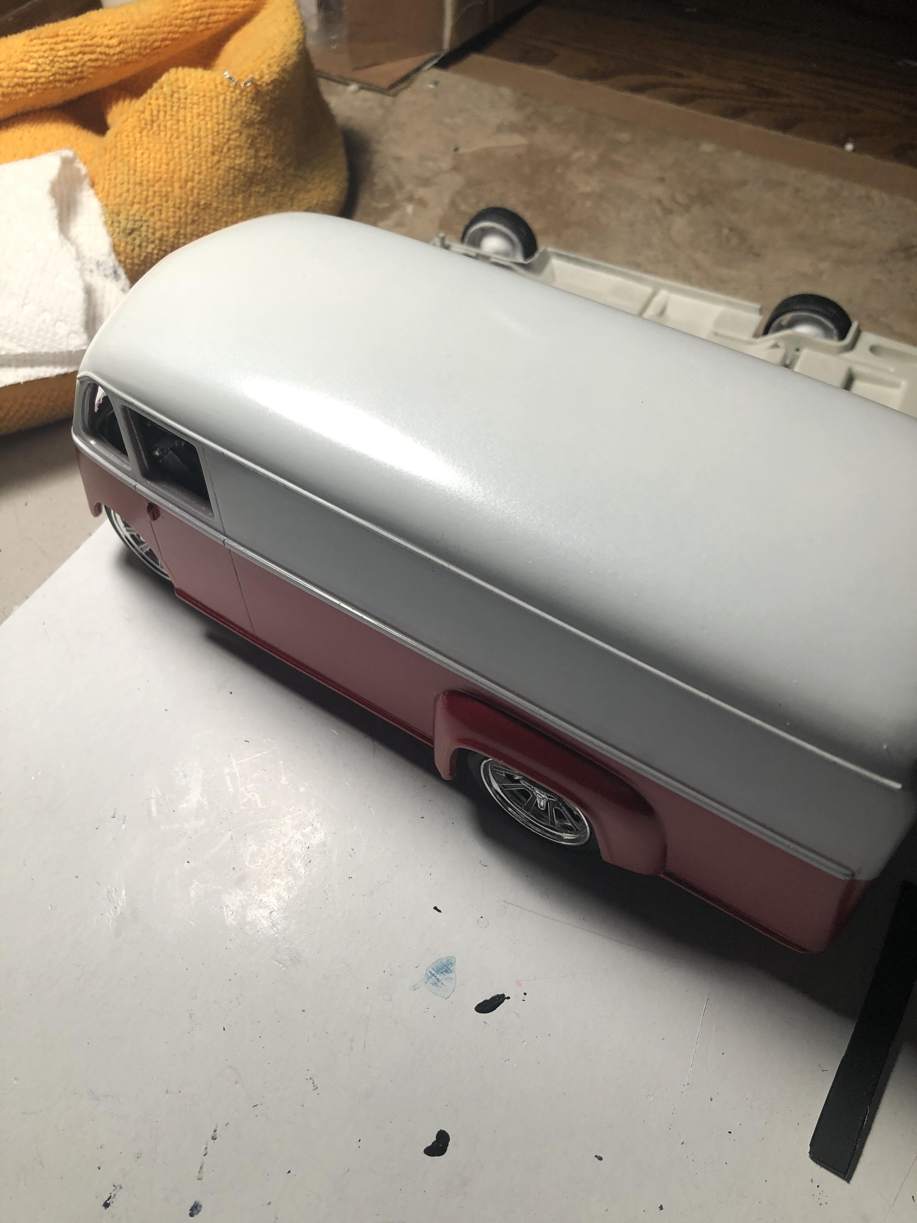

cobraman Posted February 19, 2021 Posted February 19, 2021 Funny you mention that color . I just finished painting the top section of this truck with it . First I primed with Duplicolor white primer then the Tamiya followed by 3 coats of Tamiya clear . Has not been polished .

Dave72 Posted February 20, 2021 Posted February 20, 2021 2 hours ago, cobraman said: Funny you mention that color . I just finished painting the top section of this truck with it . First I primed with Duplicolor white primer then the Tamiya followed by 3 coats of Tamiya clear . Has not been polished . Nice looking build Ray! Paint looks amazing. What are those wheels from?
cobraman Posted February 20, 2021 Posted February 20, 2021 Those wheels are by Acme and I bought them on the bay.
