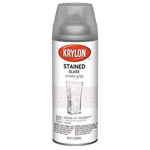

Venom Posted February 22, 2021 Posted February 22, 2021 I saw a YouTube vid where a girl tinted her plastic glasses lenses with this stuff and by the looks of them I think it might do great on model car windows

64SS350 Posted February 22, 2021 Posted February 22, 2021 8 hours ago, Venom said: I saw a YouTube vid where a girl tinted her plastic glasses lenses with this stuff and by the looks of them I think it might do great on model car windows I have used this on the Flintstone Flyers, it doesn't do bad. You must be careful, even coat(s) are a MUST, as it is translucent. Takes awhile to dry, and make SURE there is no dust or debris, it will show. Material stays on top like paint, doesn't soak in like a dye.
