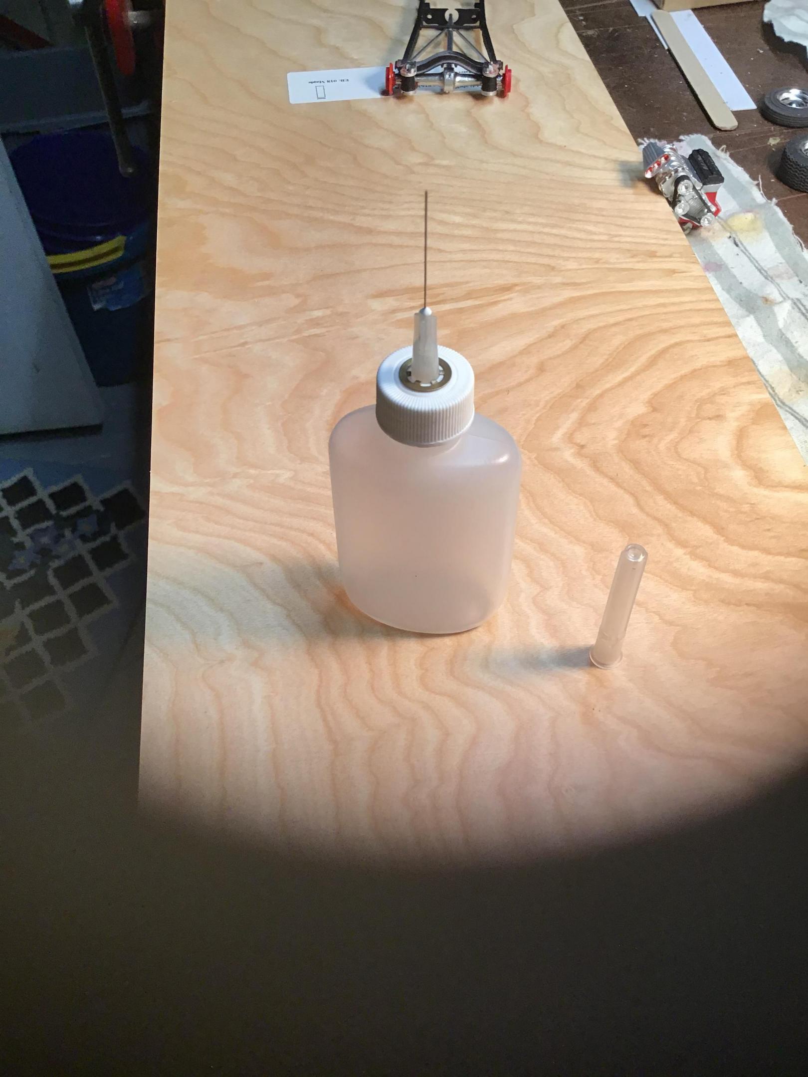

Rick L Posted February 27, 2021 Author Share Posted February 27, 2021 On 2/24/2021 at 9:31 PM, Rodent said: I have issues with the various liquid glues on two piece engine/transmission halves. If I use CA, I wind up with an engine glued to my finger. If I use Tamiya or the other brush-on glues, it dries before I have the entire surface covered. I like the thicker solvent glues for those applications because it helps with hiding the seam. The best way in my humble opinion is to pour some Tamiya extra thin cement into a precision needle-tip squeeze bottle. These bottles use stainless steel luer lock needles that control the flow of the solvent without getting it all over the place. I prefer the oval shape bottle so it won’t roll off the workbench and a .007 I’d. Aperture. The bottle can be purchased through McMaster Carr for $5.00. and needles can be purchased for $4.00. Quote Link to comment Share on other sites More sharing options...
NOBLNG Posted February 27, 2021 Share Posted February 27, 2021 33 minutes ago, Rick L said: The best way in my humble opinion is to pour some Tamiya extra thin cement into a precision needle-tip squeeze bottle. These bottles use stainless steel luer lock needles that control the flow of the solvent without getting it all over the place. I prefer the oval shape bottle so it won’t roll off the workbench and a .007 I’d. Aperture. The bottle can be purchased through McMaster Carr for $5.00. and needles can be purchased for $4.00. Too bad that wouldn’t work for the thin CA. ? Quote Link to comment Share on other sites More sharing options...
