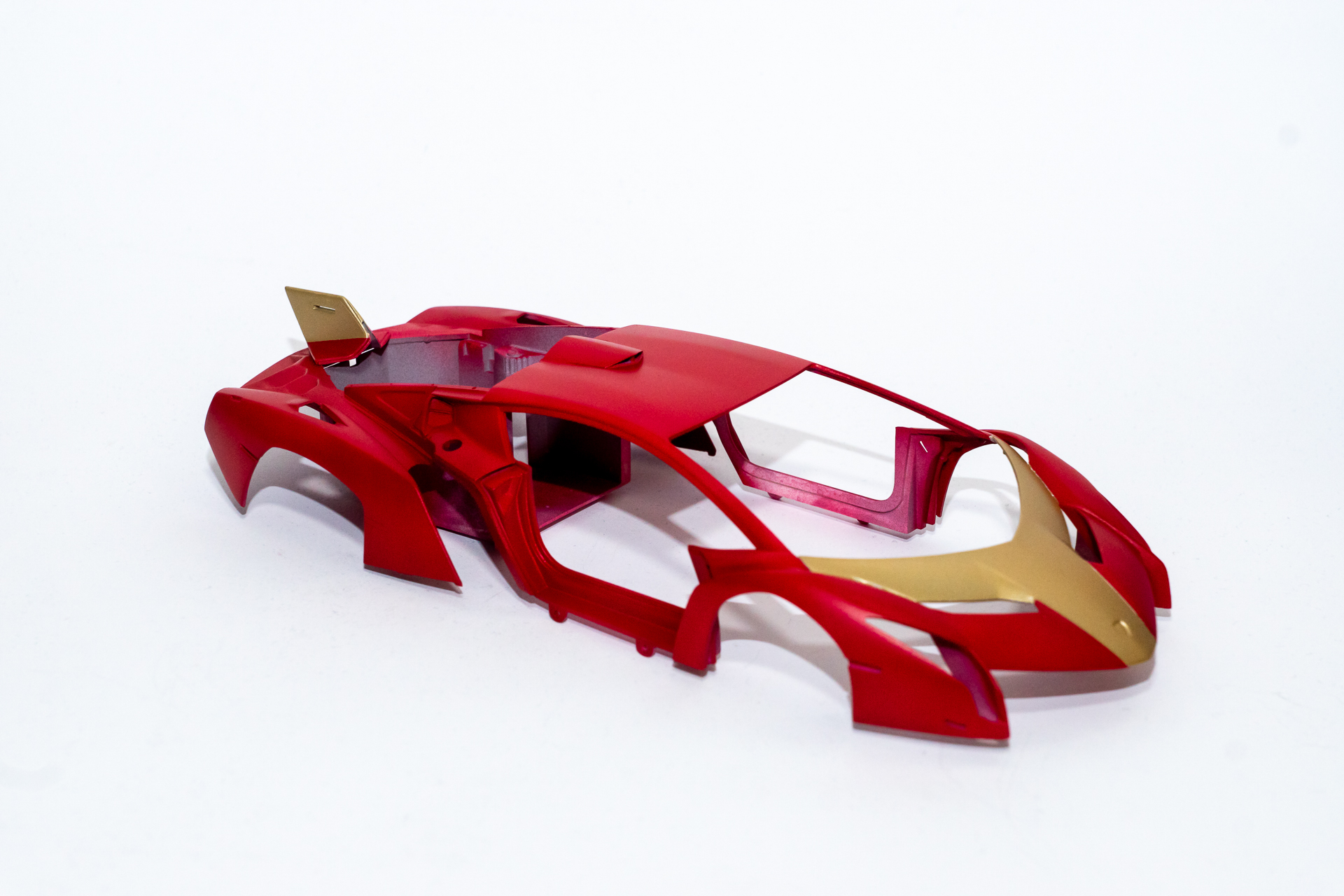

It's been quite a while since I opened this WIP. Unfortunately there is still not too much progress to show you. In the last few weeks I painted the body, stripped the paint because I noticed some scratches in the body I didn't see beforehand. The main part of my building time was eaten up by making stencils for the carbon decals, cutting the decals out and applying them.
But let me show you the progress I made so far:

Today all body carbon parts have received their clearcoat (Zero Paints' 2K Semi Gloss Clear). Representative for this I'll show you one of the side skirts
Finally the body has been repainted but not yet clear coated. After clearcoatig I will add some semi-gloss black in the area right behind the doors below the sharp bend.
Tony Stark would be into this for sure!
Looking good so far!

On 5/11/2021 at 10:12 PM, Codi said:
Love that red.  Good luck with the clear too.   cheers, tim
Thank you. The clear will still have to wait for a while until I'm finished with the preparation of all the body parts.
Thank you. I hope to do Tony Stark justice with the build of this Lambo. Initially the idea for this painting came up about one year ago when my son was in his Ironman-phase :D
