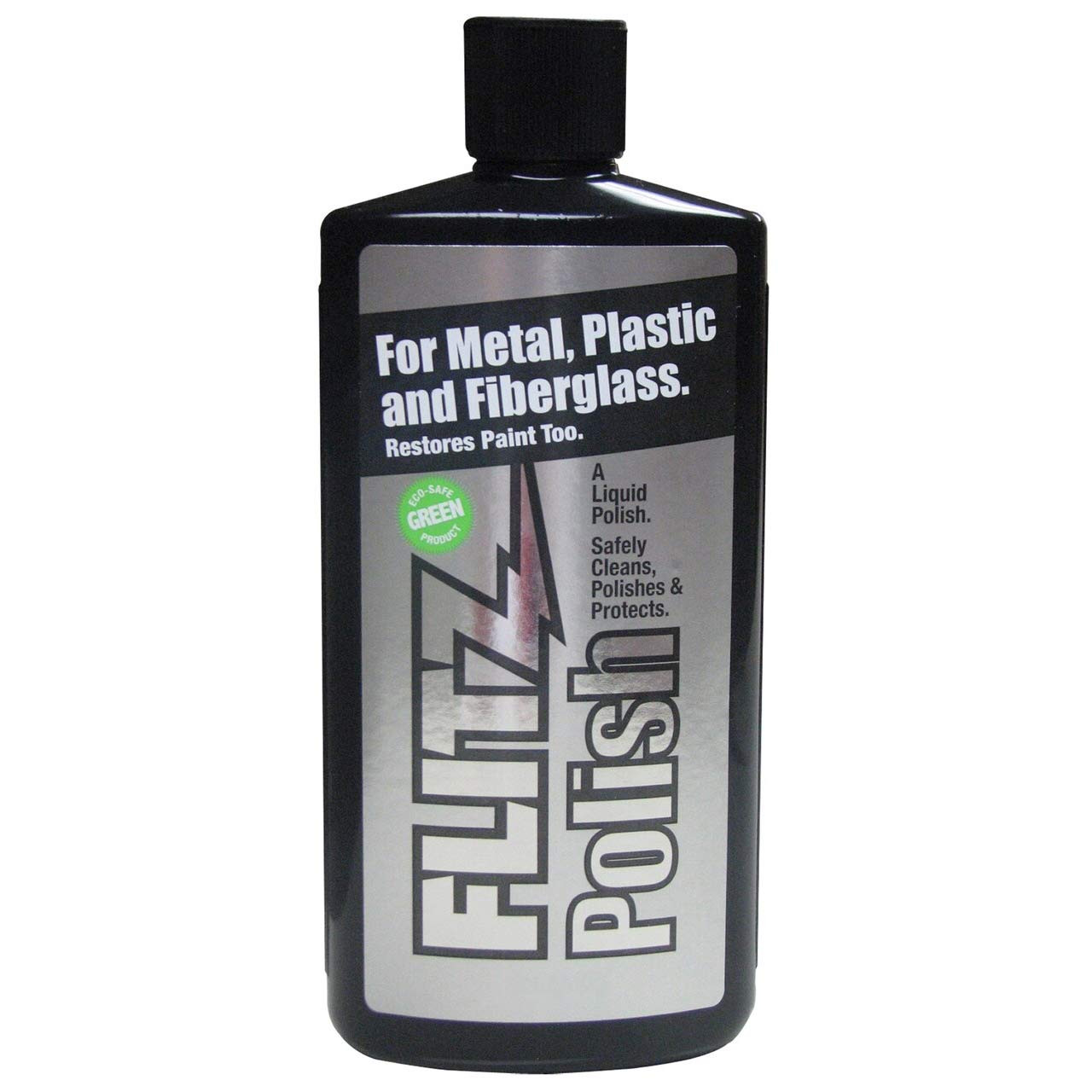

Vietnam Vet67 Posted March 17, 2021 Posted March 17, 2021 I have been using this recently and it is great............even works on paint. $8.95 on Amazon

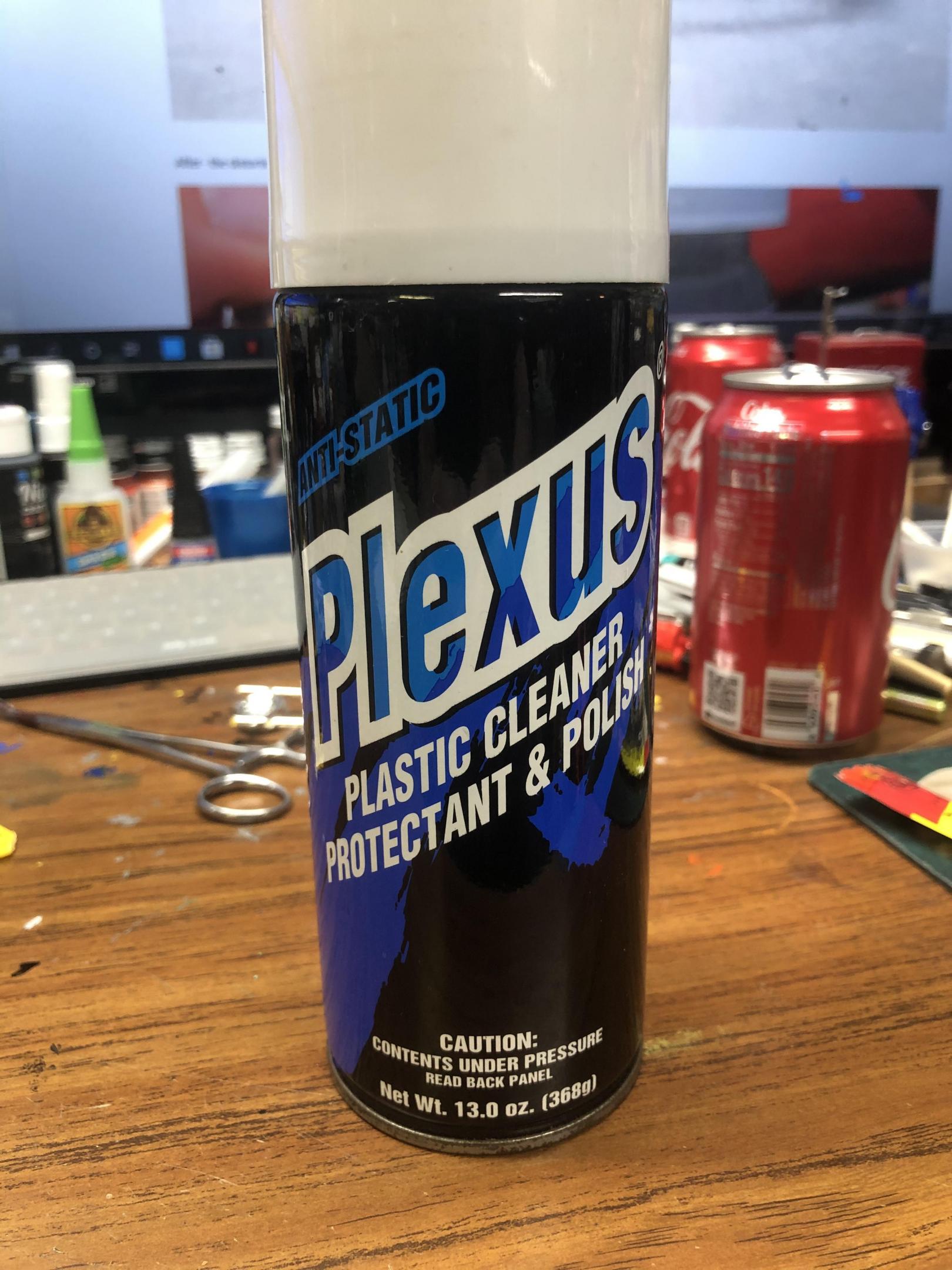

SCRWDRVR Posted March 19, 2021 Posted March 19, 2021 I use this on fine scratches and on my cases. Works great, I found it a while back looking for something for the windshield on my motorcycle.
