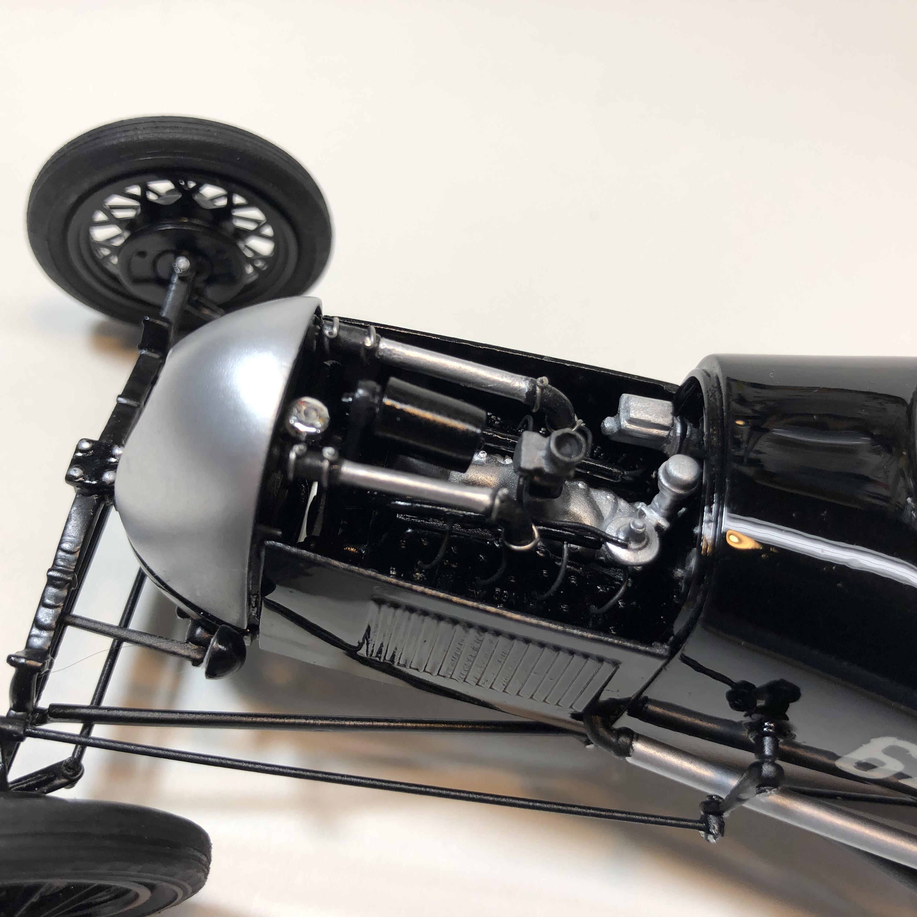

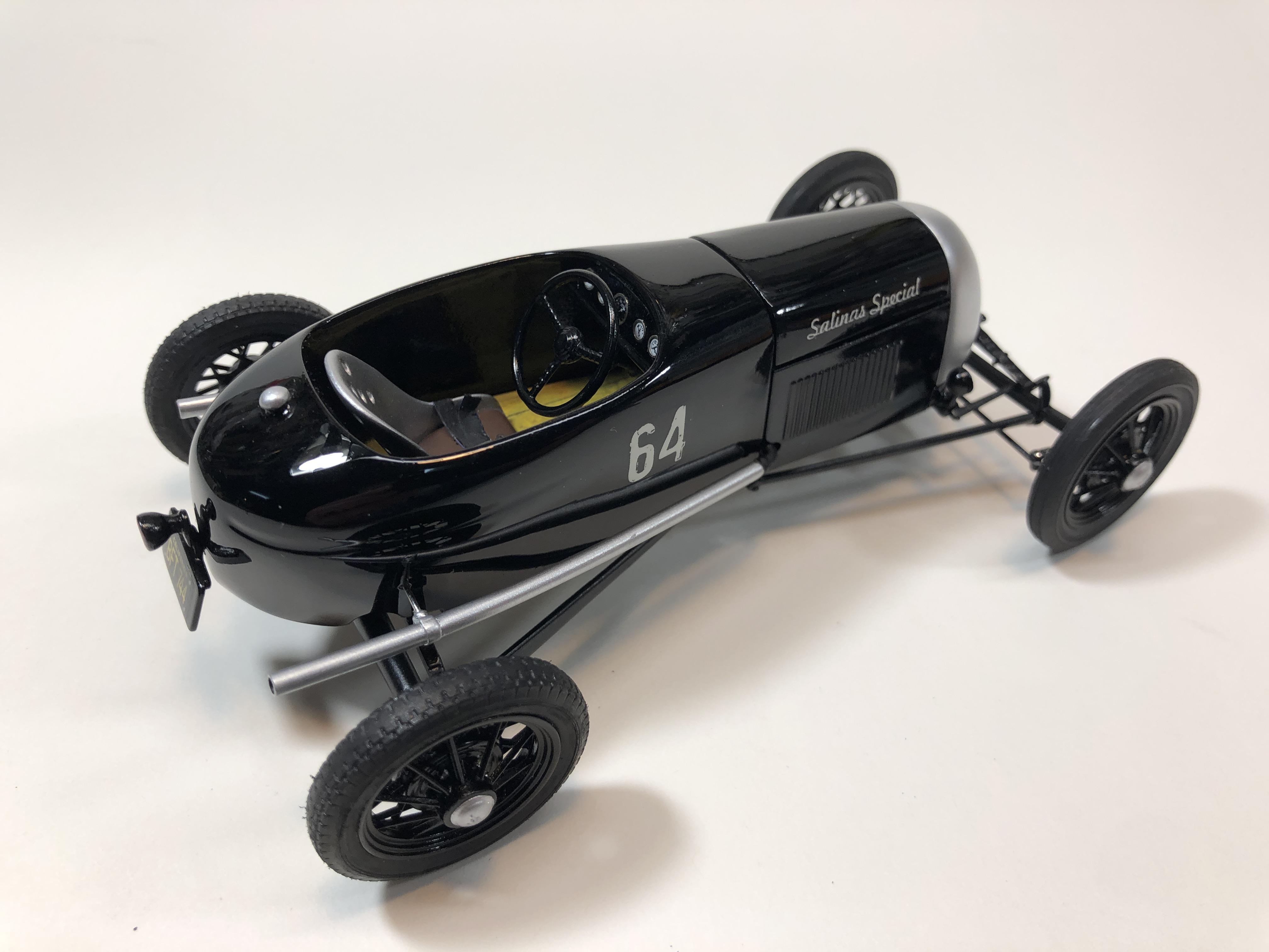

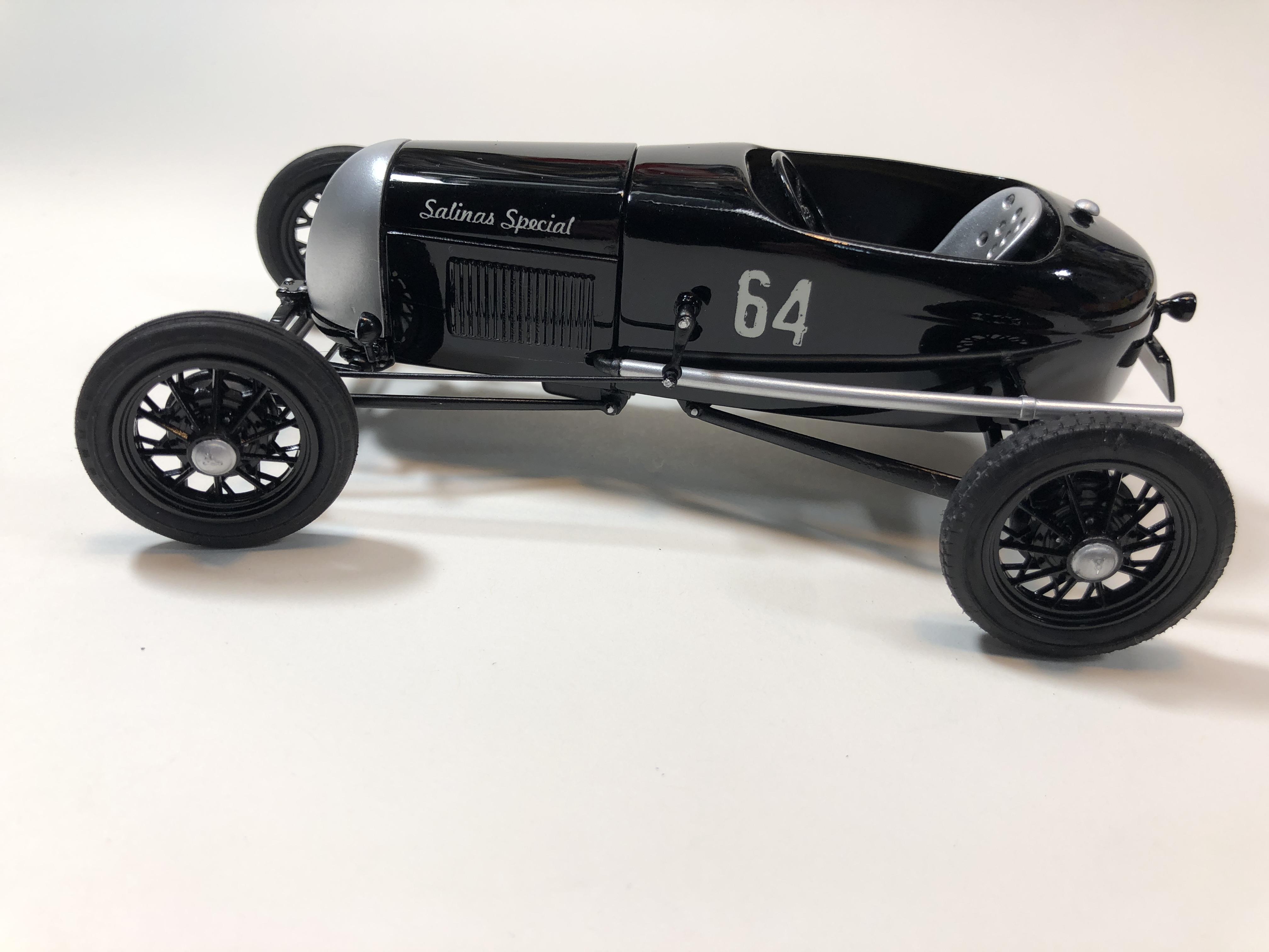

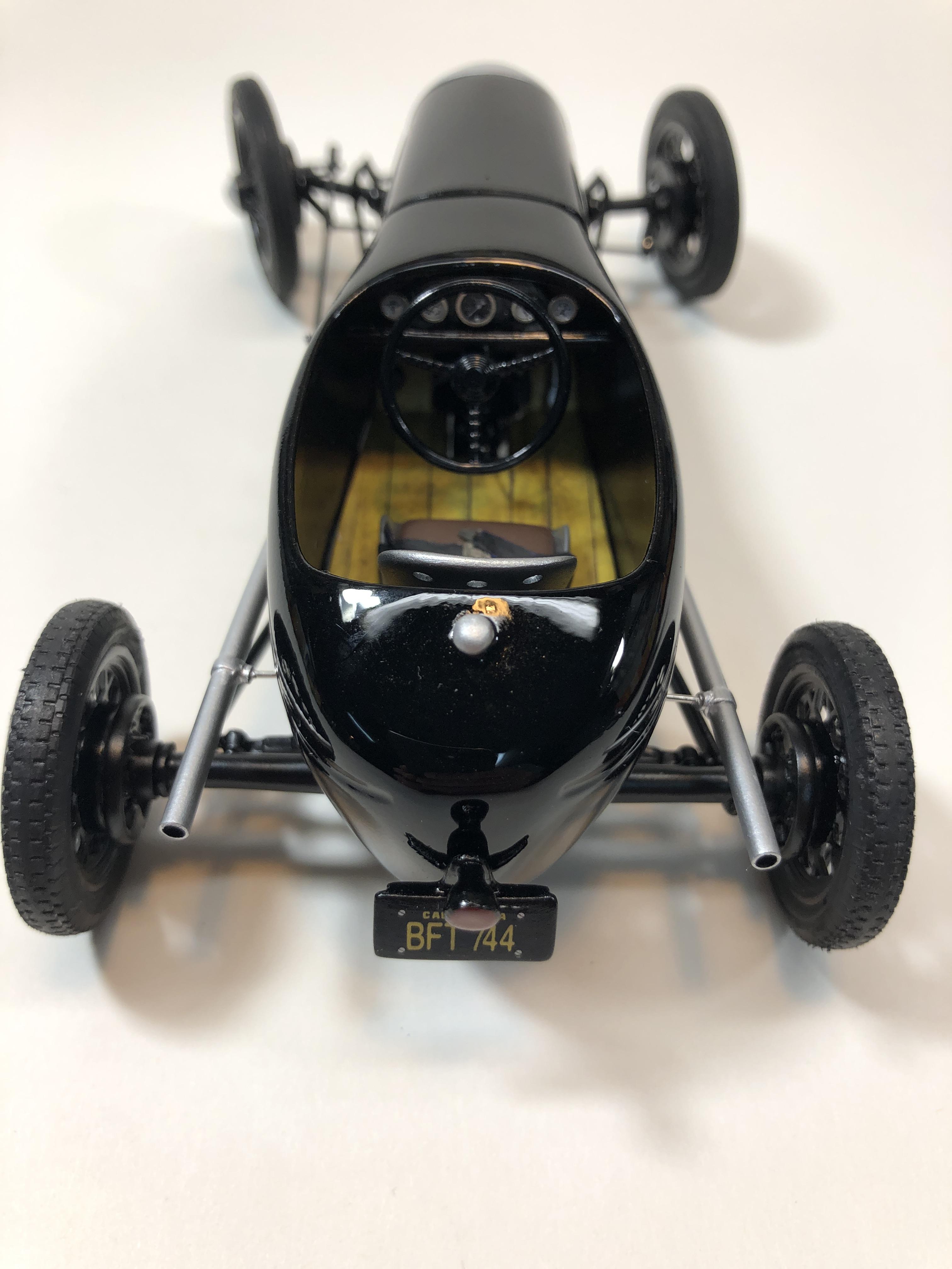

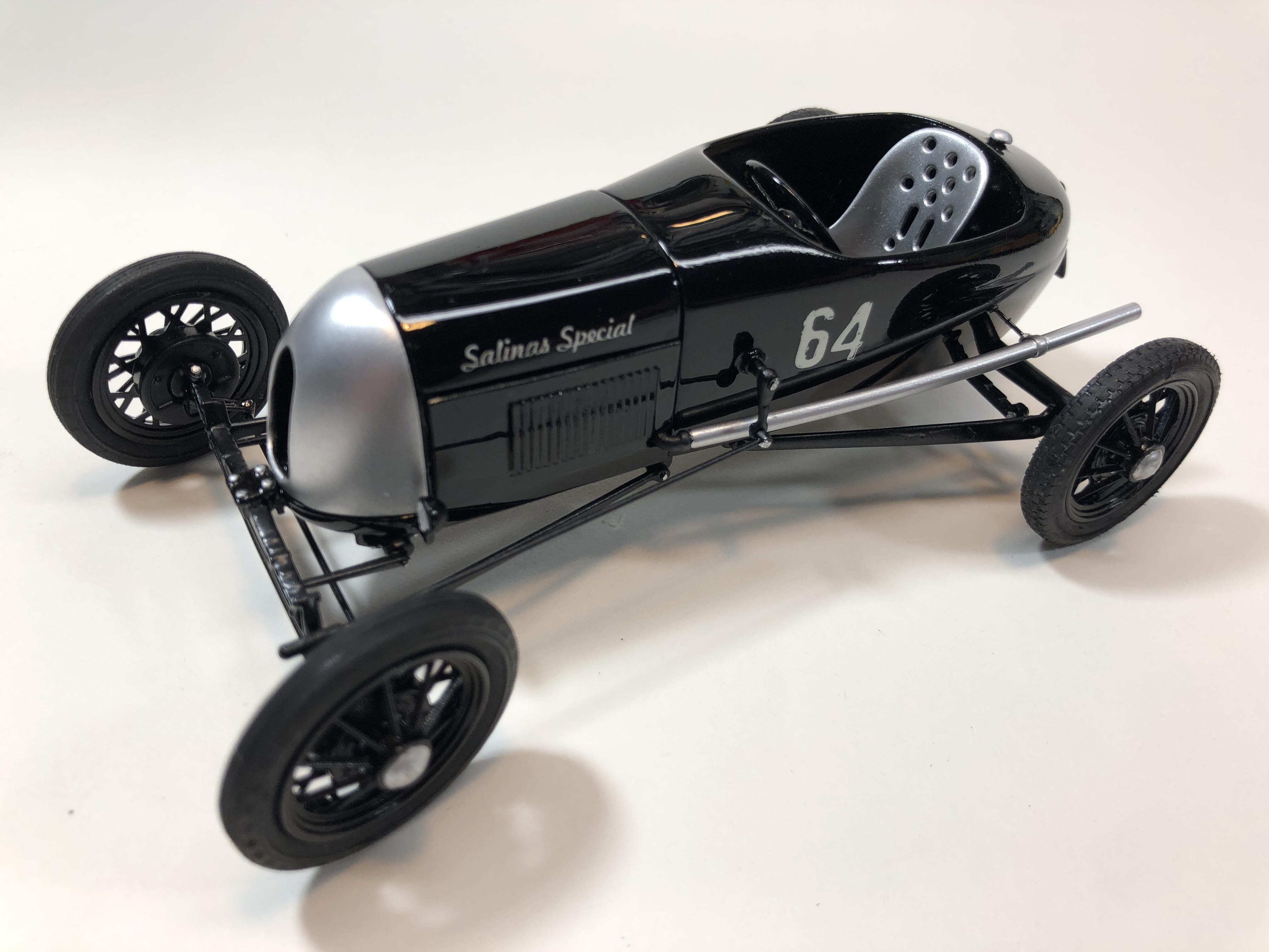

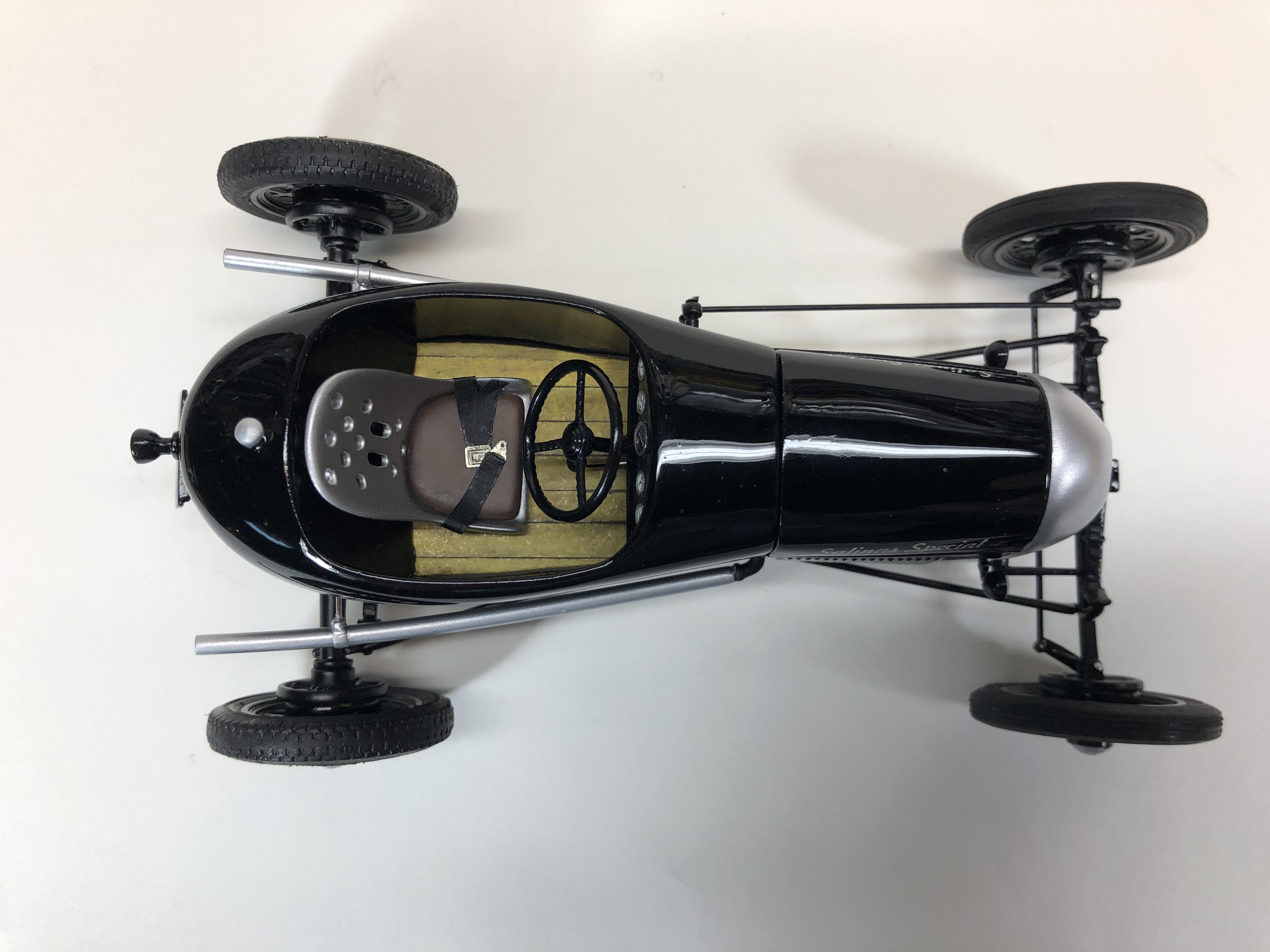

Rocking Rodney Rat Posted February 27, 2021 Posted February 27, 2021 Here's a little track modified based on a Model T platform with a custom built body. -Body made from the cowl of a 1932 Chrysler, one of the MPC 'Gangbuster' series of kits. The cowl was narrowed and shortened. The rest of the body is from the rear fenders of a Revell '48 Ford. Much massaging and filling was done to complete the body. The track nose from the Revell '29 pickup was cut up and resized. -The frame is made from Evergreen styrene rectangles with the rear crossmember from the AMT '25 T kit. -Engine is a flathead from a Revel kit with a single carb intake and stock heads. Transmission is a '39 style from the parts box. -The front axle is from the Revell Model A pickup with a spring from the Monogram ZZ Top '33. Spindles and other components scratch built. The rear end is a banjo from the '48 Ford with a spring from the AMT '25 T kit. -Wheels and rear tires are from the Monogram Model A coupe, front tires from the MPC '32 Chrysler. -Bomber seat from The Parts Box Co. with scratched built cushion. The dash was scratched together with gauges from some decal sheets with photo-etched gauge bezels. -The floorboards are strips of 'wood' decal from a pickup with the metal bed strips sliced off. -headlights (small) and a tail light with a license plate makes it 'street legal" Ha! It would be fun to tool around in though, wouldn't it? -Paint is a combination of gloss, semi-gloss and flat blacks. -Buildup pix and more here: https://public.fotki.com/jferren/single-seater-beach/
