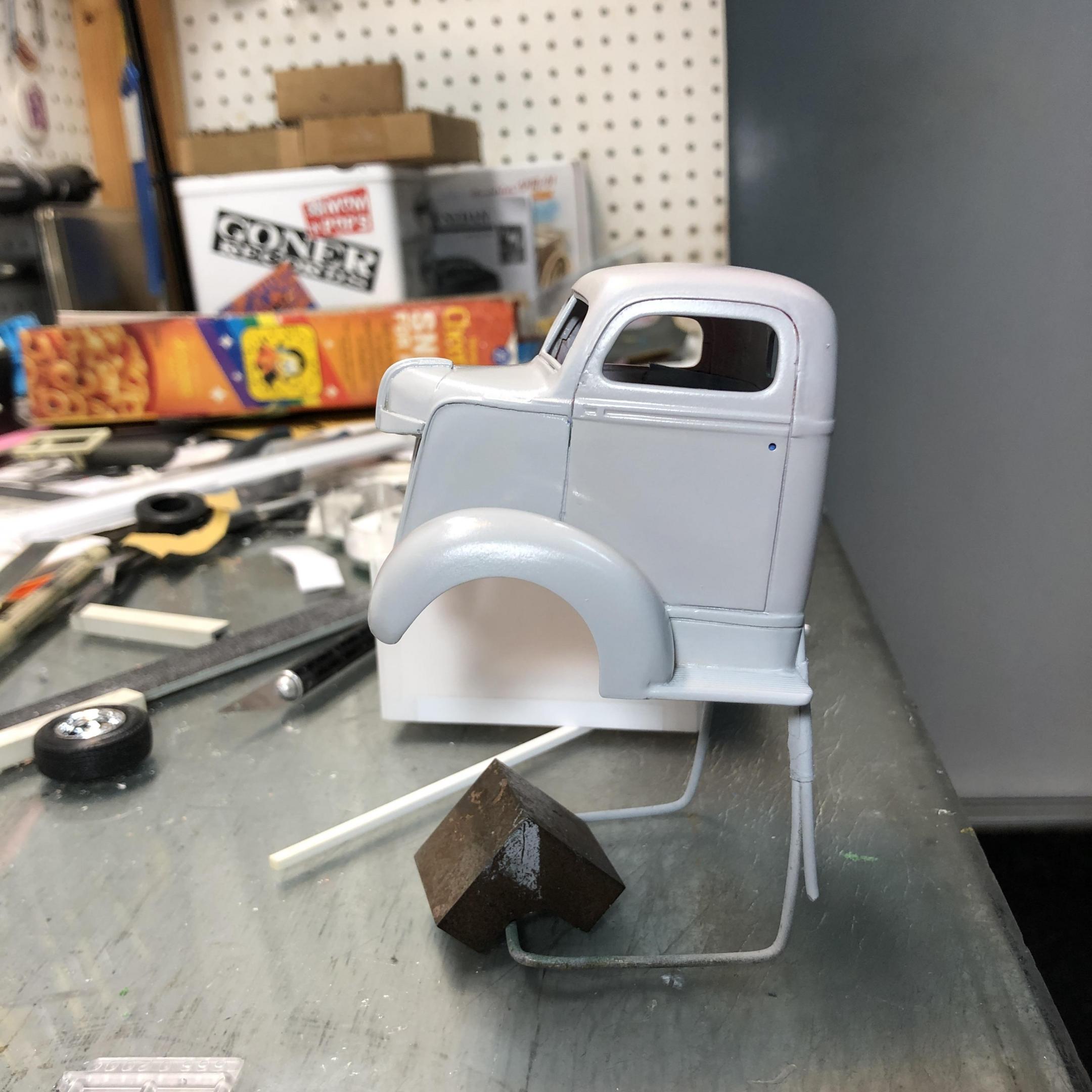

I figured I might build it one day. I started looking at the ramp section of the kit (it also has parts to build a stock pickup truck as well)...while talking with Kit Karson about the kit, he reminded me he had sent me a '41 Ford COE based on a Jimmy Flintstone body that he had started. He had cut off the cab section and replaced it with the cab from a Monogram '40 Ford pickup, while giving the top a slight chop. 188634570_p..thumb.jpg.c0936dffa90b335c507ca3ebcc0ab905.jpg

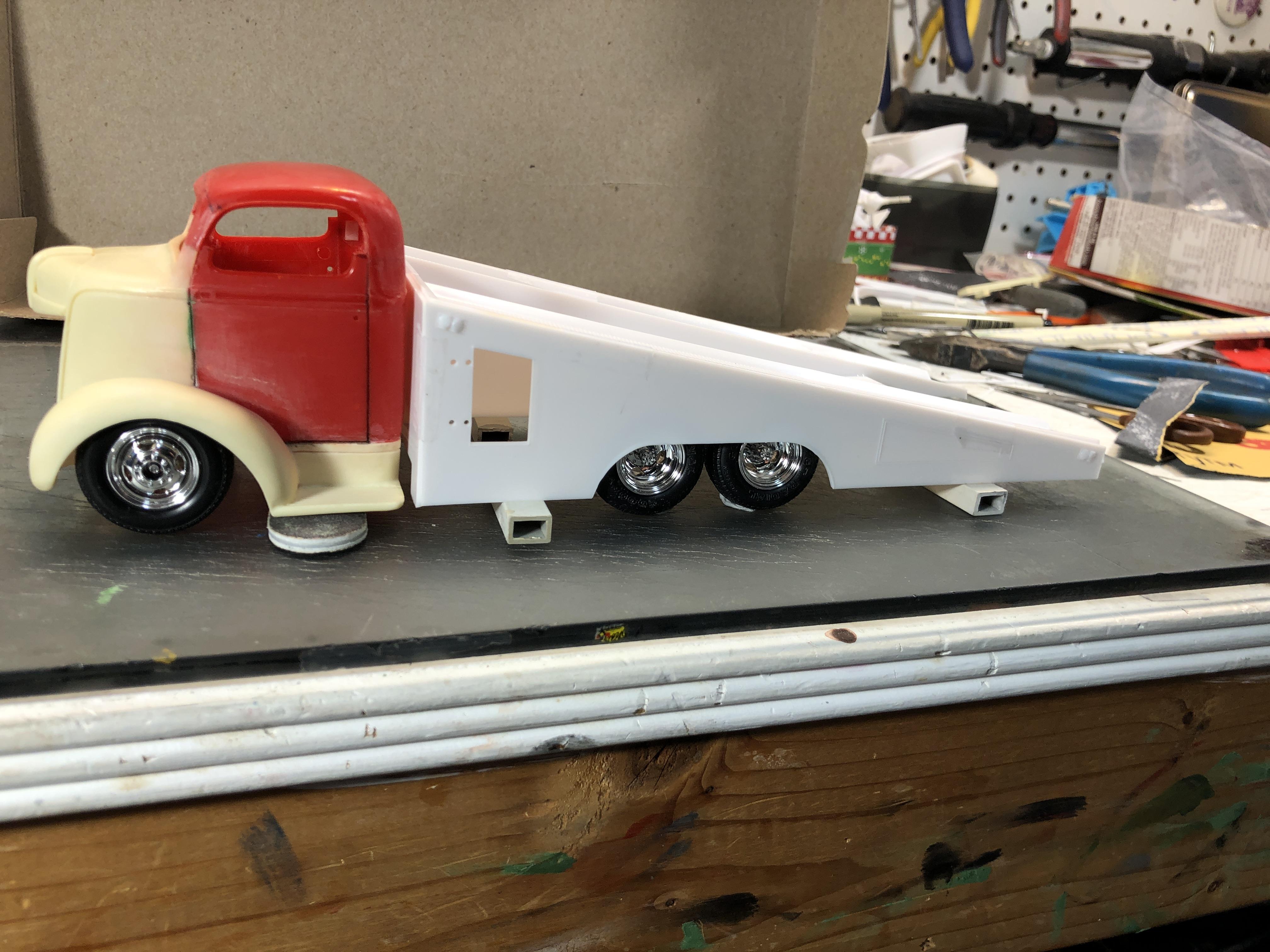

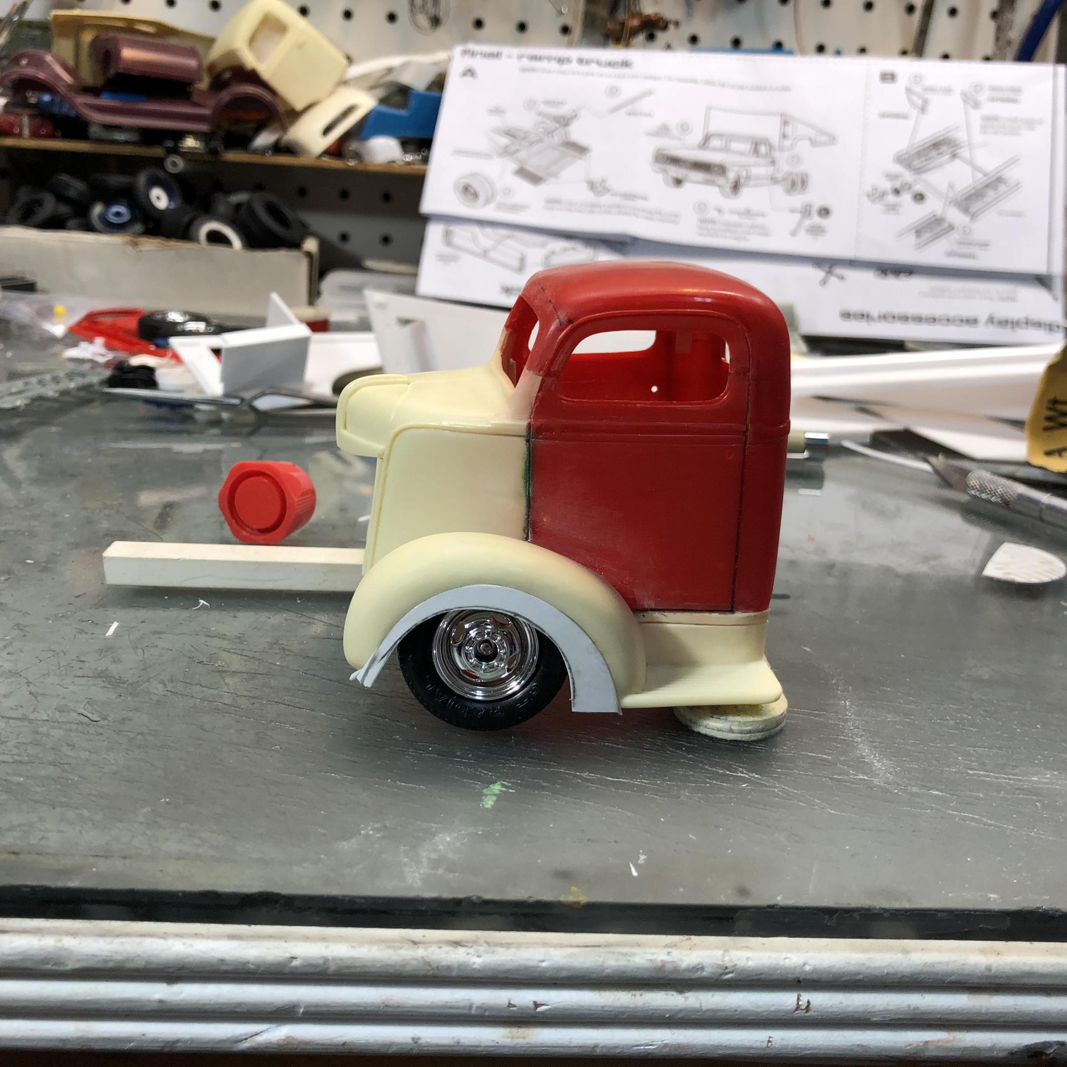

I mocked it up with wheels and tires form the Monogram Ford F350 and well....another project in the works....
Follow along as I attempt to make this look like something.... -RRR (& KK)

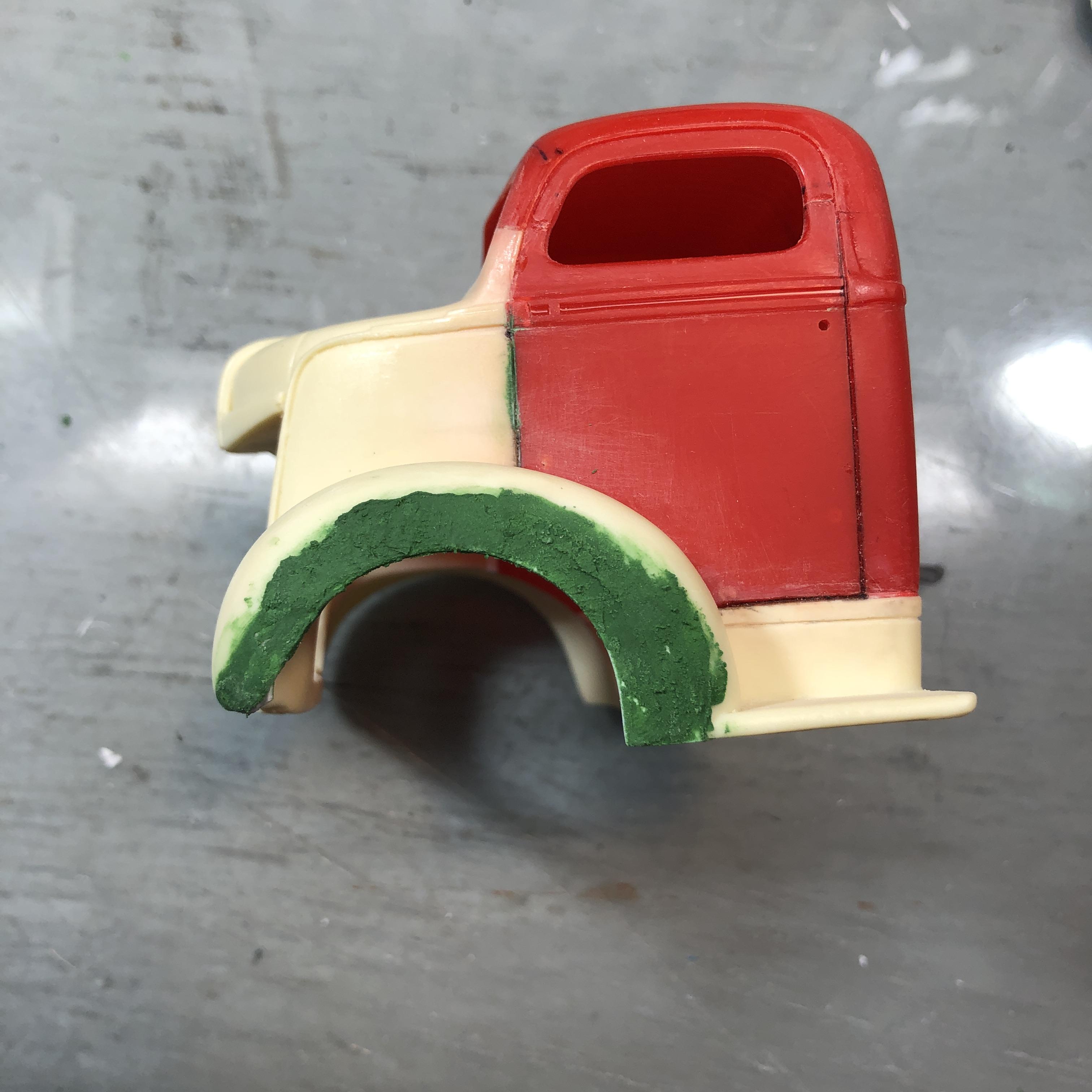

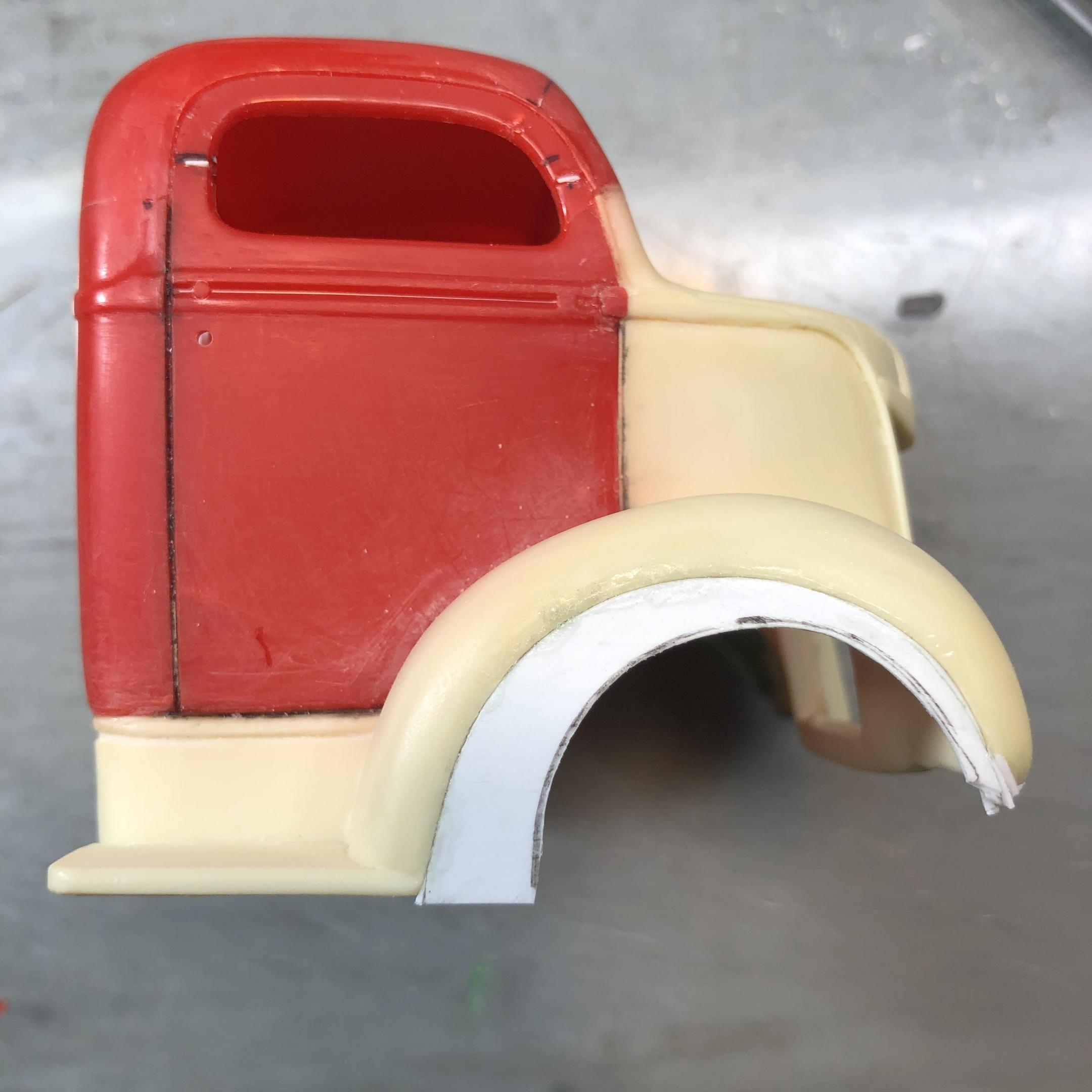

Ok, here's more... I really didn't like the wide open wheel wells, so with a bit of scoring and cutting of styrene, they look a little better, IMHO....
tv8vyvyg.thumb.jpg.cc1c884a7e9ef8e934525b8e554d23a8.jpgy89y9y.thumb.jpg.e59b8a9e52f5c97a62e37e4c94dfc533.jpg79g7tg8ctc.thumb.jpg.3acbde4af90c029d670b31bd83f6c0e8.jpg
after a little sanding and a schmear of putty, it will look a LOT better....more this weekend.... -RRR

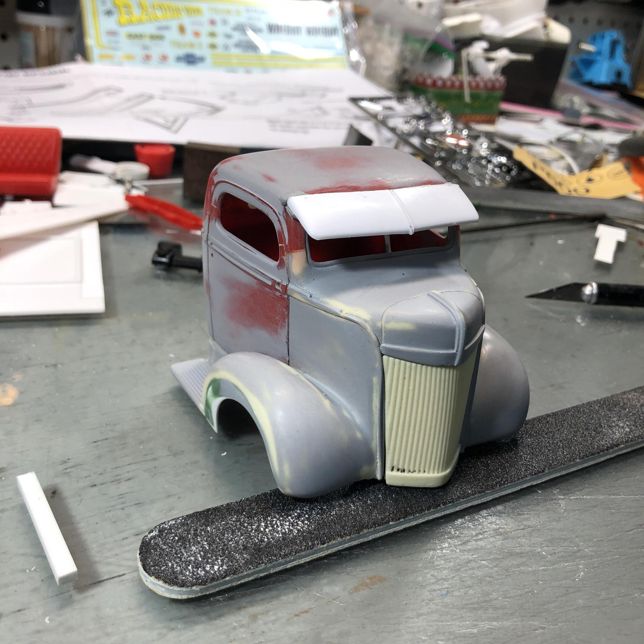

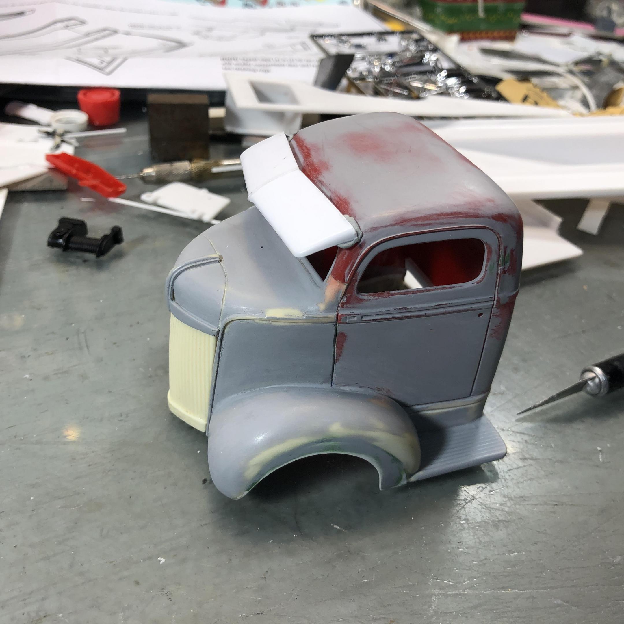

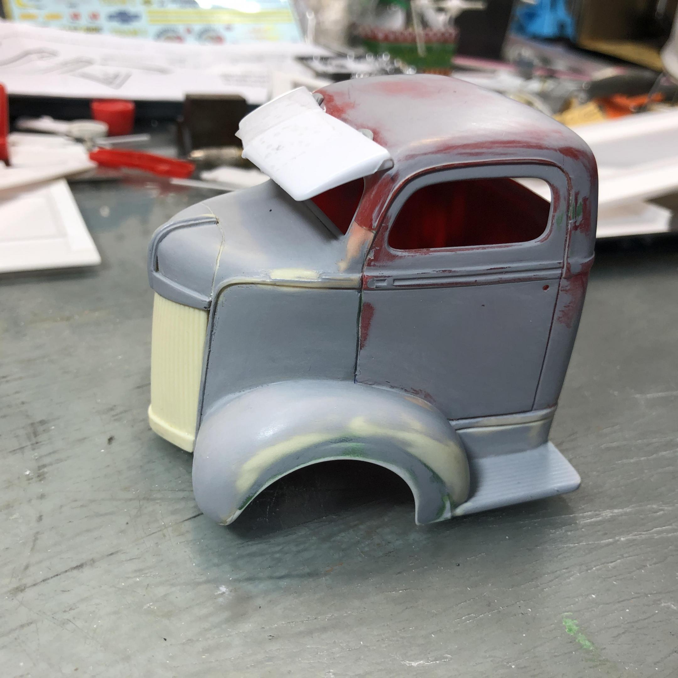

I haven't made much progress on the COE lately. I did shoot a guide coat of primer, there's a few areas to address, but looks pretty good. My paint has arrived..... vsvf.thumb.jpg.407d7bb1fdcbc546b2272635bf203191.jpg
I did start working on a visor from the Revell '49 Mercury woody wagon. I narrowed it and shortened it...more work to be done it still.
way too long....
vafa.thumb.jpg.78399c932e6402932bcf3a2aa005a75d.jpghbuhb.thumb.jpg.822df9e452005c4612c8f0ee35cea8ab.jpg
That's better.....Hopefully more work will progress this weekend..... -RRR

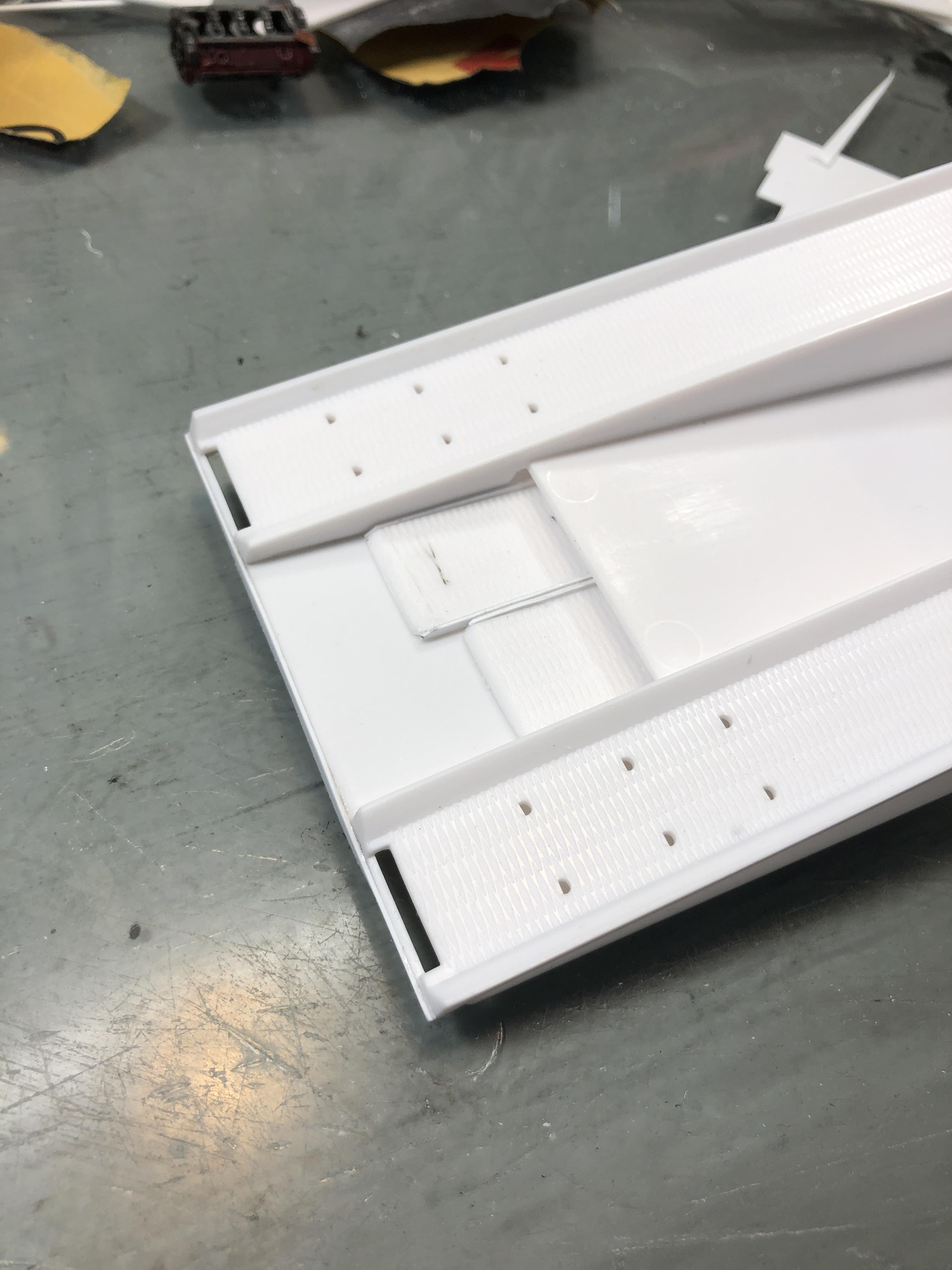

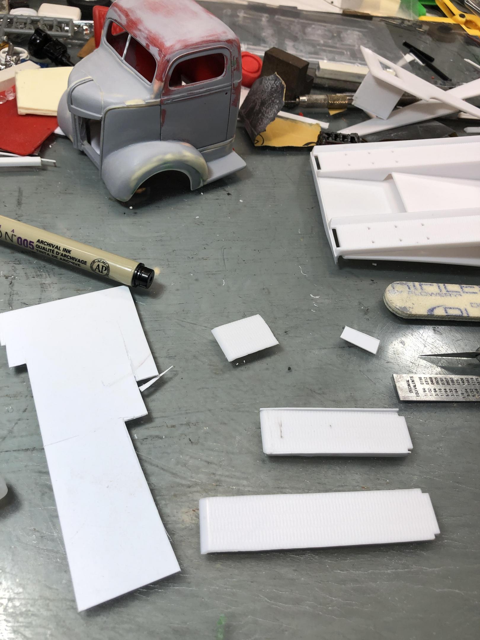

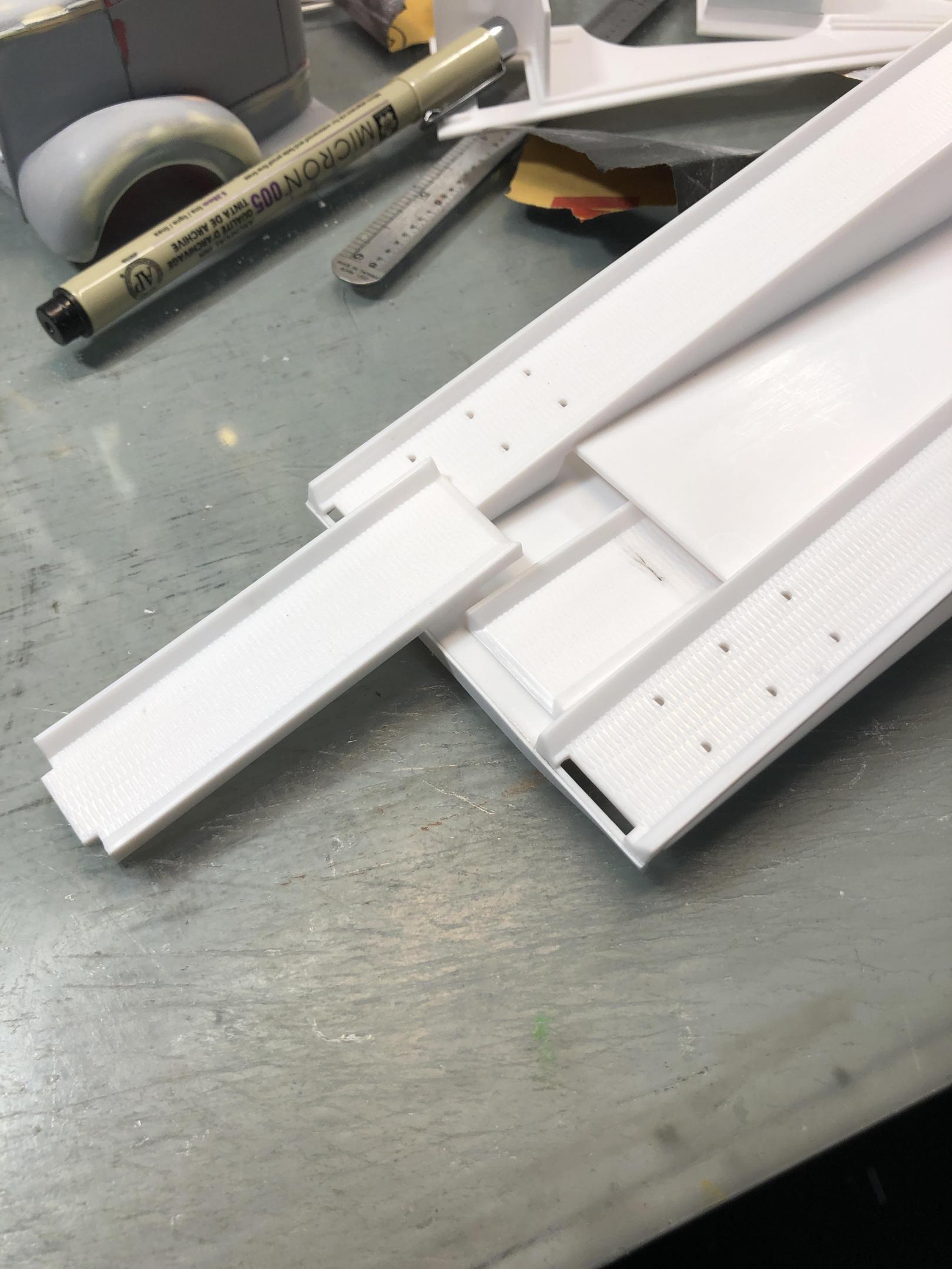

I turned my attention to the ramp this week. I started assembling some of it prior to paint. The minimal MPC instructions leave a few initial questions as far as the open compartments and provided (or lack thereof) interior panels. I fabbed up a few sides not provided to ensure items don't fall out of the compartment!
Interestingly enough, the box art shows that both moveable ramps slide into the area below the main 'floor' of the wedge. 7tfg7tfv.thumb.jpg.3e8bcb56c0ff46b39807ccd300004e2f.jpg

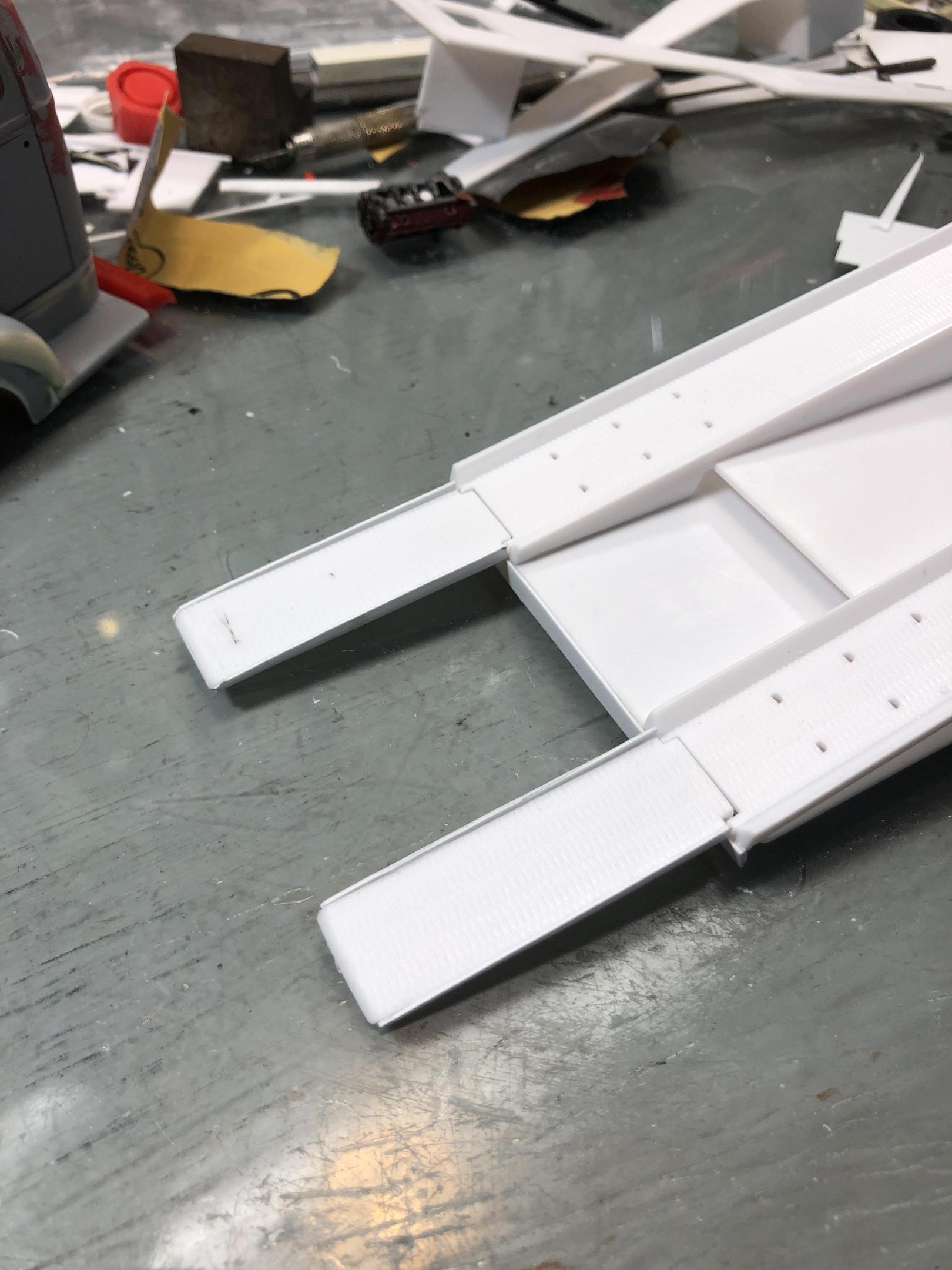

see them tucked in?
well the truth is that both of them DON'T fit!
So, decided to trim off the triangle side parts and add thinner styrene edges to narrow the ramps to fit under. I also shortened them as I won't need them to be so long as the whole COE and ramp will be lowered (praise the lowered).
997g897g7g.thumb.jpg.352212efe0439d216fb9106a06e8d163.jpg997g897g7g.thumb.jpg.352212efe0439d216fb9106a06e8d163.jpgioybouiyvy.thumb.jpg.30bb9f944248e178150ece18ed429aa9.jpgonpunpin.thumb.jpg.0ce93c5ff06b3135eb7368ee17faadf0.jpg
the new edges need to be sanded up and shaped....I also tidied up the rear valance as it was just left open as per MPC designed it. That will give a nice spot for tail lights and license plate.... -RRR
Edited by Rocking Rodney Rat
Nice work tuning up the flaws of the ramp body. It's one thing that the compartments weren't fully boxed in but seriously, nobody realized the ramps wont fit in their storage area?! Way to go MPC!
