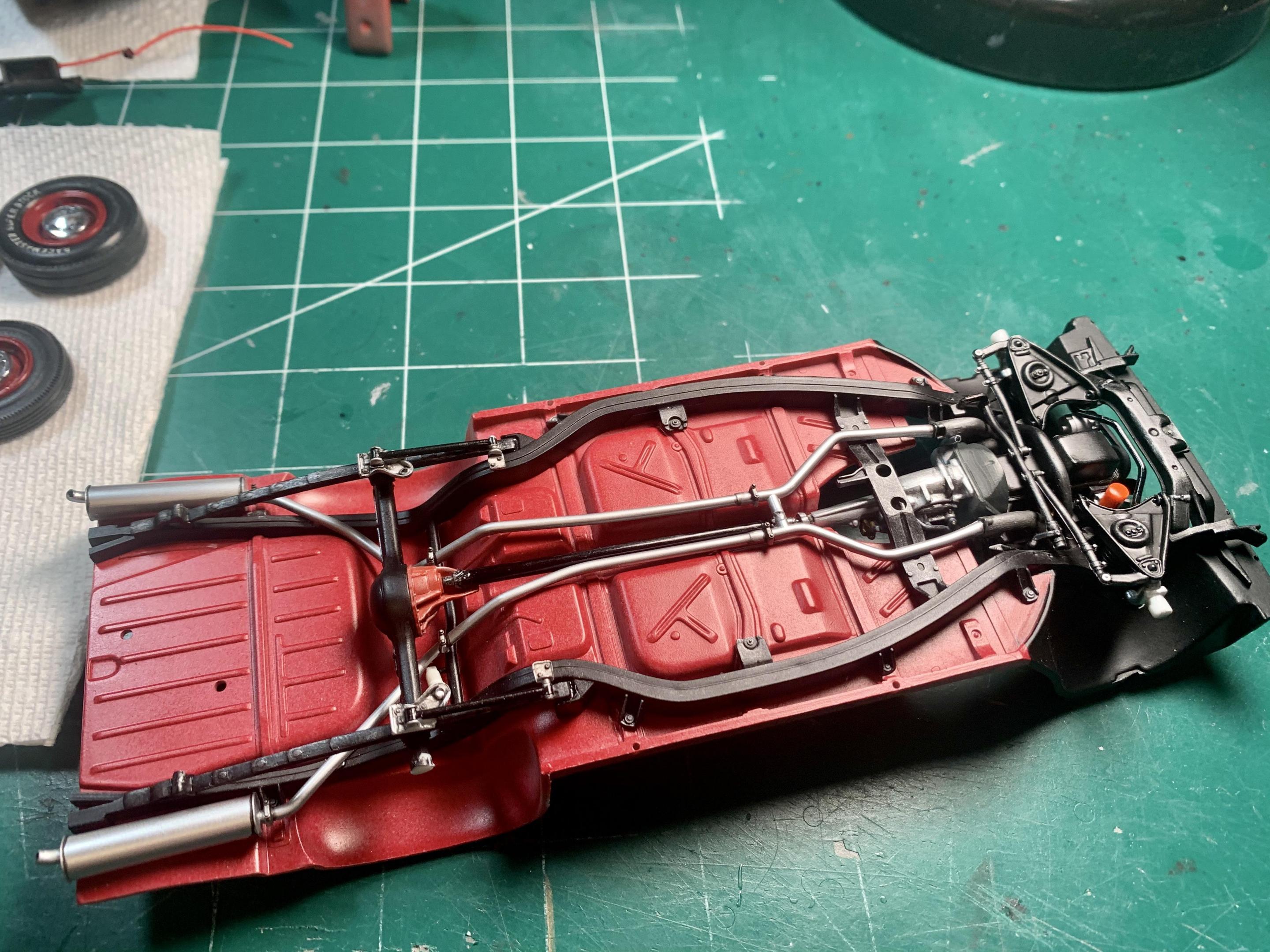

Hws5283 Posted March 7, 2021 Posted March 7, 2021 Many of the parts for the chassis say to be painted "steel" and I wanted to know what others are using for this "steel" color (paint color/company). Also any techniques used to weather these parts and make them look more used would also be appreciated. Thanks ?

StevenGuthmiller Posted March 7, 2021 Posted March 7, 2021 Just now, John Pol said: I don`t care for alclad at all not durable not like AK extreme Metal are real durable and don`t need black under it You don't necessarily need a gloss black base under Alclad. Only on the chrome or maybe polished aluminum. You're correct about durability to a certain extent, but a shot of clear will make all but the chrome paint as tough as nails. Every metal part that you see here is Alcad of various colors. All shot over primer, (except the chrome air cleaners, exhaust tips and radiator cap), shot with Testors clear lacquer, and slightly weathered. Steve

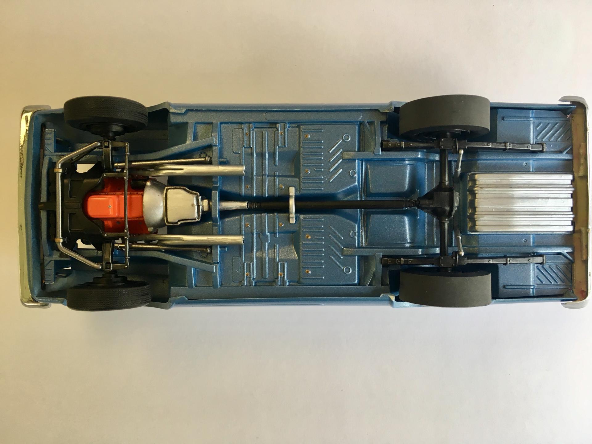

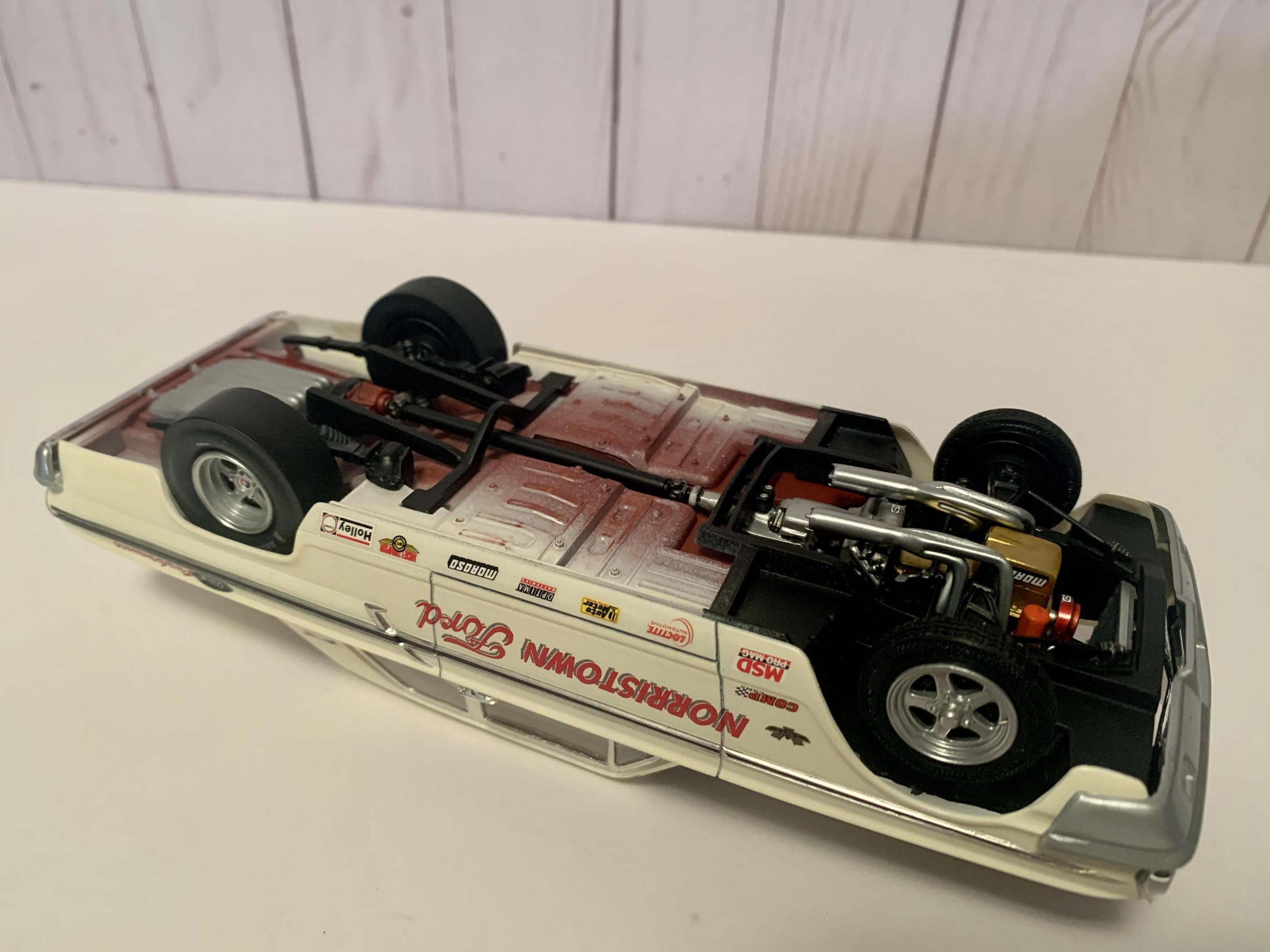

Brutalform Posted March 8, 2021 Posted March 8, 2021 I usually find out what the correct, (or closest to correct) the colors were on the real car. I seem to use a lot of semi gloss black on many of my builds. After the semi gloss has dried, I usually “dry brush” Testors Silver Chrome enamel, or similar over the details casted into the parts. It seems to give me the slightly used look I’m looking for. You can see the effect on the bolts, and springs, on these suspensions.
TransAmMike Posted March 9, 2021 Posted March 9, 2021 Great looking undercarriages Tom........you might wanna get a front end alignment on the blue on tho. ? Just razzing you buddy!!
bisc63 Posted March 9, 2021 Posted March 9, 2021 2 hours ago, Brutalform said: You can see the effect on the bolts, and springs, on these suspensions. Very nice applications here; especially love that stock Ford Chassis, got a 59 wagon that would look nice under!
Brutalform Posted March 9, 2021 Posted March 9, 2021 49 minutes ago, TransAmMike said: Great looking undercarriages Tom........you might wanna get a front end alignment on the blue on tho. ? Just razzing you buddy!! Thanks... every pic I take of an undercarriage makes those front wheels look way way off... gonna have to fire the alignment man...
