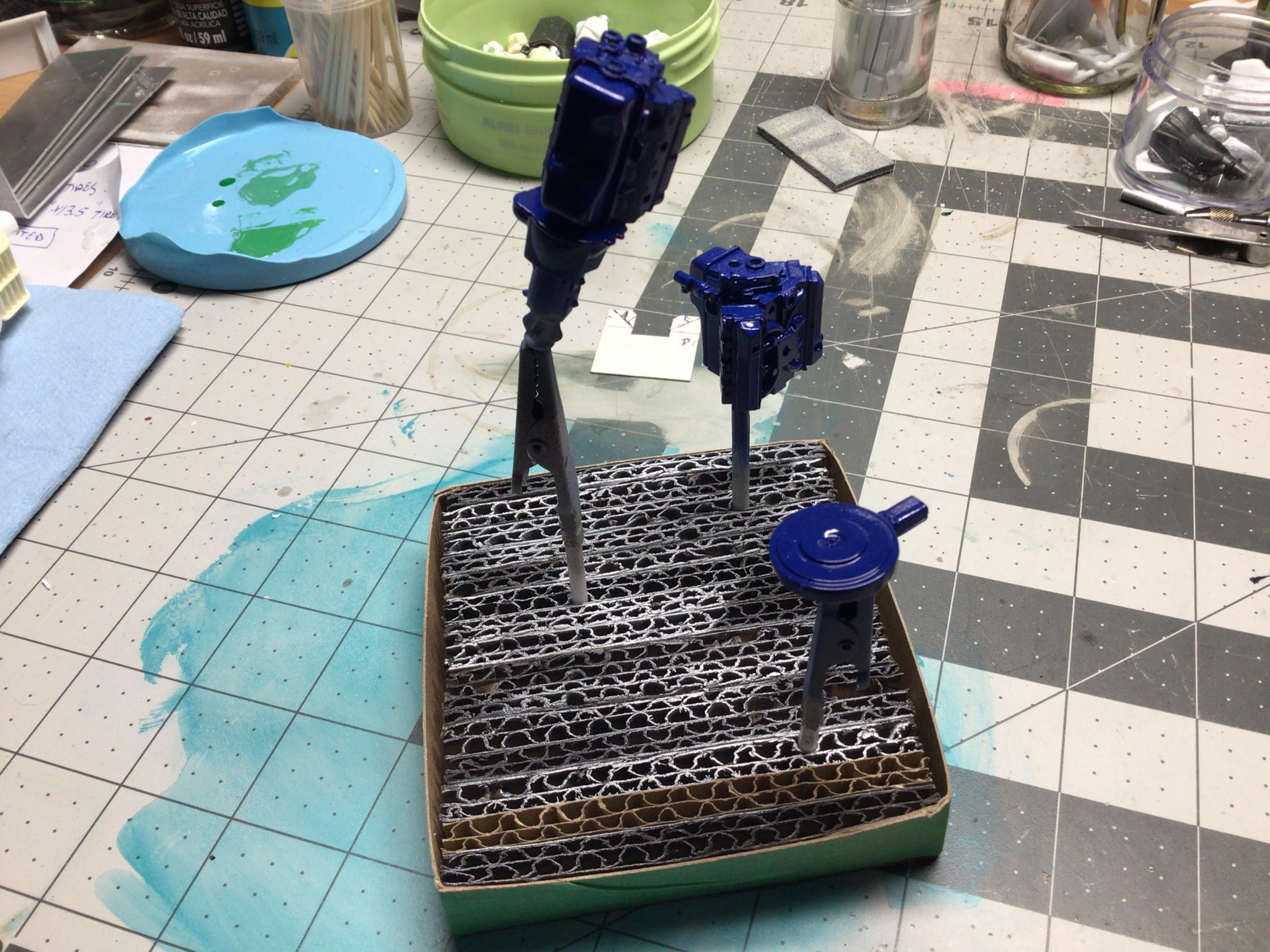

tbill Posted March 9, 2021 Posted March 9, 2021 I try to assemble as many parts as I can before paint. After parts are assembled, I use an alligator clip to hold them, or depending on the shape, I will drill a hole in an area that won’t be seen and use a skewer or something similar to hold the part ( think seats, big rig fuel tanks) , I also use a skewer in the transmission tail shaft to hold the engine/trans assembly to paint that. If you look long enough at a part, you can find some way to clip it or skewer it, lol.

Tom Geiger Posted March 9, 2021 Posted March 9, 2021 Very important to take the parts off the sprue and clean them up. Get rid of the mold lines, ejector pin marks and where it was connected to sprue. I do spray everything. I use the little Dixie bathroom cups for a lot of things, including paint stands. If an item is heavy, just stack a few cups for ballast! As said above, I mount things on toothpicks. I will drill small holes where it won't be seen. I will mount with blue painters tape onto a tooth pick. I also pin a lot of things together, so I drill and mount on pins, which also serve as handles for painting, see item in front in my picture. I'll mount an item on a pin and leave the full length of it for painting, and cut it to the length I need right before I use it. I also mount parts to tooth picks with white glue. The residue you get on your part may be the tape you are using. I use the painters blue for this.

StevenGuthmiller Posted March 10, 2021 Posted March 10, 2021 (edited) I use virtually the same technique as you do Miles. Larger parts that only need paint on one side get done exactly the same way as you do them. Smaller parts are done a couple of ways. First, if the part only needs finishing on one side as above, a piece of tape wadded up on the end of a tooth pick or skewer works just fine. If the part has a hole in it, I will insert a tooth pick firmly into that hole for painting. If the hole is small, I will sharpen the tooth pick until it fits snugly into the hole. Another option for very small parts without a hole is to make one. I drill a small hole in the part in an area that will not be exposed on the finished model and then either use a tooth pick, or in some cases a plastic pin. Pinning parts can come in very handy for assembly later on, so this is a good practice to get used to anyway. Parts with pins already present or added afterwards can be held with alligator clips fastened to wooden skewers and inserted into a piece of scrap Styrofoam. There are a lot of options for holding parts for painting. You just have to think about it a little sometimes. Steve Edited March 10, 2021 by StevenGuthmiller
