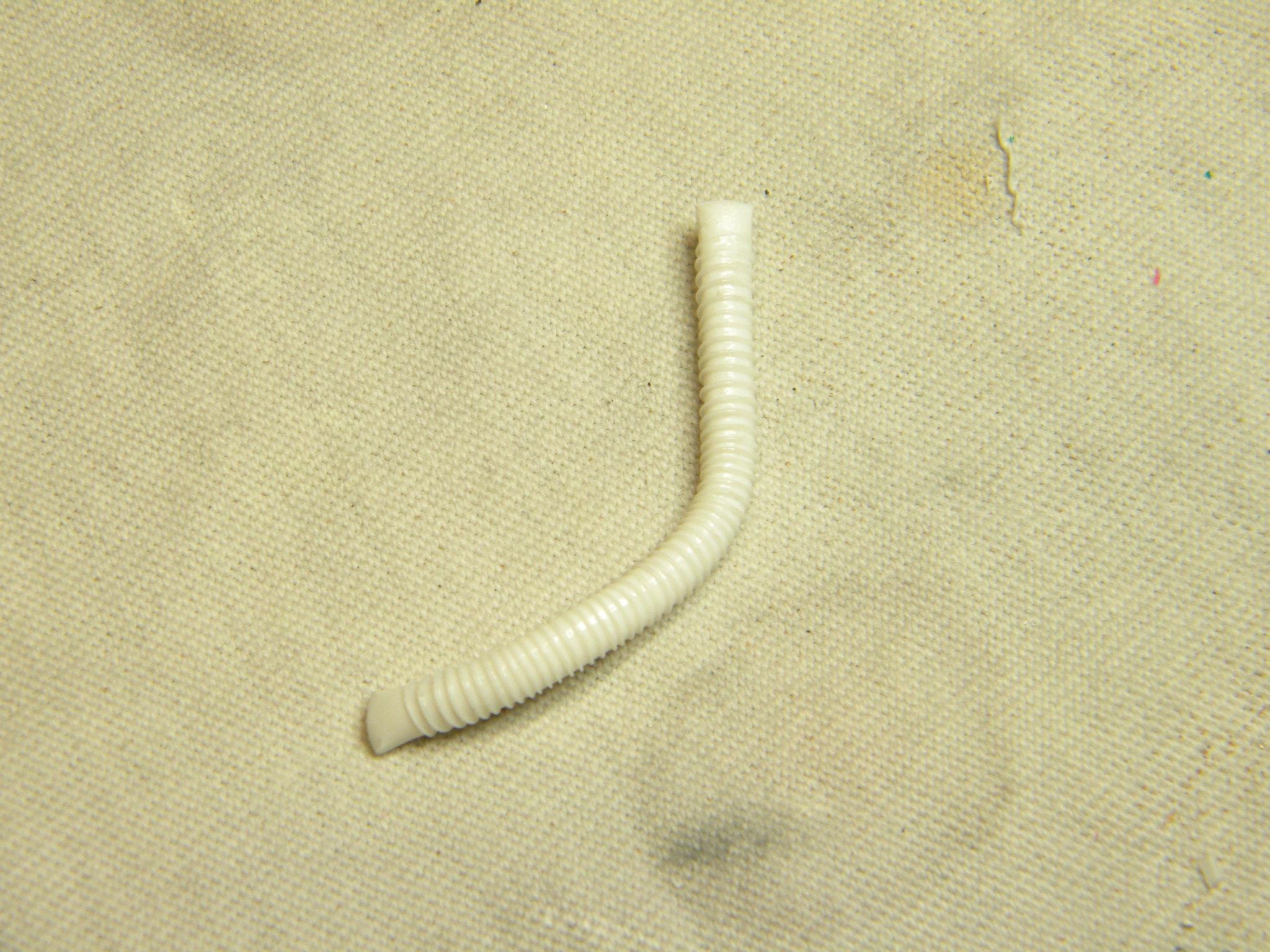

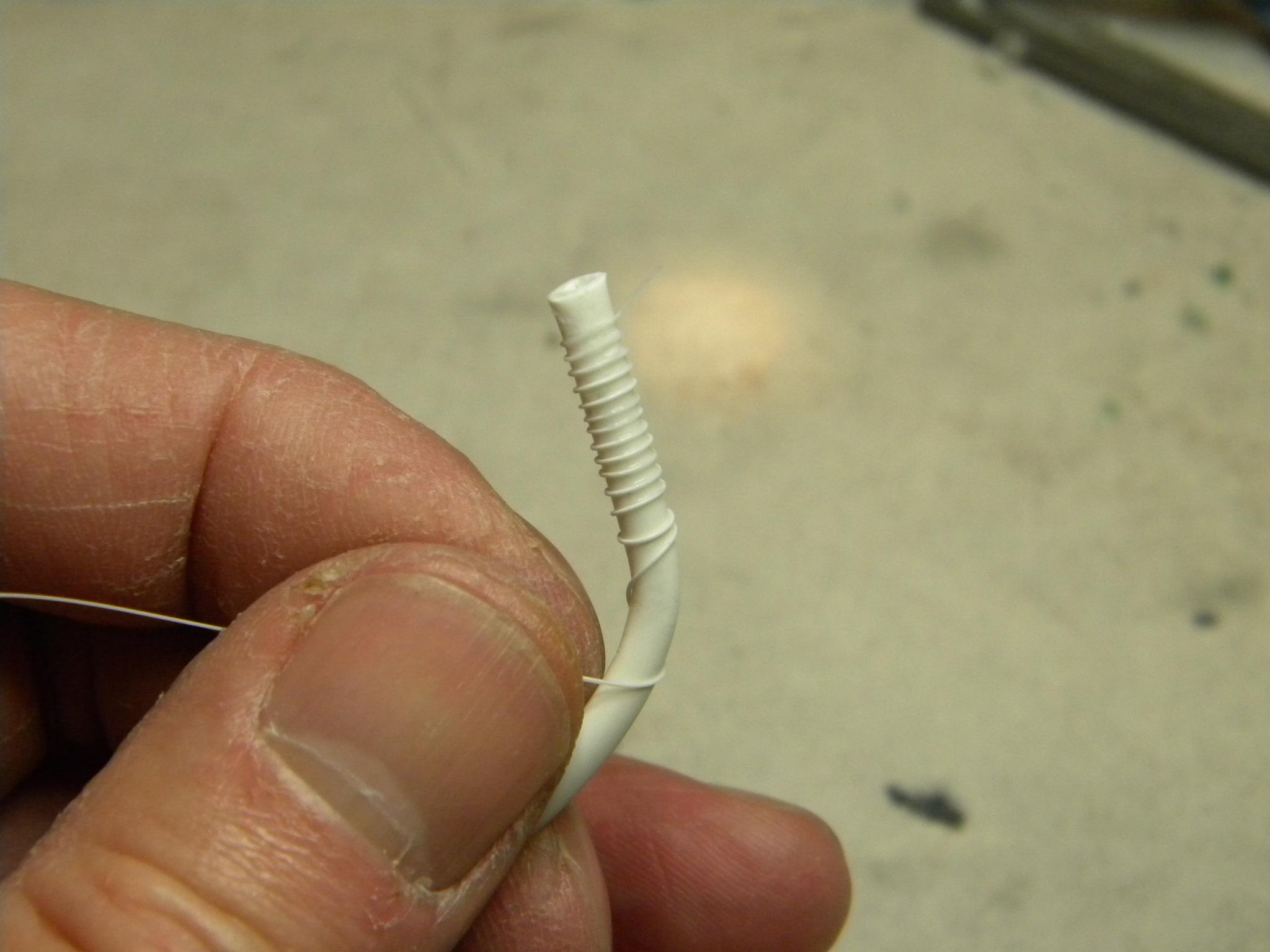

Richard Bartrop Posted March 12, 2021 Posted March 12, 2021 (edited) If you don't need it to bend, bend a piece of styrene rod to the right shape, then wrap some really fine styrene rod around it.(Plastruct makes some in .010") . Cement in place, and if you want to model the wrinkles, build those up with a brush, and some paint. IF it does need to bend, maybe use it as a master to cast it in RTV? Edited March 12, 2021 by Richard Bartrop

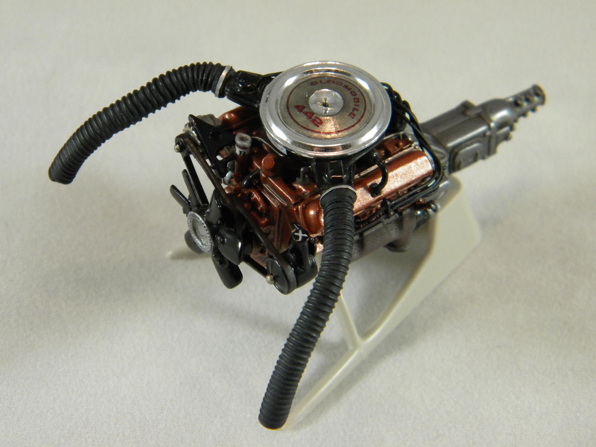

StevenGuthmiller Posted March 12, 2021 Posted March 12, 2021 1 hour ago, Richard Bartrop said: If you don't need it to bend, bend a piece of styrene rod to the right shape, then wrap some really fine styrene rod around it.(Plastruct makes some in .010") . Cement in place, and if you want to model the wrinkles, build those up with a brush, and some paint. That is exactly how I did the intake ducts for my '68 W-30. Steve

1972coronet Posted March 12, 2021 Posted March 12, 2021 The bag of ducts which @Exotics_Builder exhibited look great ! Here's the site ; lots of cool stuff ! : Detail-Up Parts (modelfactoryhiro.com) Thanks @StevenGuthmiller for posting pics of that fantastic '68 W30 ducting which you've scratch-built !

StevenGuthmiller Posted March 13, 2021 Posted March 13, 2021 1 hour ago, Venom said: Ahhh ... after seeing it, this is very convincing. I’ll have to go up to Hobby Lobby and see if I can get it in the right diameters. What type and brand of glue did you use? I use Plastruct "Plasti-Weld" liquid cement. Do two or three wraps at a time and dab on the glue while you hold it in place. Repeat. Steve

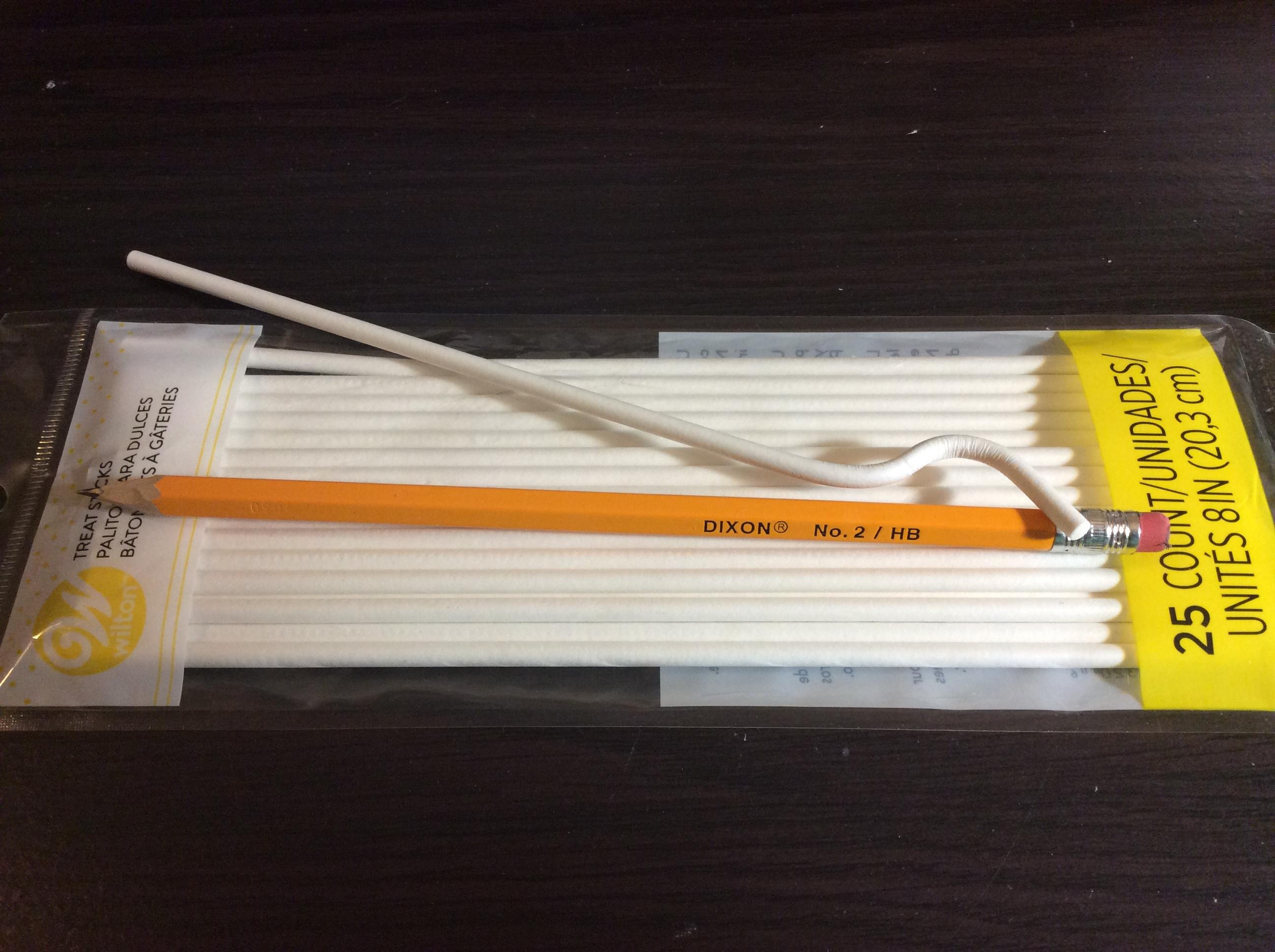

Venom Posted March 13, 2021 Author Posted March 13, 2021 I found these at Walmart tonight in the party isle for $1.75. The diameter is perfect. They are super compacted, tightly wound paper (lolly-pop) sticks basically. They are pretty easy to bend and they stay bent and can be cut with side cutters and trimmed with a razor. They do wrinkle slightly, but I think paint will obscure that, and if you bend them much beyond 90 degrees they’ll start to split. I bent a piece and cut it to fit my application and I think it’s going to work. I’m thinking of using thread or fishing line to do the ribbed wrap, (thanks to above suggestions), but probably best with some type of thread since the stick is paper and I’ll have to use canopy glue. The only con I can think of so far is will the glue adhere to it and also to resin? It’s so dense that it seems like it should, but I’m actually not even sure exactly how im going to be doing the fitting at this point anyway.

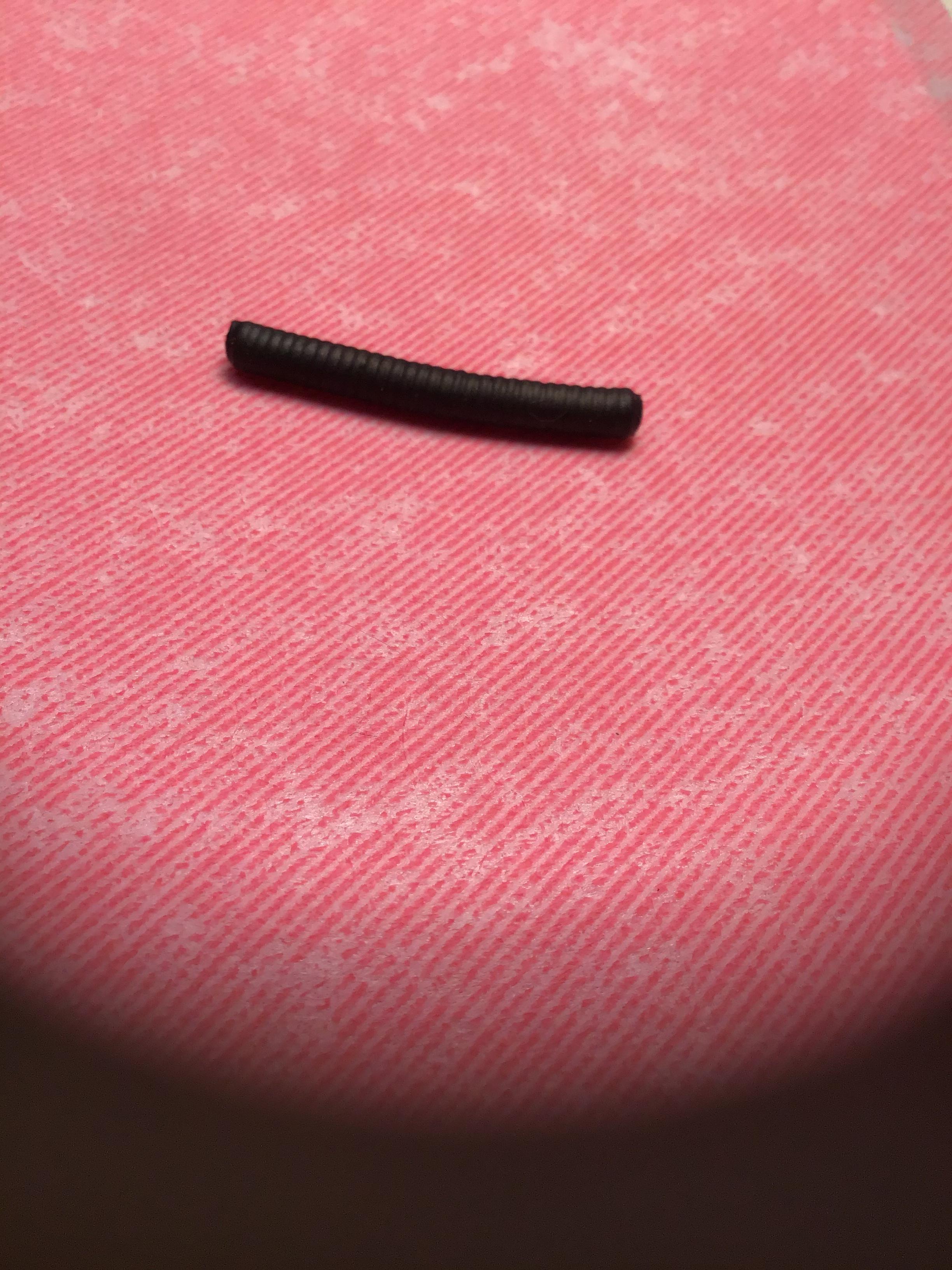

Rick L Posted March 13, 2021 Posted March 13, 2021 I use a combination of these techniques. Wrapping wire around a rod and slipping heat shrink tubing over the assembly. Heat it up and slide it off the rod. gives you the option of sizing the diameter and it’s slightly flexible. Works ok for radiator hose also. This is a sample of .025 wire wrapped around .07 drill bit.
