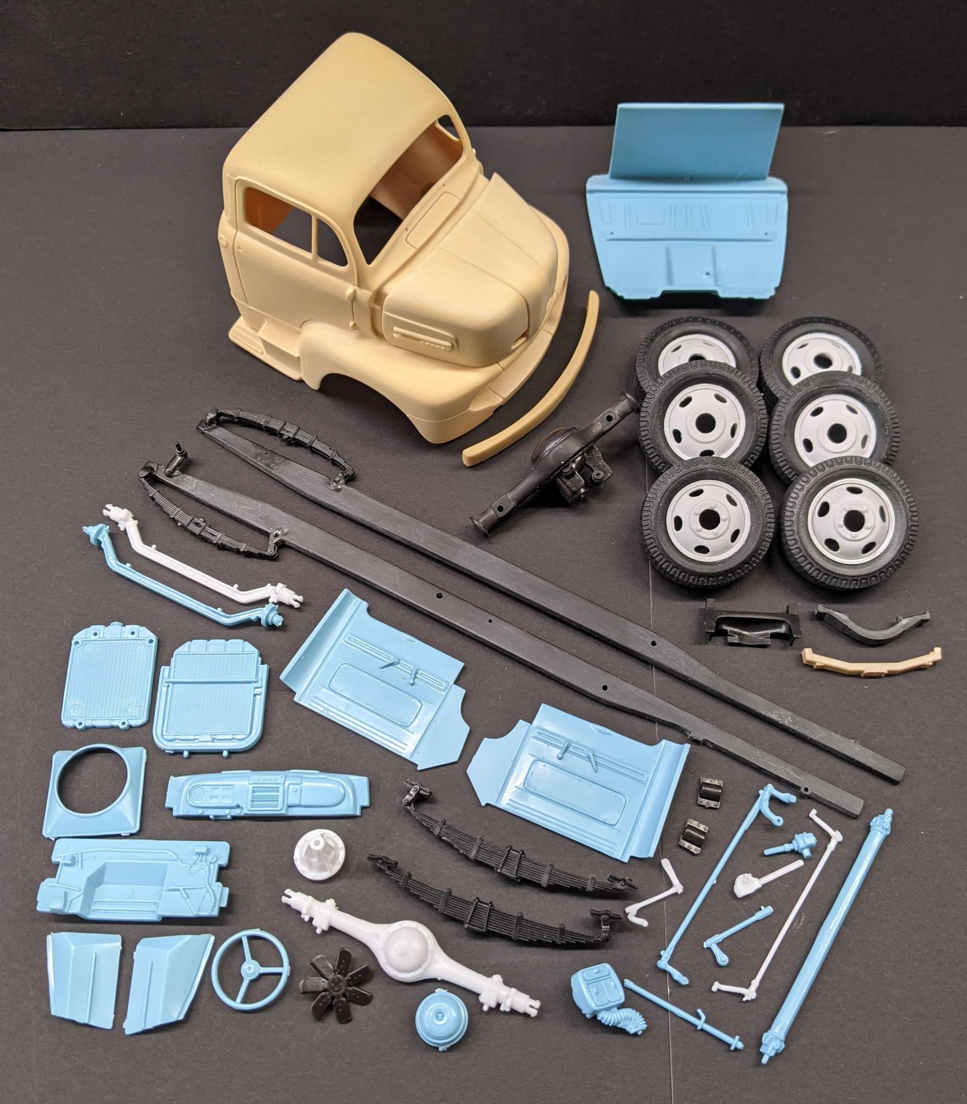

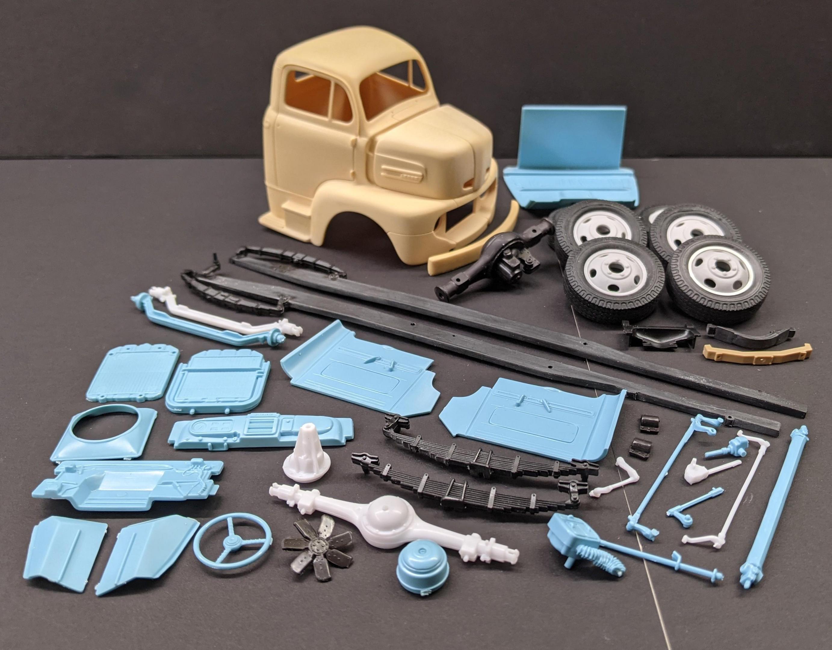

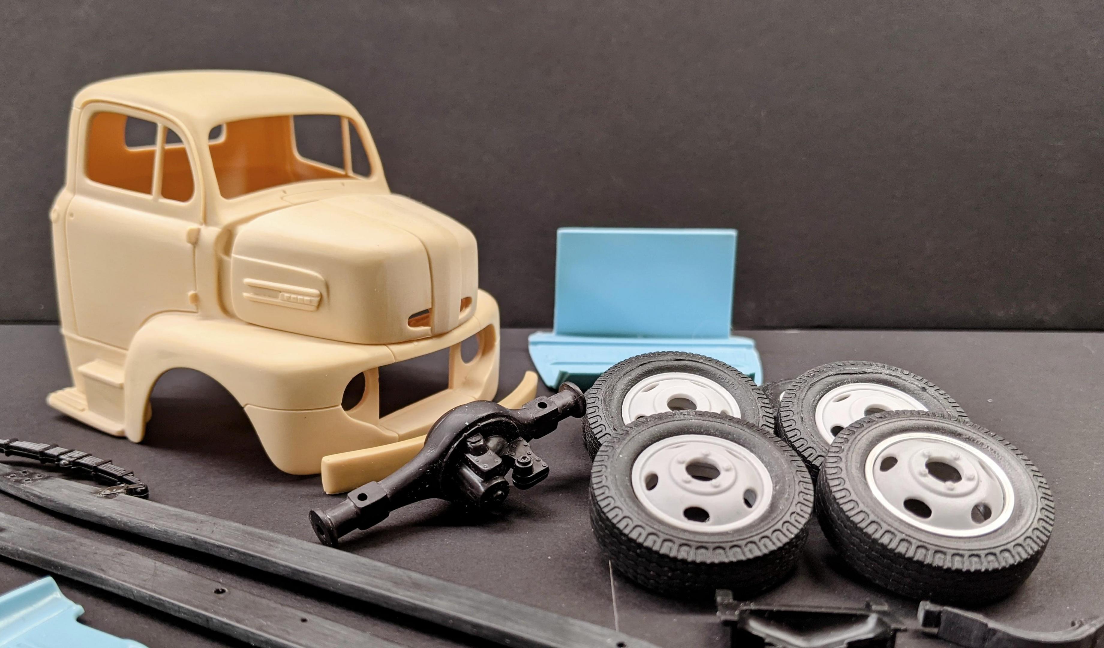

I had been looking for a Ron Cash Ford COE cab and hood for a while, and finally acquired one via eBay a few months ago, so it's now time to get the ball rolling on this project. The only issue is the cab isn't representative of any actual Ford F-series COE that I have found nor seen. It retains the narrower fenders from the F-1 through F-4(?) trucks, while the COE version should have wider fenders, grille surround, etc....hence the F-3.5 title. I've decided to use the cab as-is and not widen/correct the front clip, so I guess it will be a phantom of sorts.
The main parts I'm starting with are the aforementioned 1/25 Ron Cash Ford F-5 COE cab, hood, and front bumper,  the 1/25 W57 set of six 5-hole, 5-lug 20" dually wheels and 34" tires from Scenes Unlimited, frame rails, leaf springs, and cross members from the 1/24 Italeri GM-Opel Blitz, a few odd bits from the 1/25 IMC Dodge L-700, and various parts from the 1/25 Monogram '50 Ford F-1 pickup. A few parts from the 1/25 Revell '41 Chevy pickup are shown below in white, but I'm not sure I'll end up using any of them.
I'm still undecided regarding what will be resting upon the rear frame rails. A vintage cargo box is the leading candidate at this point, so, we'll see what happens as the truck itself progresses. Engine choice is something I need to decide on relatively quickly, too, but I will be keeping it in the Blue oval V8 family.
I did some preliminary research regarding the rearend, which needs to be larger and a more heavy-duty style, so I think the IMC Dodge L-700's Eaton 2-speed rear can be modified a bit to pass for the real thing:
Here's the IMC Dodge L-700 rearend, prior to sanding:
The rearend housing appears to have the correct overall shape and size, so I will only need to change the carrier assembly. At least the mounting surface against the rearend housing is flat, so that makes things a bit easier.

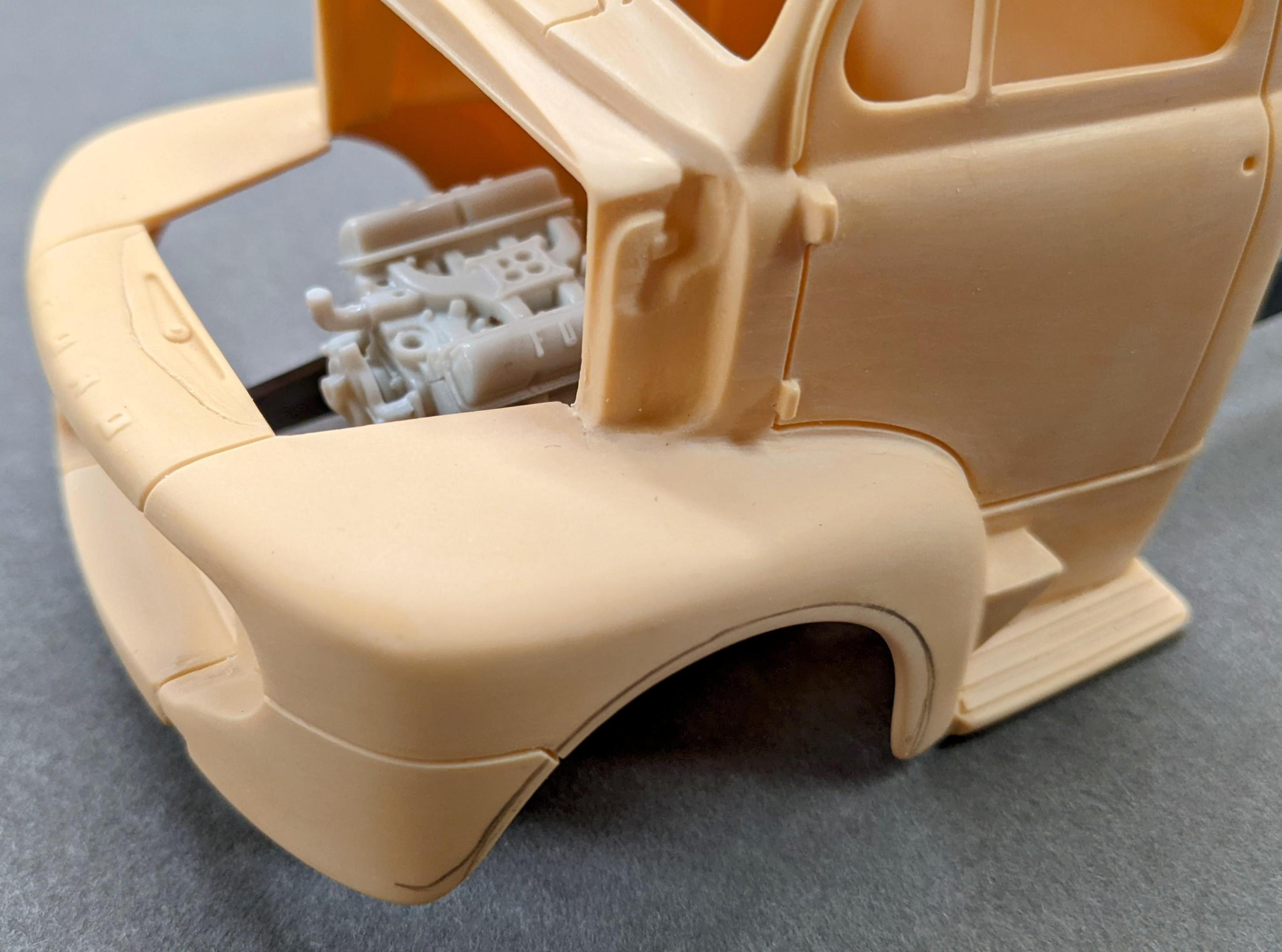

Great to see you tackle a medium duty Casey. Looks like you have most of the necessary parts to build a very realistic COE. The cabovers did have a slightly wider front end, but I would just leave it as is also. You might want to enlarge  the fender openings  though.  Scene Unlimited wheels  will look great on this one.
I definitely plan to do just that. I measured the O.D. of the tires (1.425') this afternoon to determine the new wheel arch diameter, so I just need to find something the correct O.D, then get to sanding.

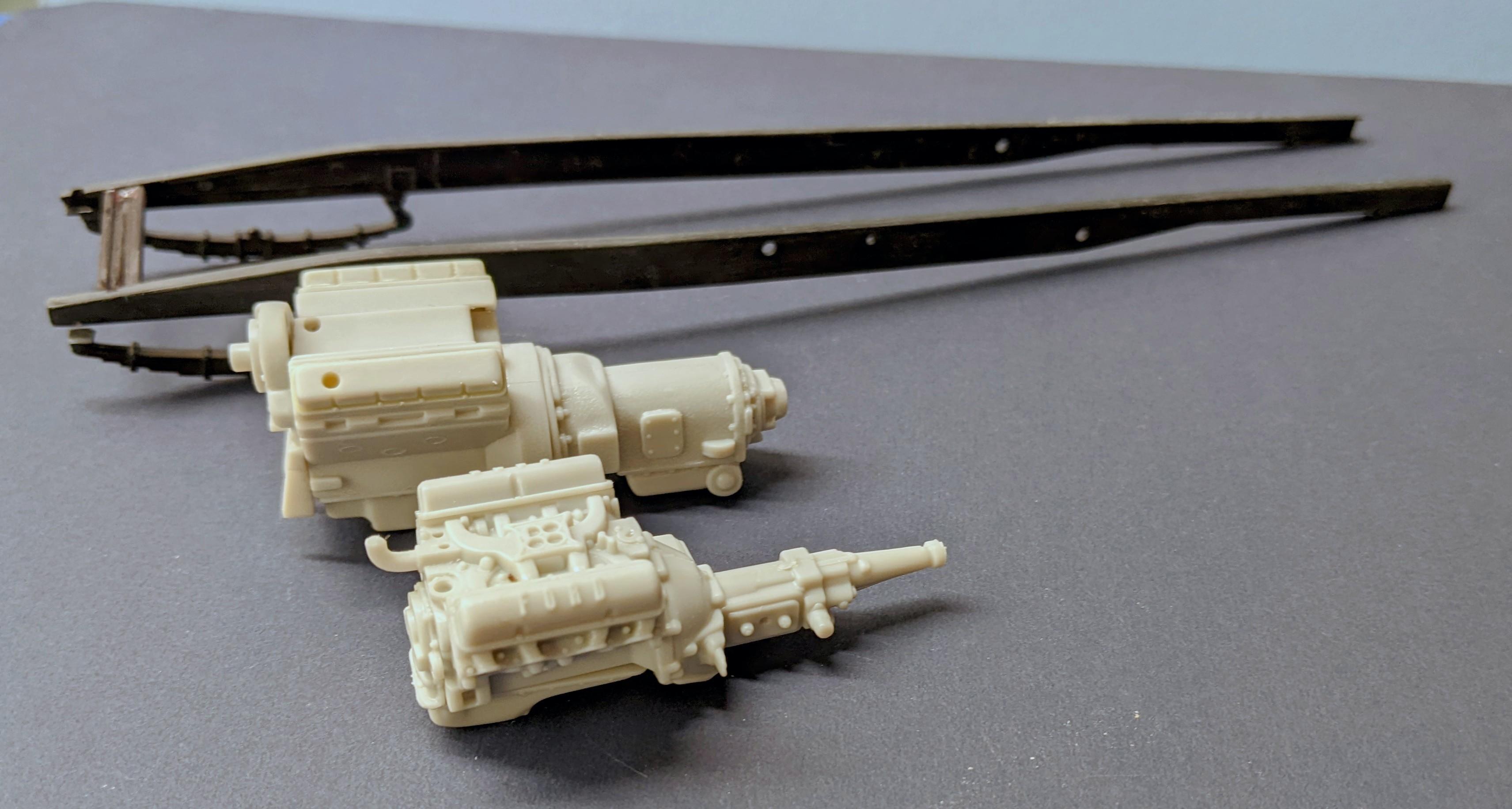

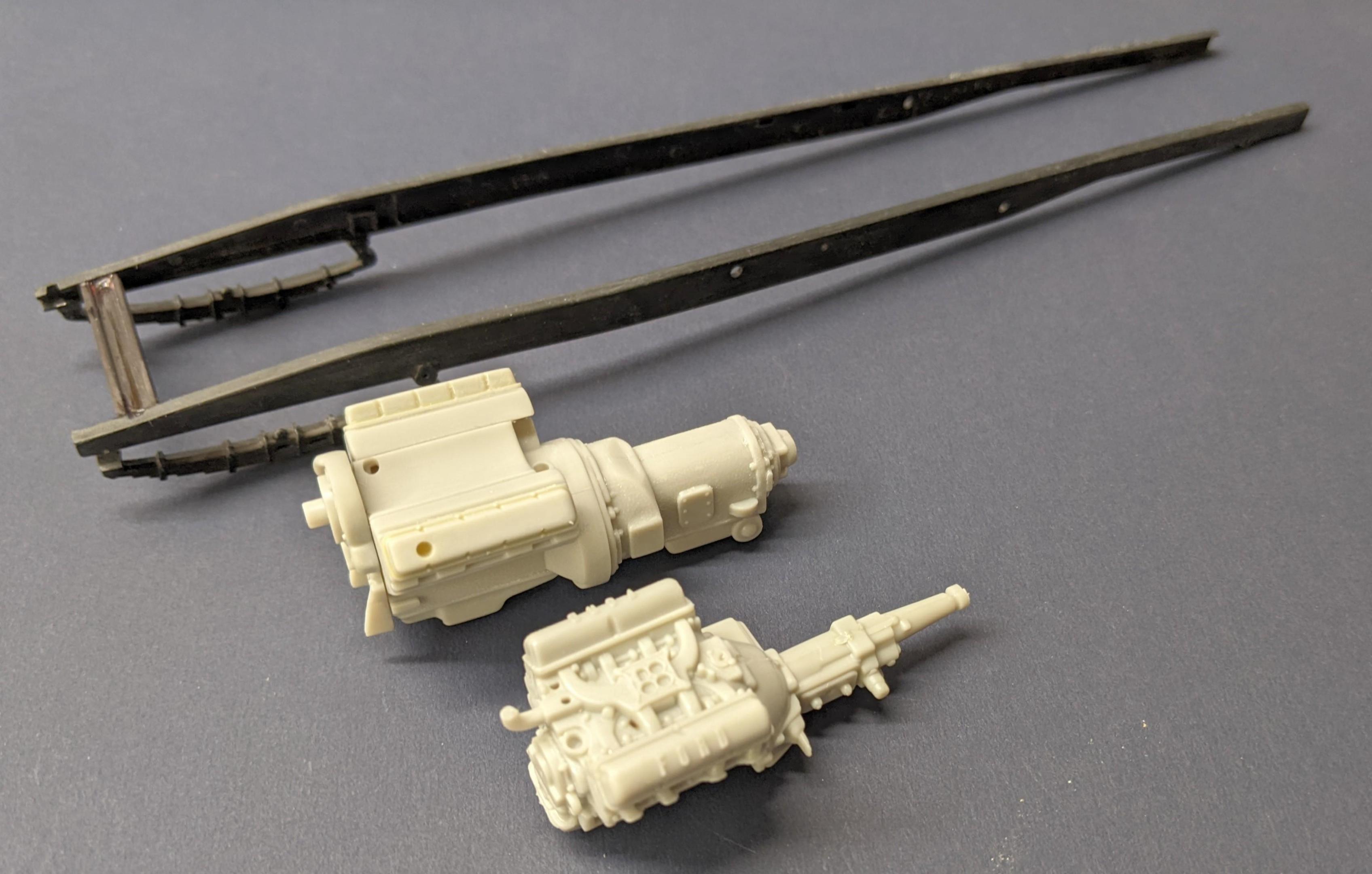

I built and mocked up the Ford 534 Super Duty engine from the AMT Ford C-Series kit, but felt it was a bit too heavy duty for this truck, so I started assembled the Ford FE-series V8 from the AMT '60 Ford Starliner, which feels much more proportionate. I will need to change the trans to something more truck like, but I think the FE will work better. Comparison shots of both engines:

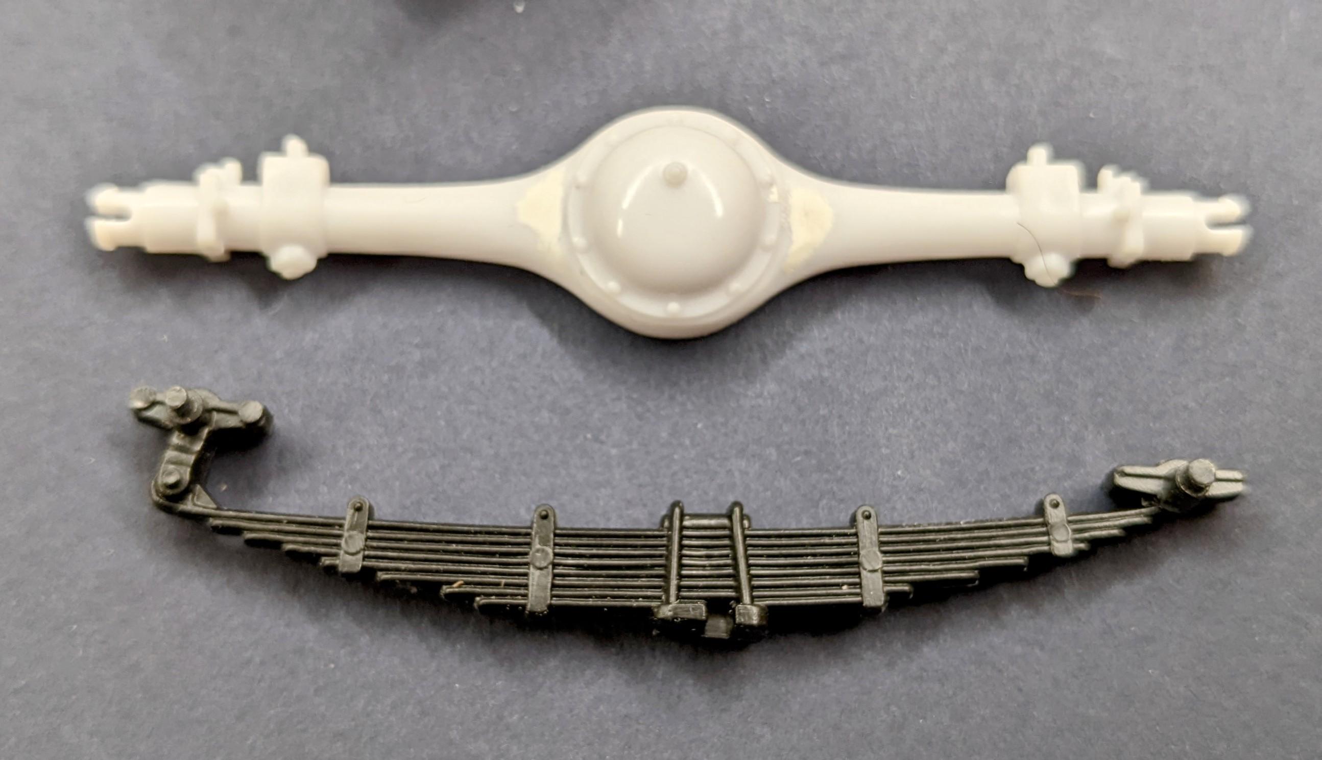

I also decided to ditch the rearend from the IMC Dodge and use the Revell '41 Chevy rear instead, but have some future mods in mind. Spring-to-spring width matches the new rear much better, and while it might be a bit undersized, it is far better detailed. It feels more proportionate, and while I will still need to make it a two-speed style rearend, I think this is a better rear to start with compared to the IMC part. The Revell rear did have two sinkholes which I started filling, but here's a shot of the rearend and a rear leaf spring together:
Edited by Casey

I removed the '60 Starliner's 4-speed manual, and separated the IMC Dodge L-700's truck trans from it's engine block, so now I have something which will work. Still have to add a bulge for the RH starter mount, but this'll do nicely, I think:
I also scrounged through my parts box for a deeper sump oil pan and found one, so that was glued in place, too.

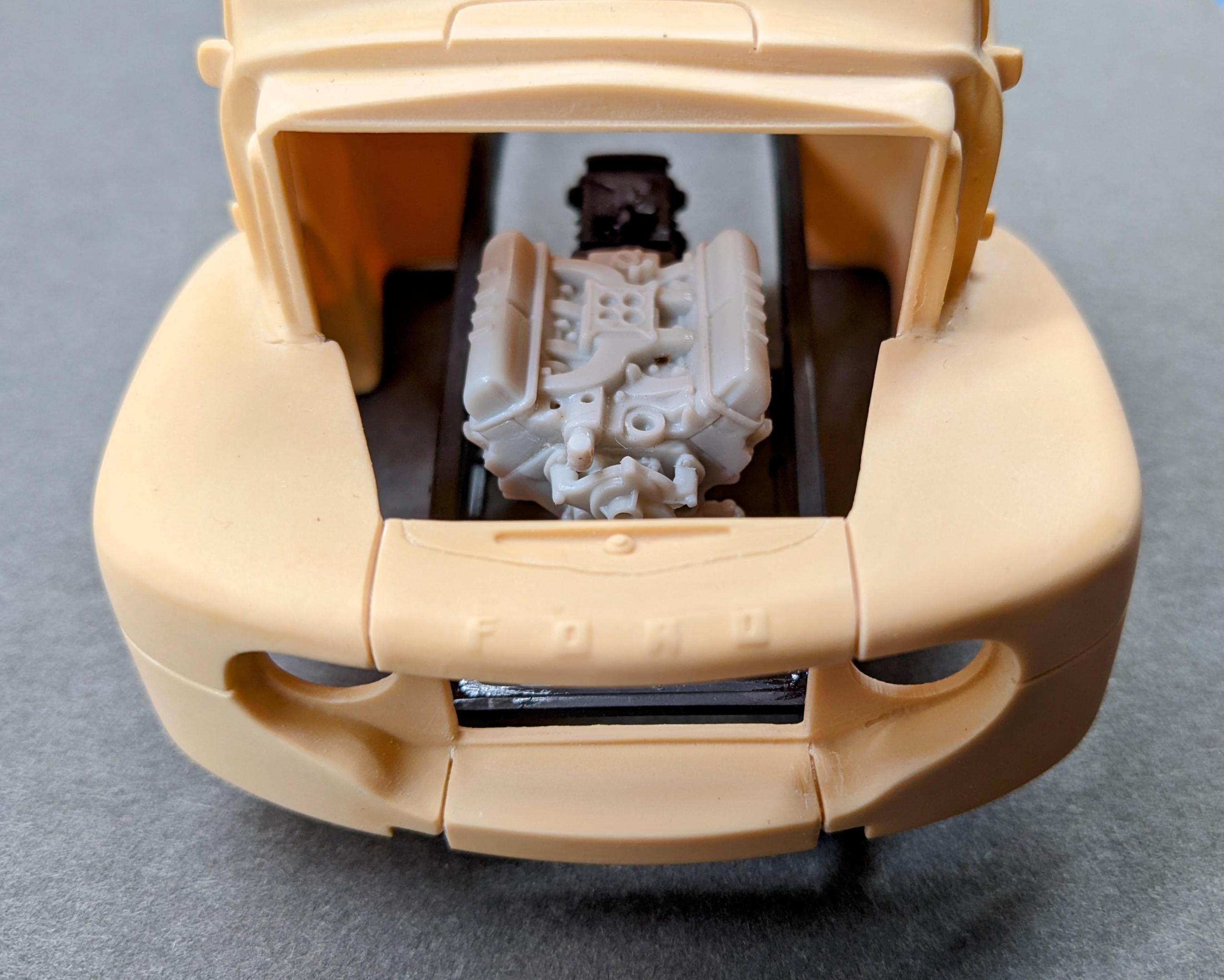

The engine is mostly assembled, and after a preliminary test fit, I found there's plenty of room underhood/cab. I wanted to get the engine and trans assembled as a unit for test fitting purposes, so with that done, I can set the frame width and permanently attach some crossmembers.
