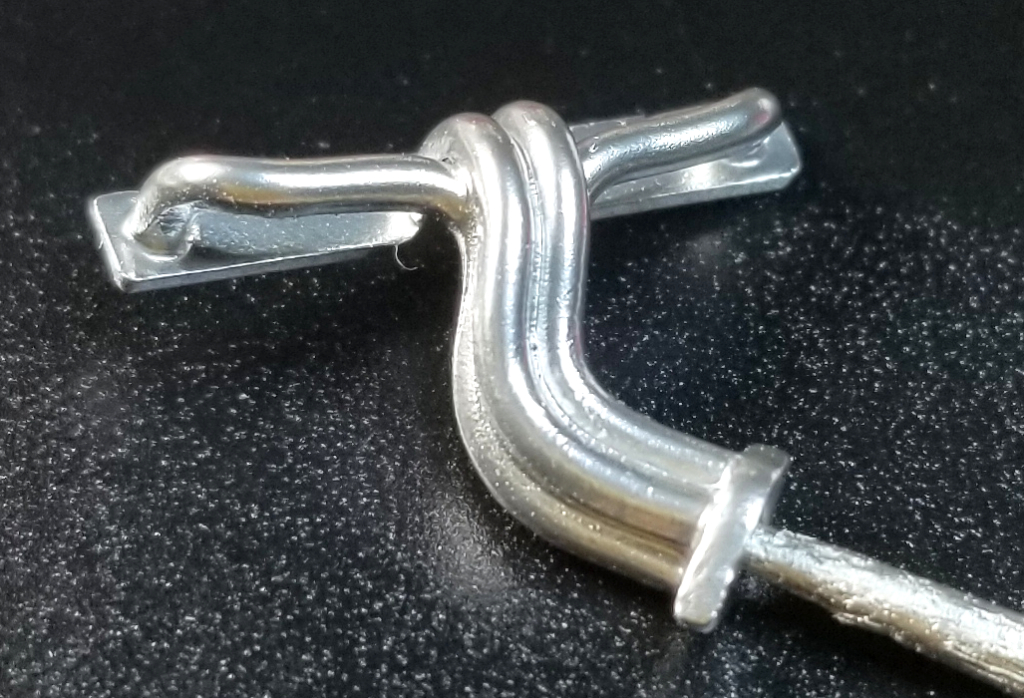

Modelbuilder Mark Posted July 17, 2021 Posted July 17, 2021 1 hour ago, peteski said: As for the marks left after burnishing, I suspect that is due to the adhesive layer being thicker than BMF, so it acts as a rubbery substrate under the foil. It will squish under the pressure of a toothpick, resulting in visible marks. I was goin to say the same thing, that is what I was thinking from the looks. I agree, if there is a way for BMF to return to their good stuff, let's hope they do.

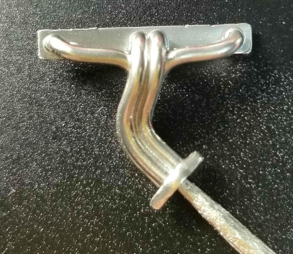

slusher Posted July 18, 2021 Posted July 18, 2021 On 7/3/2021 at 6:28 PM, TransAmMike said: I'm pretty sure someone mentioned this product before but if not, gotta say I'm pretty impressed with the results. Bought this can at HL a while back and never actually used it. I will say this tho, do nt try to polish it or the shine will not be the same. Thanks for posting this I going to try it out….

TransAmMike Posted July 18, 2021 Posted July 18, 2021 10 hours ago, slusher said: Thanks for posting this I going to try it out…. Hey neighbor. Try it. Not BMF chrome like shine but close.

crazyjim Posted August 1, 2021 Author Posted August 1, 2021 I tried out ta sample of EZ Chrome that Cobraman sent to me. In a word, TERRIBLE! The stuff is way too thickand doesn't allow for any detail to show through. The adhesive is super sticky. I worked for quite some time to get the glue residue off the paint. Some of the chrome came off fairly easy but left a clear band where the foil was. I scrubbed for a while with enamel reducer to get it off.
