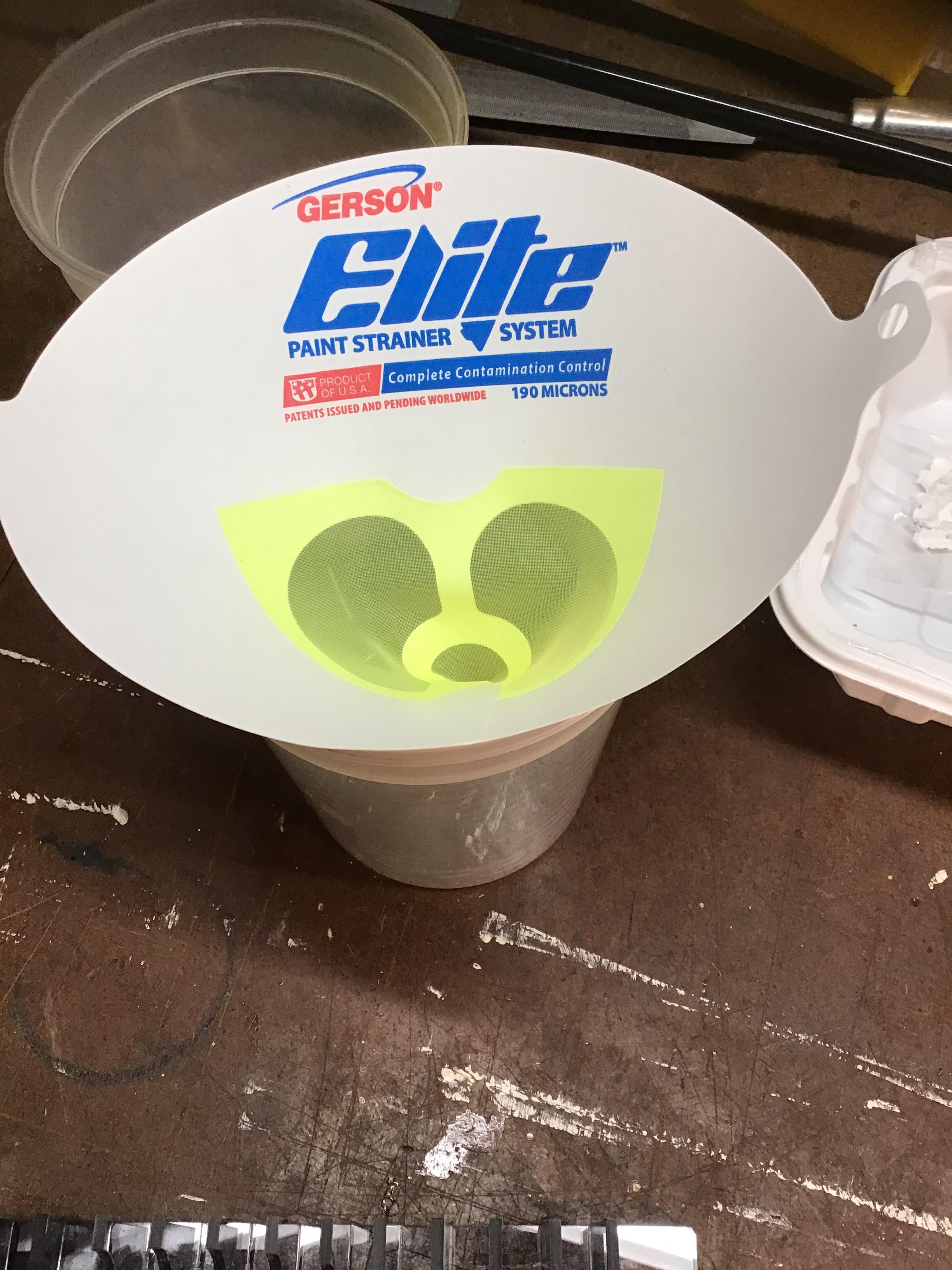

Miatatom Posted March 31, 2021 Posted March 31, 2021 Use a clean container and strain your paint through a good 190 micron paint filter and you won't need another filter in the container.
Kromolly Posted March 31, 2021 Posted March 31, 2021 1 hour ago, Miatatom said: Use a clean container and strain your paint through a good 190 micron paint filter and you won't need another filter in the container. That's a good point and that's what I do with automotive paint. There's no filter in my spray guns. I had a problem with some old Model Master paint and didn't have a good filter on hand. I'll look for the 190 micron. Thanks.
Rick L Posted March 31, 2021 Posted March 31, 2021 11 hours ago, Miatatom said: Use a clean container and strain your paint through a good 190 micron paint filter and you won't need another filter in the container. Totally agree. You don’t need to get your fingers painted removing and replacing the filter on the end. Gerson and DeVilbis manufacture good ones.
peteski Posted March 31, 2021 Posted March 31, 2021 8 hours ago, Rick L said: You don’t need to get your fingers painted removing and replacing the filter on the end. Gerson and DeVilbis manufacture good ones. I would never dream of getting my fingers painted with my siphon-tube-mounted filter. As you can see in the photo, it is totally paint free. Remember, the airbrush has to be cleaned (by running lacquer thinner through it) after each painting session. That gets everything cleaned (including the mesh filter). So when I do handle the mesh filter, it is paint-free. I also seldom take it off the tube. If I see some fizz accumulated on it, I just take some masking tape and using the adhesive side I pull the fuzz off the mesh. While still useful, to me the paint strainer seems more messy, and it is not designed for the minuscule amounts of paint we use for our models. Plus some (rather pricey) paint gets wasted.
Rick L Posted March 31, 2021 Posted March 31, 2021 The filter IS designed to filter minuscule amounts of paint as long as you pour the paint in a stream and not just dump it in. If you chose not to filter your metallics that’s your prerogative.
