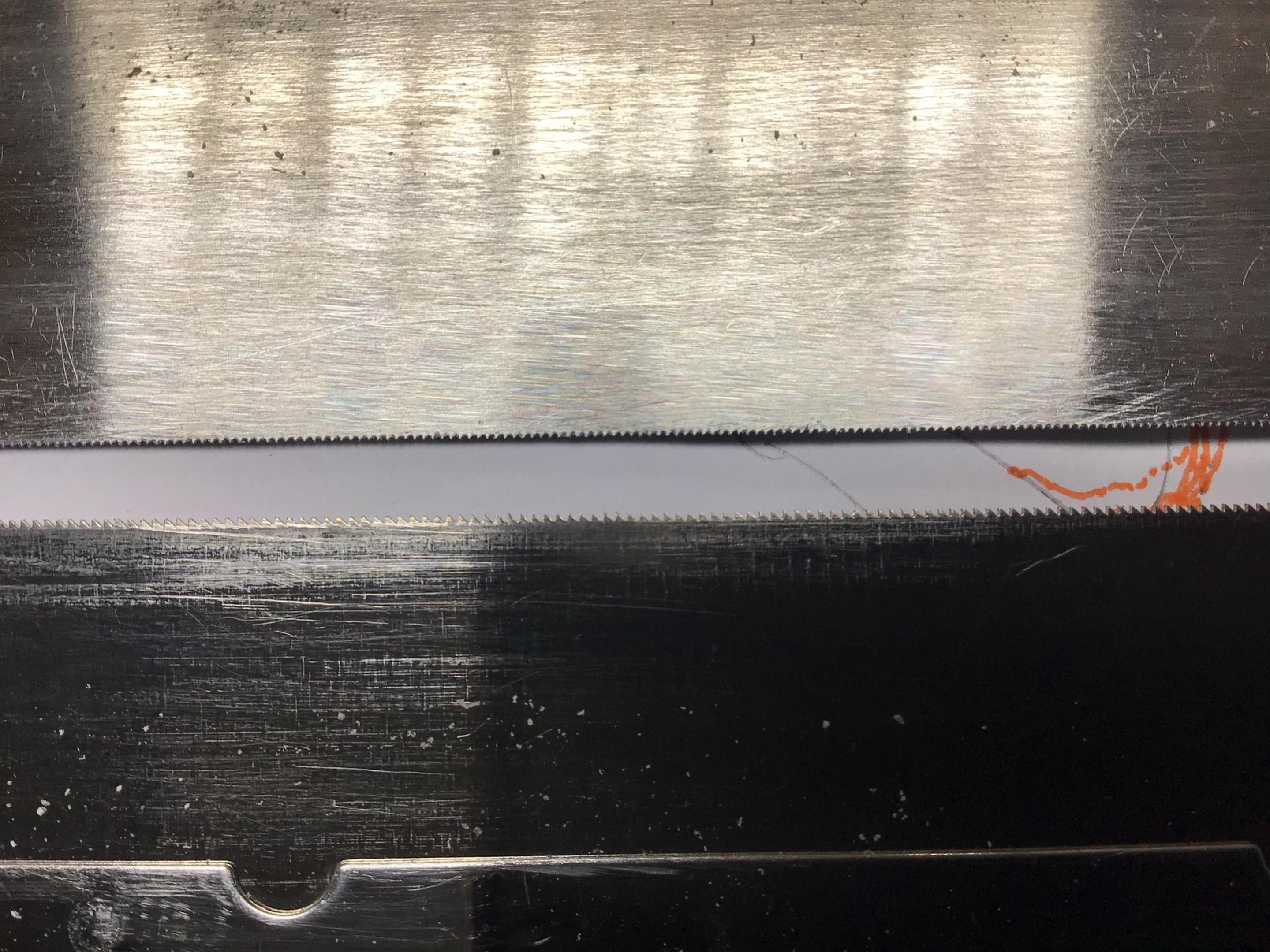

NOBLNG Posted April 4, 2021 Posted April 4, 2021 (edited) I mostly use the mitre box. My first saw was an Exacto, then I found this Huron (top) on clearance at Michaels. It has even finer teeth than the Exacto and is really good on thin wall stuff. Edited April 4, 2021 by NOBLNG
