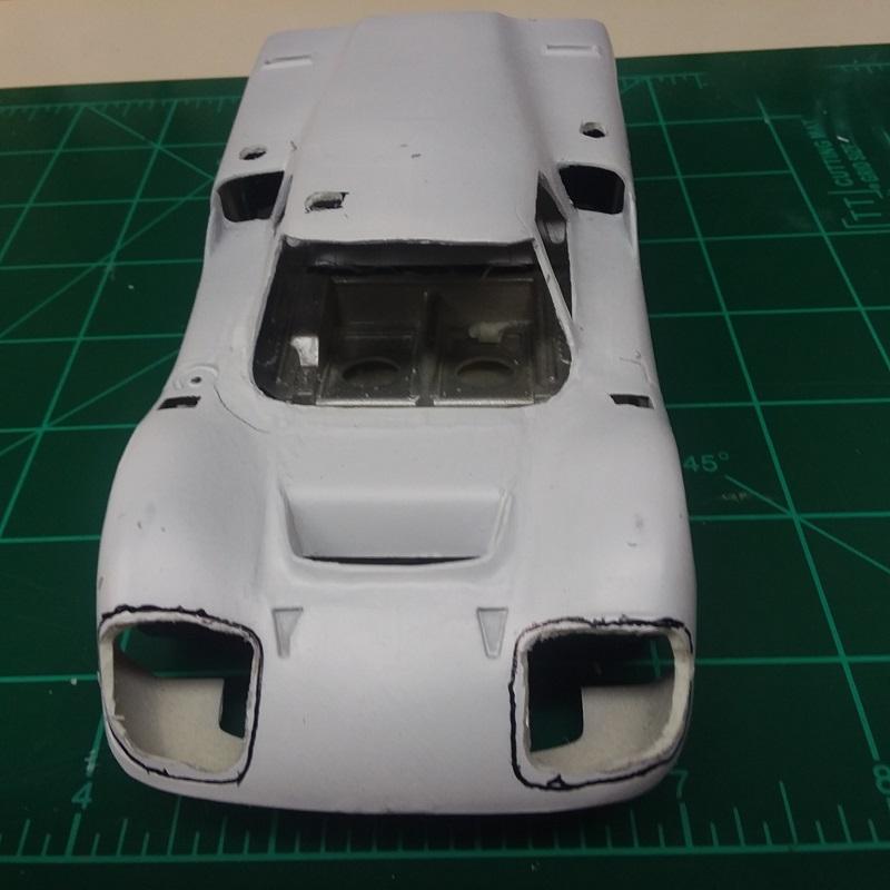

Gramps46 Posted April 3, 2021 Author Posted April 3, 2021 (edited) Now up on wheels and in white primer. Now the hard part, let it dry thoroughly and scribe in the door lines. Also need to open up the headlight buckets and add the roof top rear view mirror. Some more photos from Daytona test. Edited April 3, 2021 by Gramps46
Gramps46 Posted April 3, 2021 Author Posted April 3, 2021 This was kind of scary opening up these holes in the body with a Dremel. Afraid the Dremel would get away from me and go scooting across the top or bonnet.

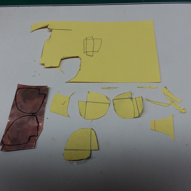

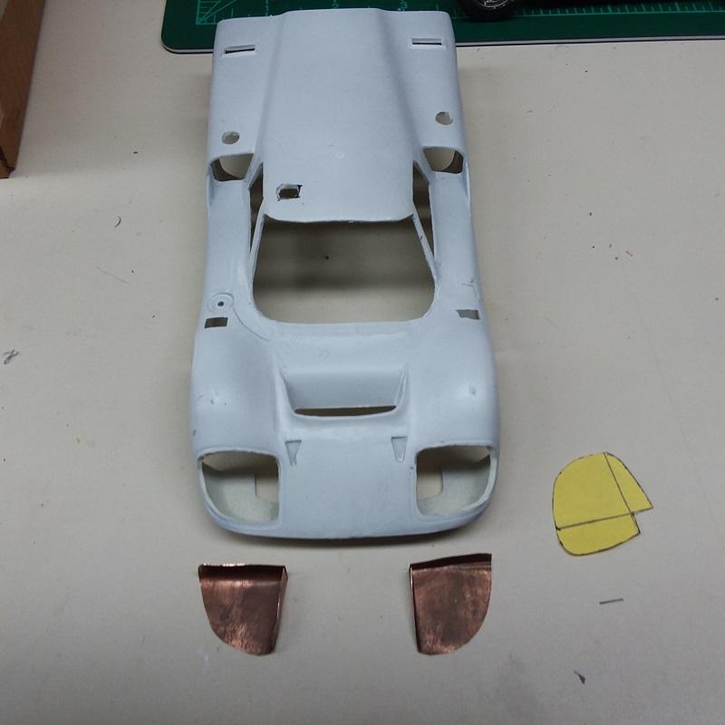

Gramps46 Posted April 6, 2021 Author Posted April 6, 2021 The good news is that some progress was made this morning. While consuming about half of an index card and several tries I was able to get a good template for the head lamp buckets. I transferred the template to some cooper sheet and folded the buckets. I choose cooper because it is easy to cut and keeps its shape once bent.
Venom Posted April 6, 2021 Posted April 6, 2021 Awesome! ... It takes more than one thinks to come up with patterns that bend to shape to fit.?
