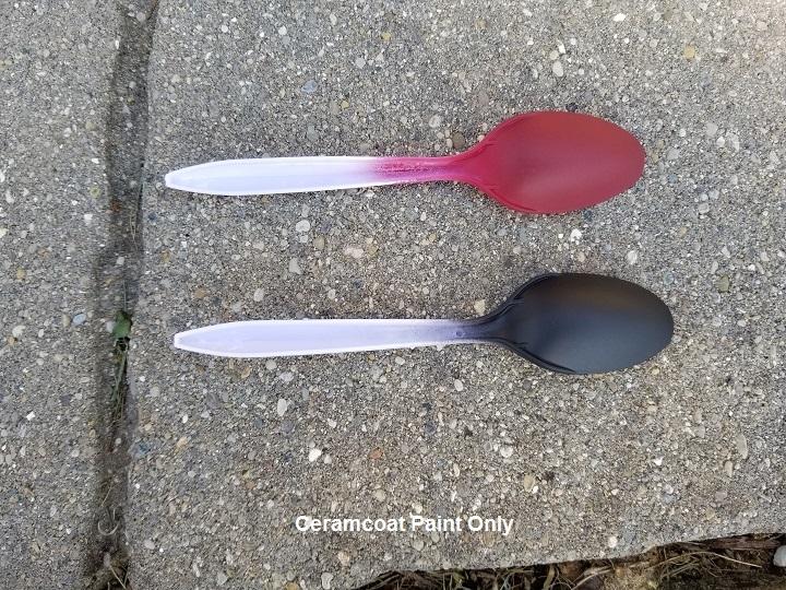

Zippi Posted April 15, 2021 Posted April 15, 2021 I did the spoon test this morning on two different colors bought at different times. Each spoon has 10 light coats of Ceramcoat Acrylic paint and 25 light coats of Tamiya Clear. Yes....25 coats of clear. someone told me to keep spraying light coats to let it build up until it gets shiny. I just think the Tamiya Clear is just that, Clear and not a shiny finish. What do you guys think? I'm going to buy some of the Pledge tomorrow and do the same test and see how it comes out.
peteski Posted April 15, 2021 Posted April 15, 2021 I'll repeat: try spraying the clear over bare plastic spoon to see what the "real" sheen is. X-22 will not be as glossy as Testors Wet Look clear, but it shoudl be pretty glossy. You migth not be spraying it on wet enough (after few lighter coats). In my experience (with any paint) you can't get shine from light coats. Also, as your photos show, Ceramcoat appears to be a flat paint. Paint is flat because its surface has microscopic roughens. The clear coat has to fill that roughness, and the clear itself has to levell-off to produce smooth glossy finish. As far as the bottle being mislabeled - that is easy to verify. Just look through the jar's bottom. If the paint is water-clear, it is glossy. Satin or flat paints have flattening agent in them, which makes the paint in the jar look milky, and the flattening agent also settles on the bottom.

Michael jones Posted April 16, 2021 Posted April 16, 2021 5 hours ago, Zippi said: I did the spoon test this morning on two different colors bought at different times. Each spoon has 10 light coats of Ceramcoat Acrylic paint and 25 light coats of Tamiya Clear. Yes....25 coats of clear. someone told me to keep spraying light coats to let it build up until it gets shiny. I just think the Tamiya Clear is just that, Clear and not a shiny finish. What do you guys think? I'm going to buy some of the Pledge tomorrow and do the same test and see how it comes out. The reality is, you could apply 100+ coats and it wont be shiny, if you don't apply the clear wet enough. Also Mr levelling thinner really makes a difference to allow more flow. I would suggest just practicing some more with much wetter coats. Any paint will come out flat, if applied dry. Usually a couple of coats is enough with most hobby paints like Tamiya and Mr Color. Mike
FLHCAHZ Posted April 16, 2021 Posted April 16, 2021 I agree with Mr Jones. No clear is going to look shiny when you are "dusting" it on. You have to find the balance of "just wet enough" without running the clear.
peteski Posted April 16, 2021 Posted April 16, 2021 9 hours ago, FLHCAHZ said: I agree with Mr Jones. No clear is going to look shiny when you are "dusting" it on. You have to find the balance of "just wet enough" without running the clear. We are unanimous on this.
