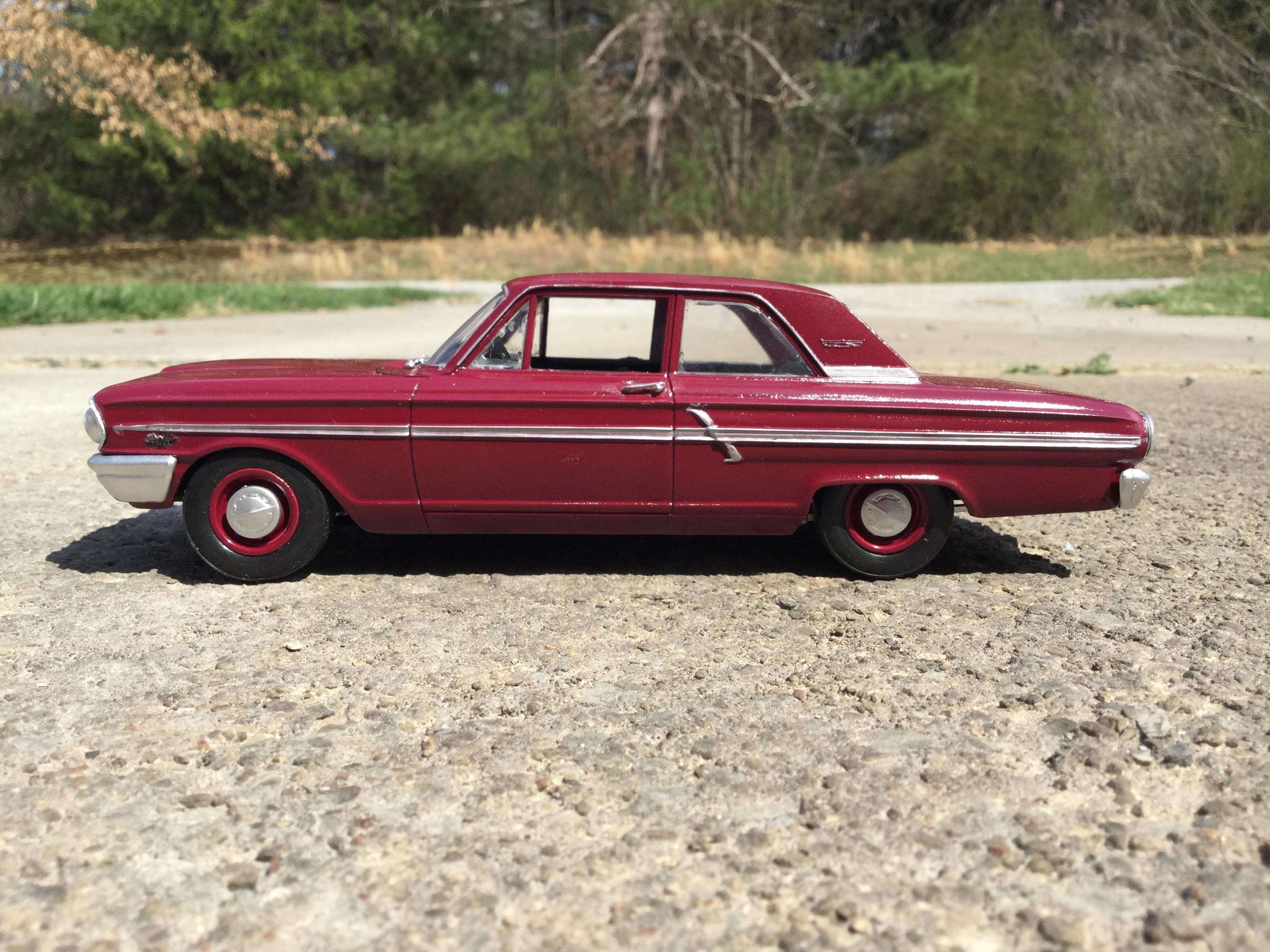

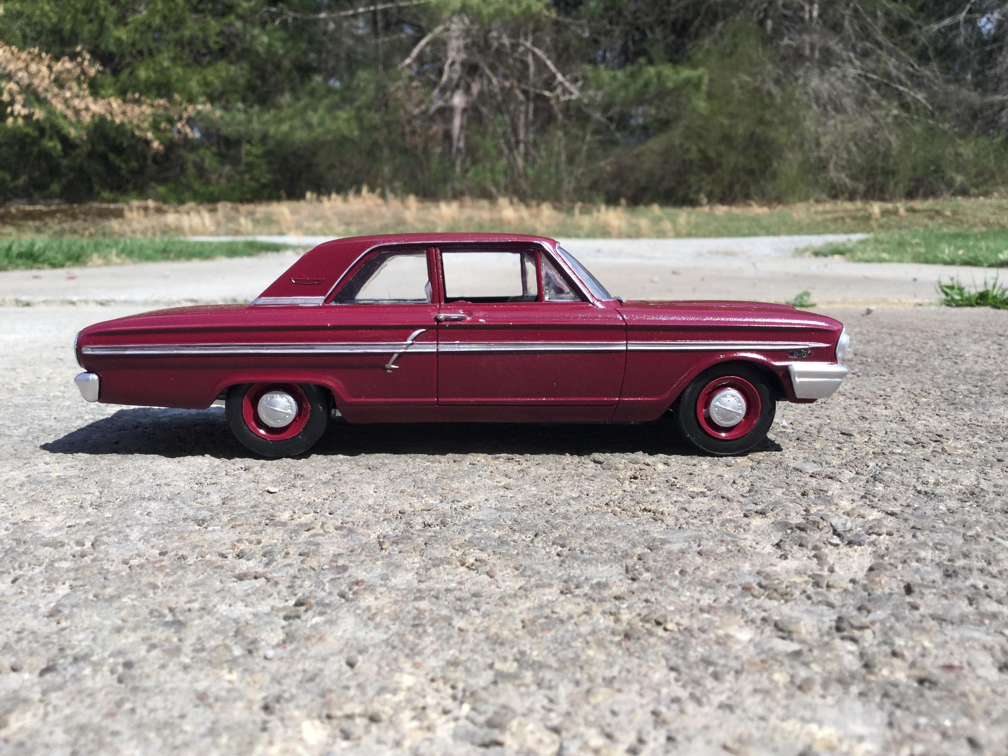

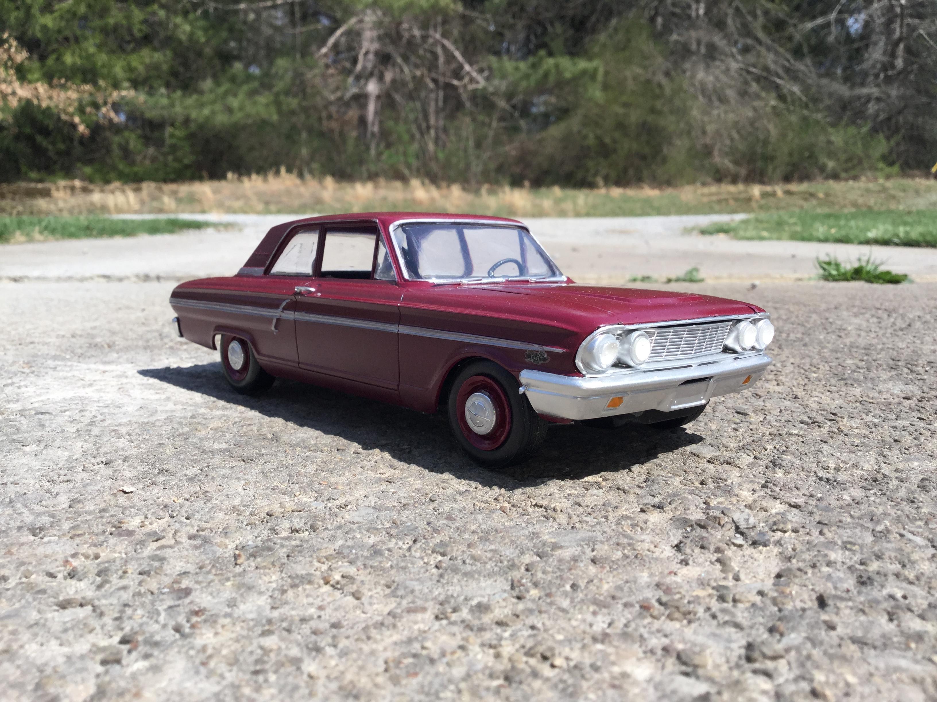

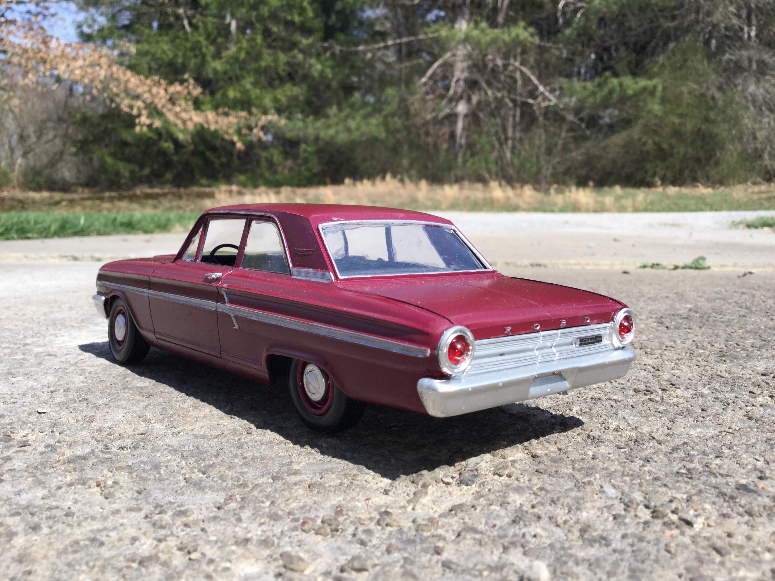

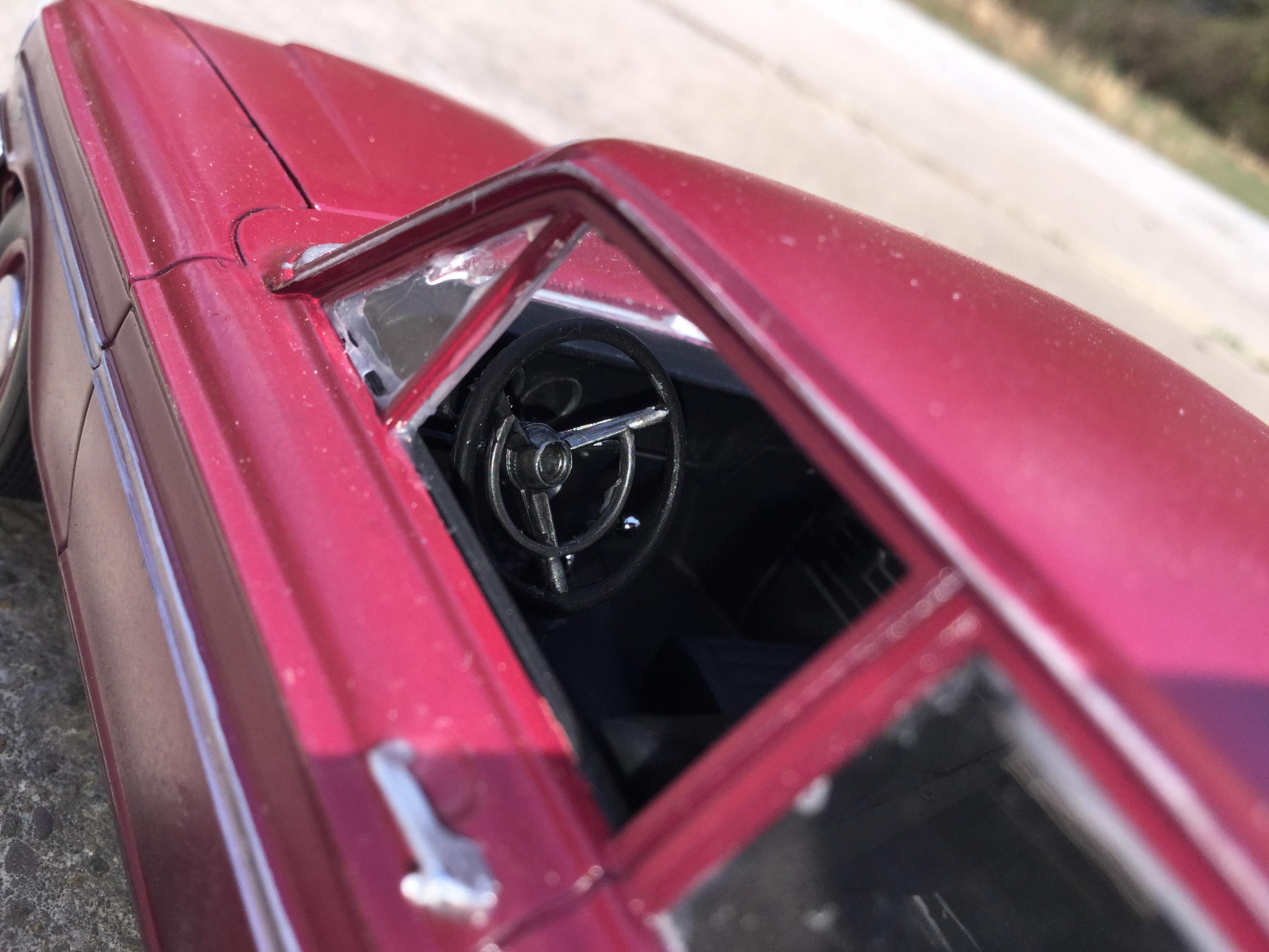

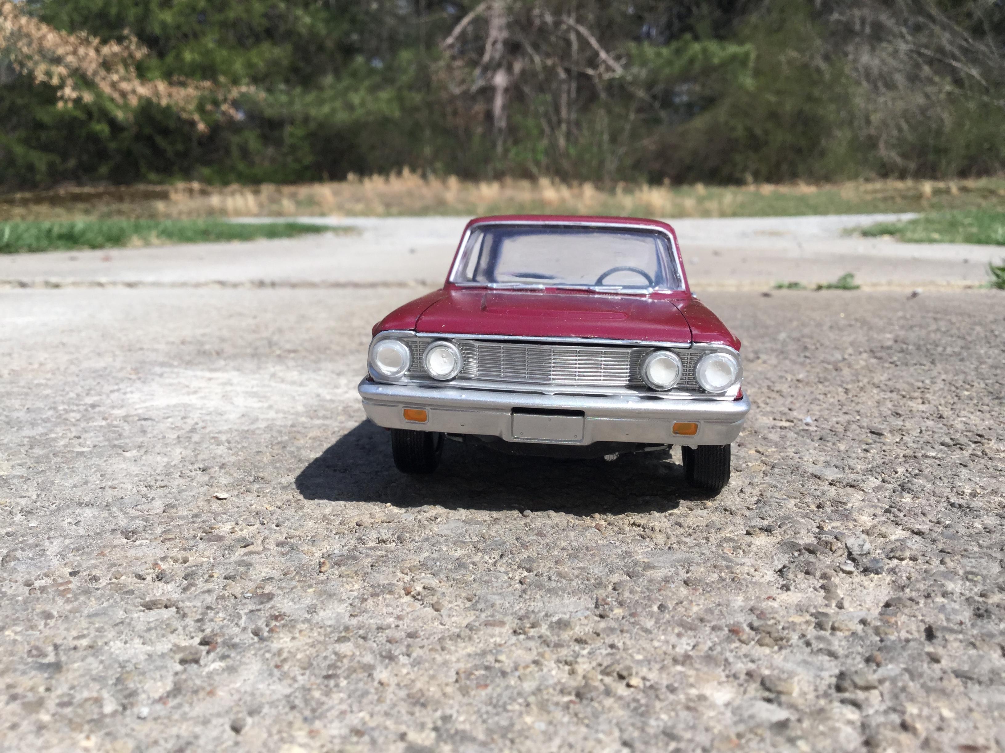

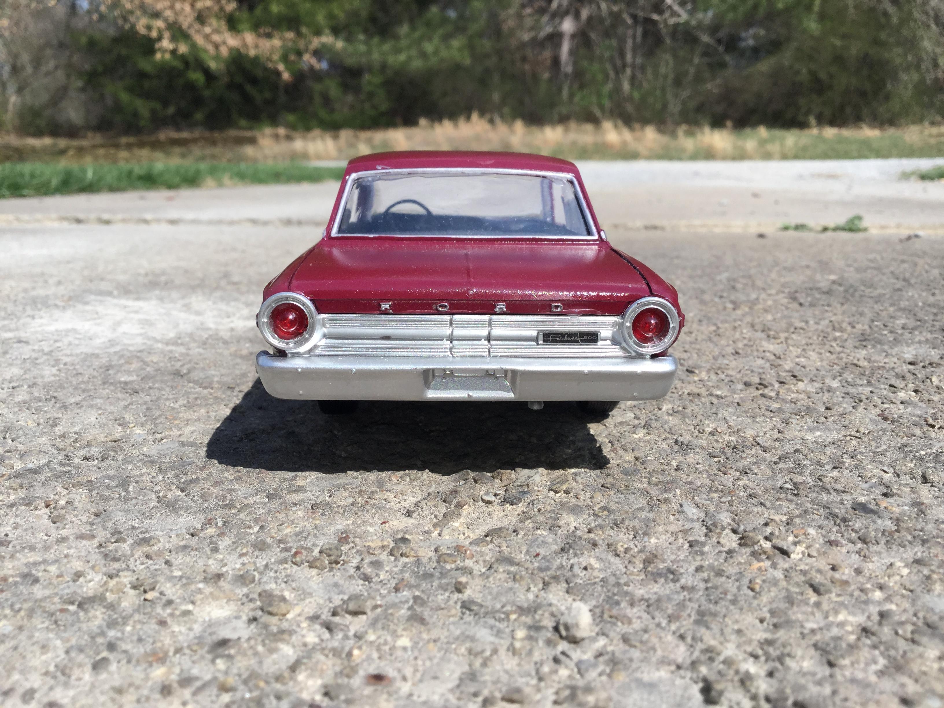

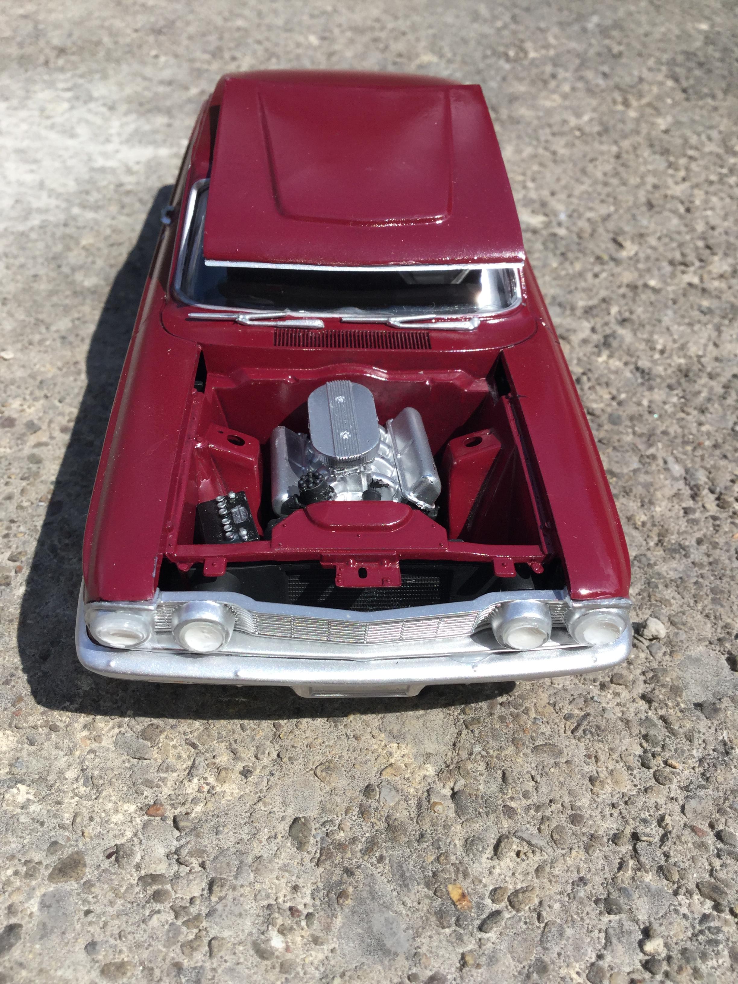

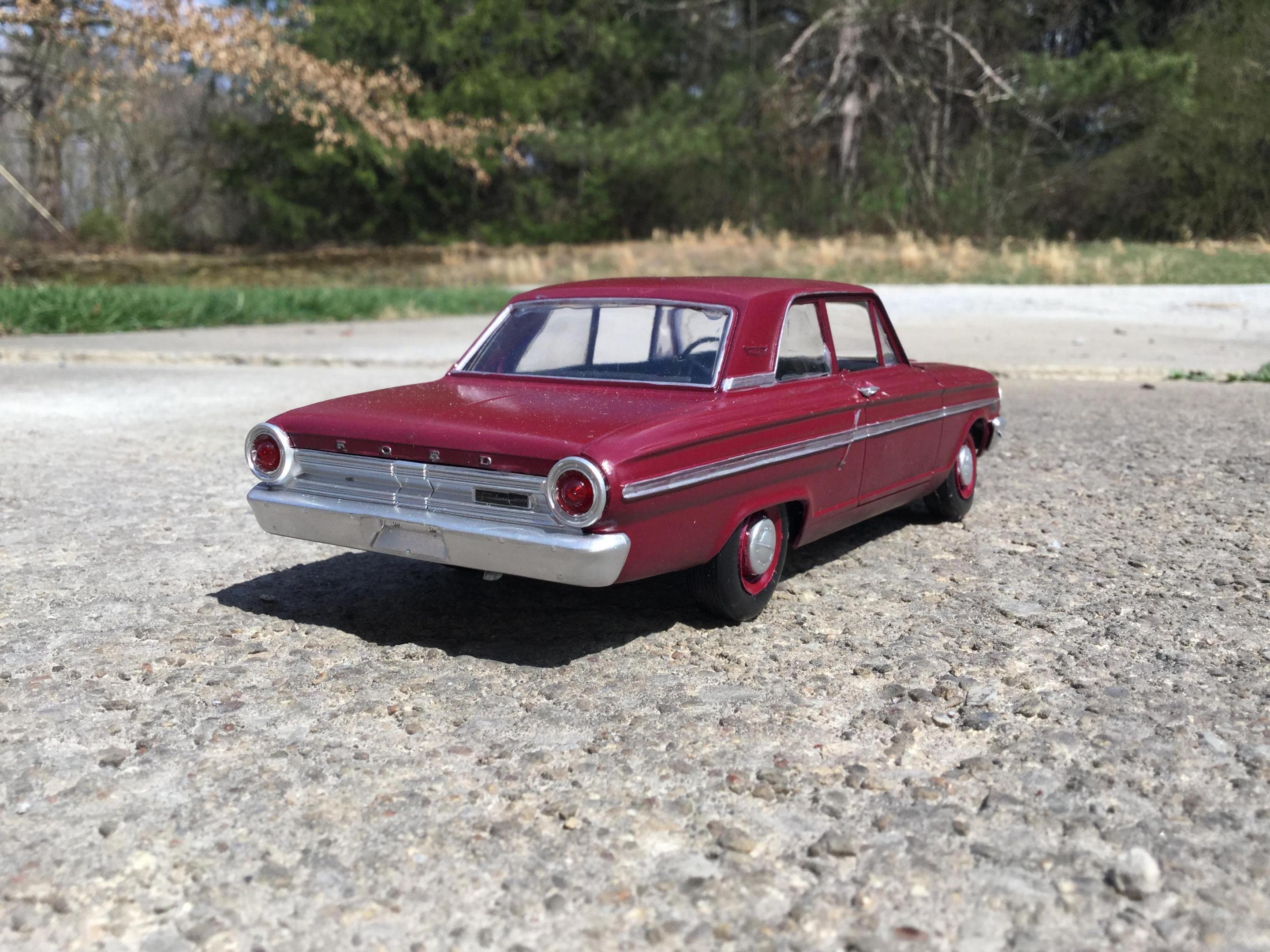

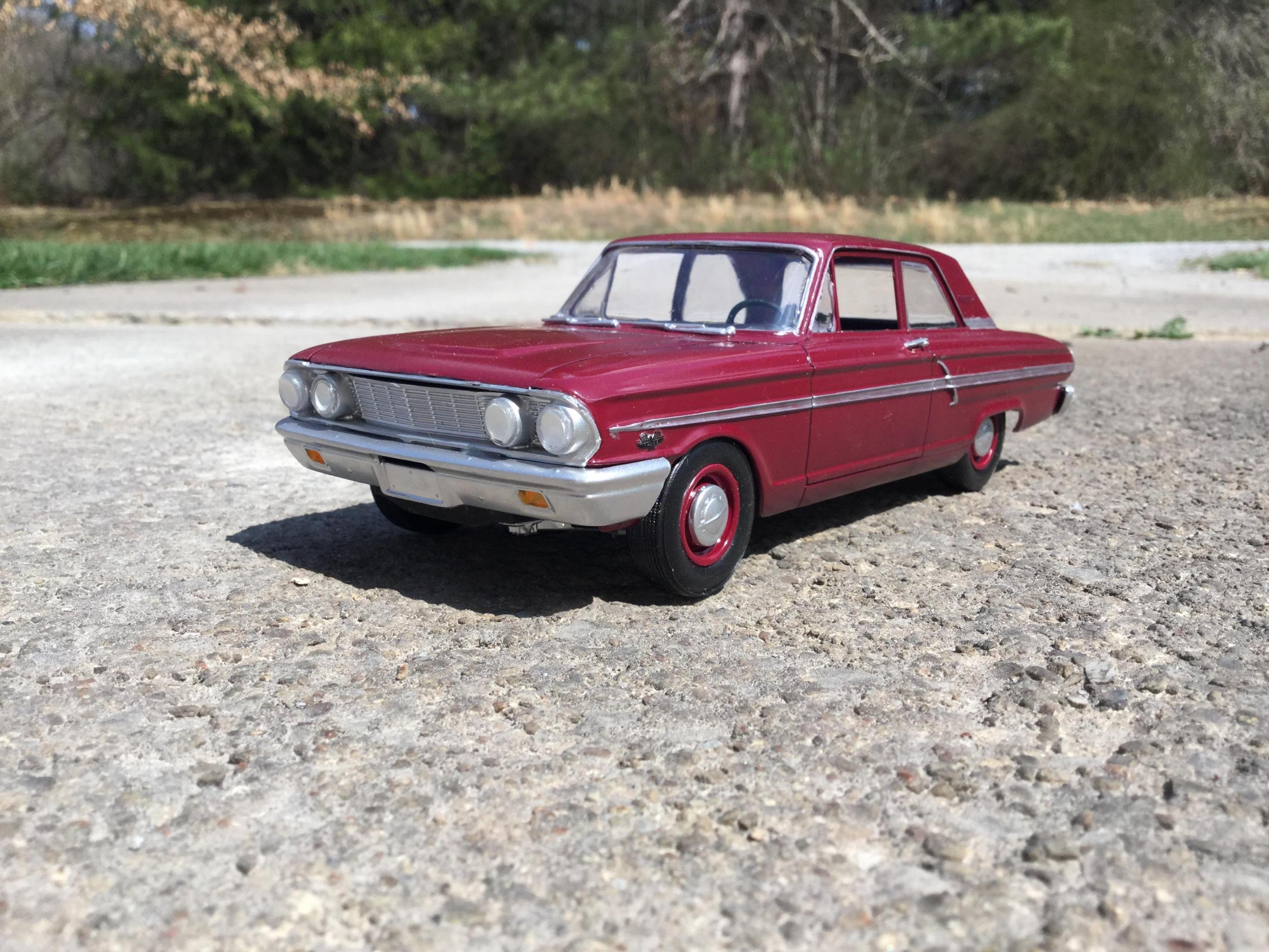

michelle Posted April 8, 2021 Posted April 8, 2021 (edited) i got this kit from classicgas and got the tail light lences for it from thomascoffey1959 i had alot of issues with parts fitting together right from two of the rims not fiting into the tires that i had to sand down the sides of to get to fit to the engine parts not fitting perfectly and the front suspension boke in two places the thin rod that connected the two sides snaped while i was triming it from the sprue and one of the rectangular shaped arms that attached to the chassis also broke i also had issues with the exhuast pipe fitting to the chassis and had to cut a portion of it away to get it to sit right and fit i also had to come up with another steering wheel from my parts box for it i painted it rust-oleum 2x ultra cover gloss cranberry also the glass did not fit the body very well it was like it was slighty to small in overal size Edited April 8, 2021 by michelle
Classicgas Posted April 8, 2021 Posted April 8, 2021 Your best yet. Good job. One question, where are the shock tower braces?
Hard_2_Handle_454 Posted April 8, 2021 Posted April 8, 2021 Looks great, I think it's one of your best yet.
michelle Posted April 8, 2021 Author Posted April 8, 2021 20 minutes ago, Classicgas said: Your best yet. Good job. One question, where are the shock tower braces? not with the kit parts if your talking about the support ams that attach from the inner wheel wells to the firewall Just now, Hard_2_Handle_454 said: Looks great, I think it's one of your best yet. thank you
bh1701 Posted April 9, 2021 Posted April 9, 2021 I agree with the others - this is one of your best builds yet. Congrats! Bart

thomascoffey1959@gmail.com Posted April 9, 2021 Posted April 9, 2021 How did I miss this ? outstanding Michelle ! beautiful.

bisc63 Posted April 9, 2021 Posted April 9, 2021 Well done; a very clean build. Love the sleeper look.
David G. Posted April 9, 2021 Posted April 9, 2021 Good looking build, looks like it was worth the hassle. I can't tell you how many times I broke a delicate part while cutting it from the sprue. It's a pain in the neck, that's for certain. I'm not sure what you use to remove parts from the sprue but I imagine you probably use some type of sprue cutter. They're great tools and I have several that I use but for some of the finer parts they're just too big and clunky. A few years ago I discovered a great tool for separating those teeny-tiny parts from the sprue. It's a set of photo etch craft saw blades from Tamiya. They're available through most online hobby retailers These do have to be cut out and folded for use but they're great for cutting those tiny parts loose without damage. If you're not up for cutting and folding then Micro Mark has a version that looks like it can be used "right out of the box" so to speak. Micro Mark Ultra Fine Saw Blade I haven't tried these so I can't speak to their suitability but I'm guessing that they're about the same size as a single edge blade so they should work well. And they're from Micro Mark so they will be useful for something. Best regards, David G.

Hi-Po Posted April 9, 2021 Posted April 9, 2021 I have to agree with all of the others - your best job to date. To separate parts from the sprue, I use either of two sprue cutters, a Despruing Tweezer - #82393 or a Professional Sprue Cutter -#84386, both from Micro Mark. I have also used the micro saw blades that David G. speaks of with satisfying results. Any of these products I highly recommend. If you have a Hobby Lobby or Michael's close by, you might check out their jewelry making department for wire cutters. They offer many styles that compare to the to ones offered by Micro Mark.

kruleworld Posted April 10, 2021 Posted April 10, 2021 it still come out looking good. i like the dog-dish wheels and color is awesome.
