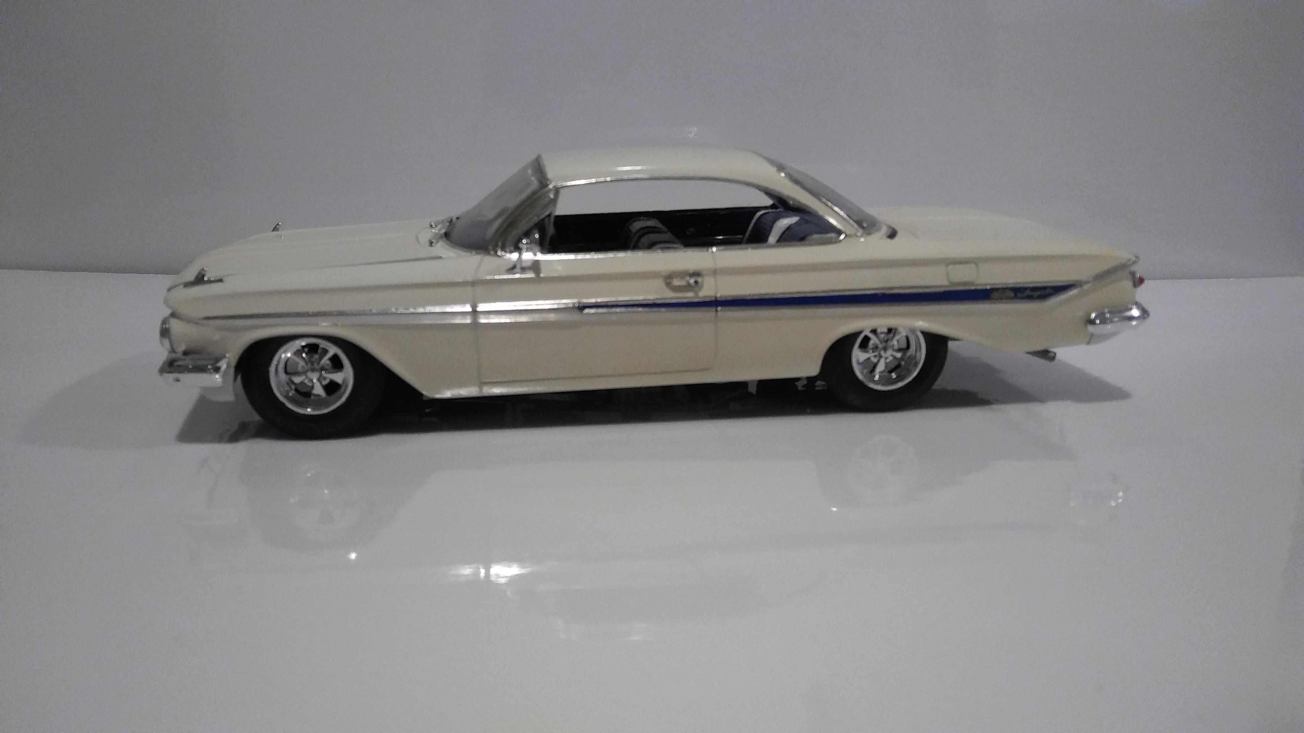

Exotics_Builder Posted April 16, 2021 Posted April 16, 2021 (edited) 6 hours ago, Classicgas said: Another option is white decals. I had white decals that I used to do this one some years back. Did the BMF, then the white decals followed by the emblem decals. Edited April 16, 2021 by Exotics_Builder

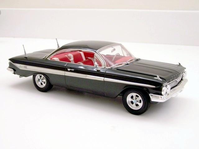

Wm David Green Posted April 16, 2021 Posted April 16, 2021 Some nice photos here. I have the old and new boxings of this kit, so I'm just waiting for inspiration.

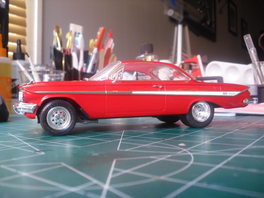

Brutalform Posted April 17, 2021 Posted April 17, 2021 (edited) If leaving the insert as bare plastic, at the very least I’d clear coat it. Down the road, the plastic might yellow a bit, and the clear will keep it white. Also, if you clear the rest of the car, it will match, and not have a satin finish. For this car, I masked around the insert, then painted it Tamiya Pure White. After it dried, then I masked off the insert, and sprayed the rest of the car Tamiya Italian Red. Added the SS decals last. Sorry for the clarity, but this is an old pic. Edited April 17, 2021 by Brutalform
