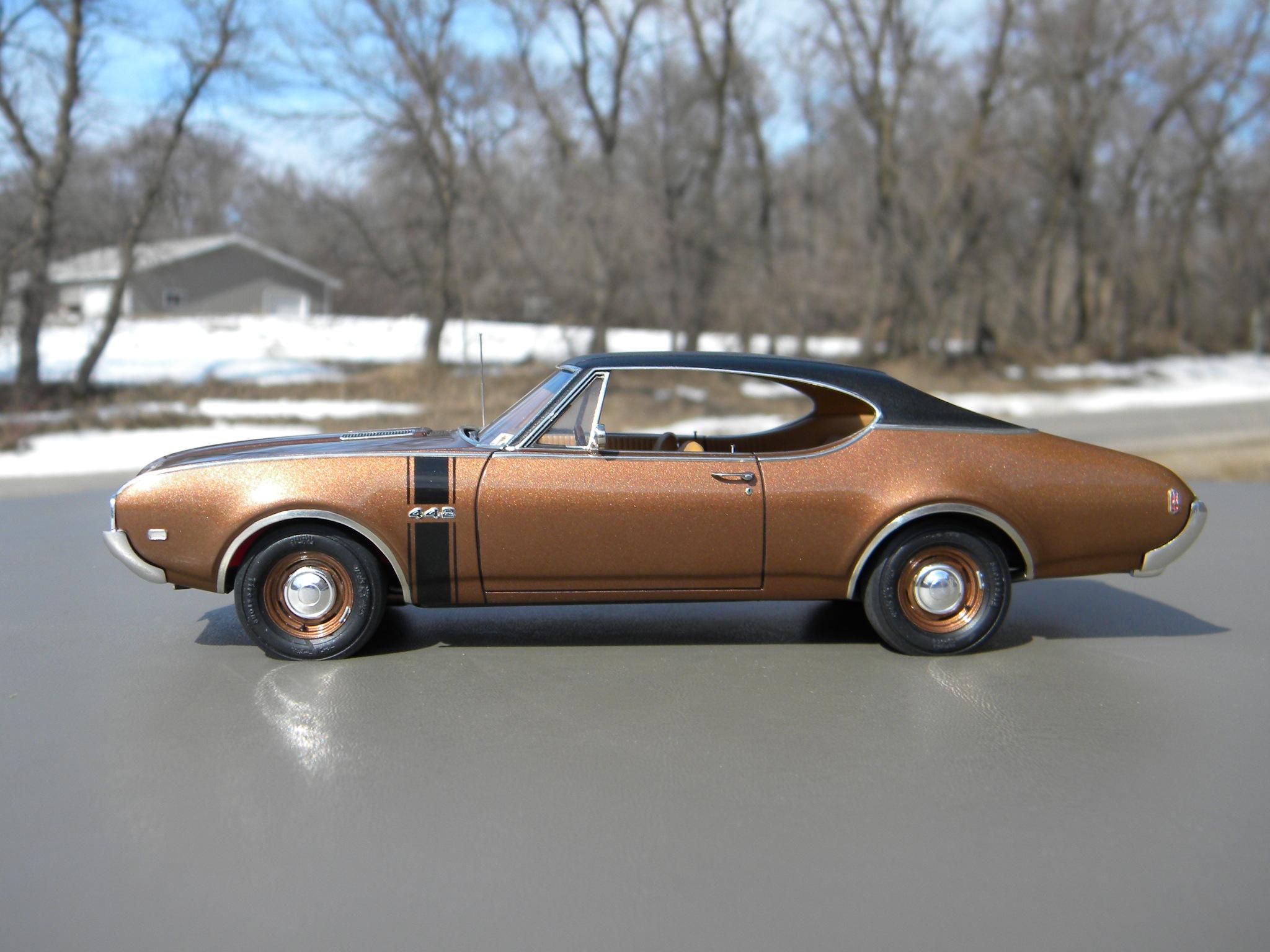

StevenGuthmiller Posted April 15, 2021 Posted April 15, 2021 This question pops up quite frequently. There are a number of ways to tackle the issue. I have tried darkening the panel lines before paint as mentioned above, but have had no luck with this technique, probably due to the fact that I use multiple coats of automotive type lacquers which can be very opaque and will cover up the color in the panel lines very quickly. Deepening the panel lines by scribing is a technique that I will try in the near future, but it will remain to be seen whether it will produce the desired affect with the paint regimen that I use. For quite some time, I have been darkening the panel lines at the final stages of the build with acrylic craft paint with fairly good results. Not the optimum solution I suppose, but it works pretty well in most instances. I agree to an extent that black looks too stark on a lighter colored car, but I believe this has much more to do with the width of the panel line, and less to do with using black to do them. You frequently will hear the argument that black looks out of place, but if you look at the panel lines on the average 1:1 car, you will see nothing but black in the recesses, but the lines are very thin making them look as you would expect. In any event, I usually will use a darker shade of the body color to mitigate the starkness of the panel lines. But again, all panel lines are black. It's just that most models have too wide of a gap between panels for black to look correct. Steve

StevenGuthmiller Posted April 15, 2021 Posted April 15, 2021 17 minutes ago, TransAmMike said: The panel lines on the 4-4-2 look perfect Steve, especially when comparing them with the real one pictured but which technique was actually used on it? In this case, a dark brown wash of acrylic craft paint was flowed into the panel lines and then cleaned up around the edges. That is another recommendation that I can offer. If you do use a wash at the end, it's a good practice to not just wipe the surface clean, but to try to clean at least a little way down into the panel line to expose the door and fender edges a little bit. Not always easy to do depending on the depth of the line, but it will help make the line appear "less heavy". Steve
