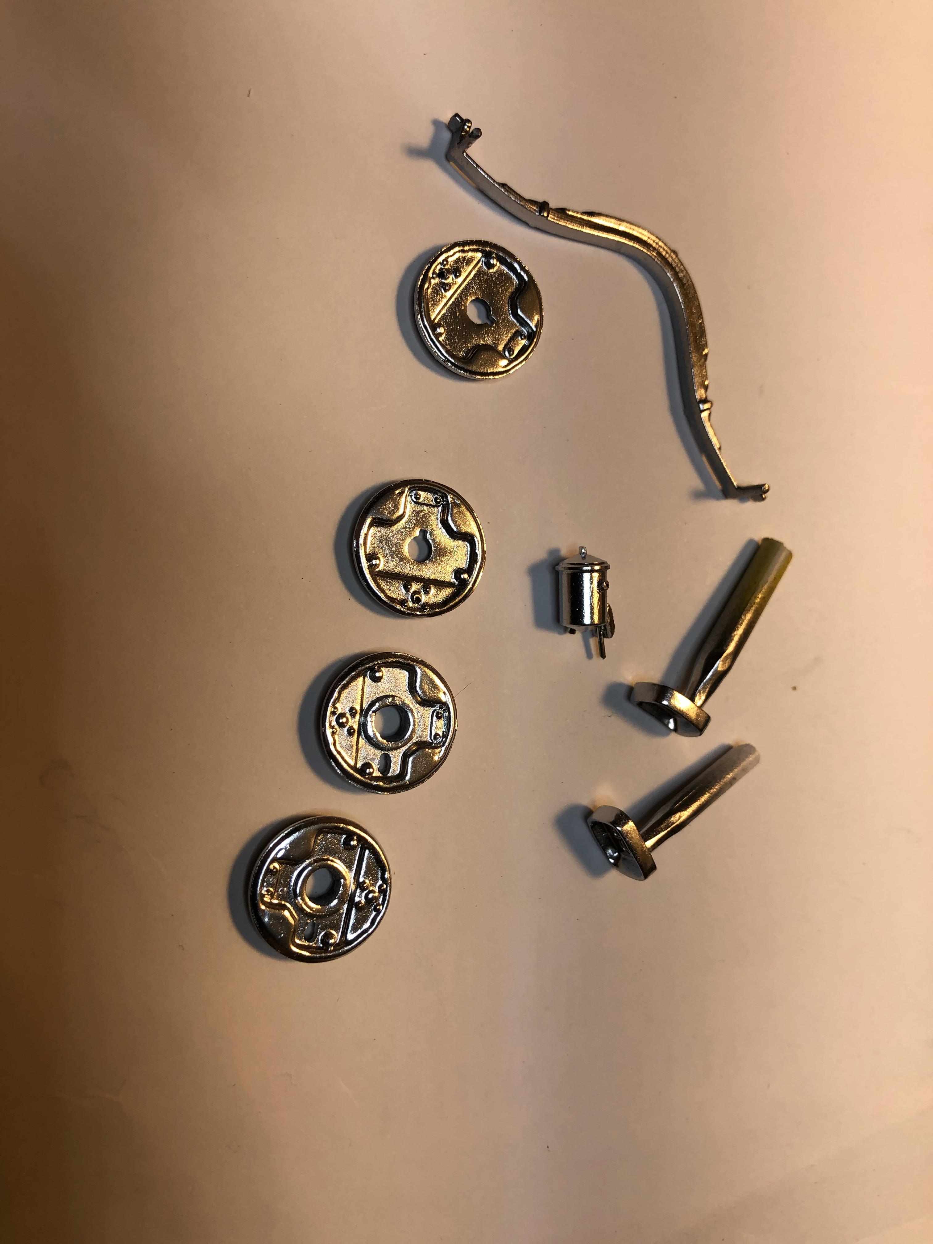

bill-e-boy Posted May 21, 2021 Posted May 21, 2021 Further to my post above I sprayed some Molotow a couple of nights ago and below is the result Thinned 100% with lacquer thinners and spent 24hrs in my hot box. The results are very good. most of these items had been painted with Alclad a long time ago and the finish was below what I was after so I reprayed with Molotow. The is one new part which is the flathead oil filter In real life they are not as dark as in the photo
