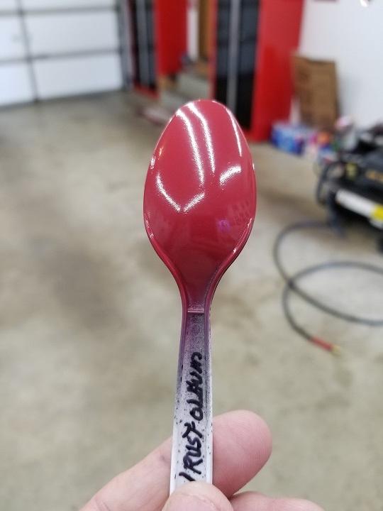

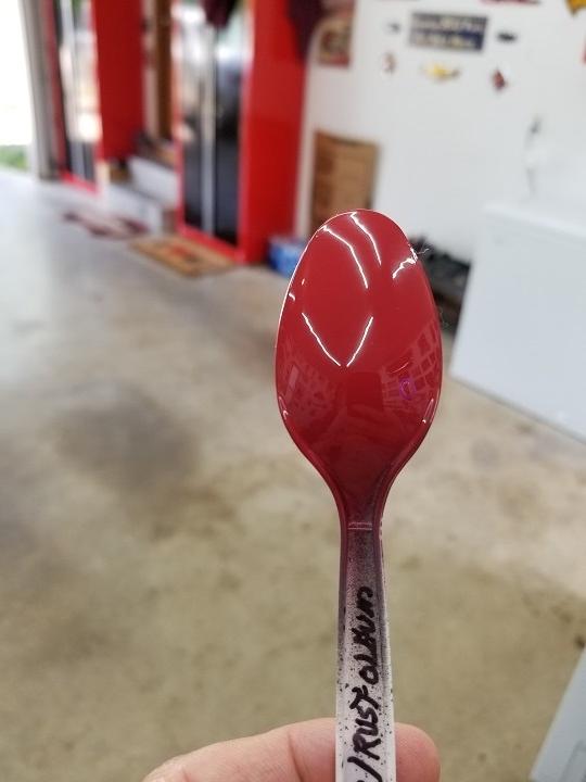

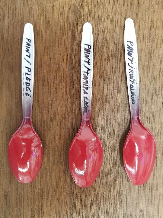

Zippi Posted April 26, 2021 Author Posted April 26, 2021 (edited) Ok....did a little testing this morning. I had 3 spoons primed (rattle can) from yesterday with Rust-Oleum flat gray primer. Here is the 3 test I performed. I took 2 pics of the spoons after paint only inside the garage and outside in the sun. The same with the paint-gloss pics. Tell me what you fellows think about which finish coat looks the best. I'm pretty sure I know which one I'm going to use. Note: The last 2 pics are with the finish coat. 1) Spoons primed with 1 coat of Rust-Oleum 2X Ultra flat gray primer and sat for 24 hrs. 2) I thinned the Anita's Glossy Red paint with Windex 50/50 and mixed. 3) I airbrushed all 3 spoons with 2 light coats then 2 medium coats letting it flash between coats an let the parts set for 30 min covered with a plastic tub. 4) The last 3 coats were heavy to make sure I was getting enough paint on the spoons. 5) I let the parts set for 30 min and airbrushed one spoon with Rust-Oleum 2X Gloss Clear, one spoon with Tamiya Clear, and the 3rd spoon with Pledge Revive it. Each spoon was sprayed with 3 medium/heavy coats with a flash time of 2 min between coats. 6) 20 psi while airbrushing the paint and 18 psi when airbrushing the Pledge and Tamiya Clear. 7) The Pledge was not thinned for airbrushing but the Tamiya Clear was thinned with lacquer thinner 50/50. Edited April 26, 2021 by Zippi
Zippi Posted April 26, 2021 Author Posted April 26, 2021 (edited) Update. I was initially thinking the painted spoon with the Rust-Oleum Gloss had the least shine so I thought, what the hell, it's been about 20 min so lets shoot it reallllllllly heavy and see what happens. Man oh man does it now look better than the other 2 plus it can still be wet sanded but that's something I'm still experimenting with. If this looks as good tomorrow I think that's my huckleberry. These 2 pics were taken about 5 min after they where sprayed. Edited April 26, 2021 by Zippi
peteski Posted April 27, 2021 Posted April 27, 2021 (edited) I'm glad that you tried it. We all kept telling you - no misting-on the paint - you need to lay it on heavy to allow the liquid paint to spread out and level itself. Like I said, I don't sand/wax/polish my paint jobs. They are glossy enough. So many modelers don't seem to understand that, and end up with orange-peel finishes. But you you also have to be mindful that if you go overboard on the heavy coat, you risk runs. Doing it just right is something you'll learn with experience. Edited April 27, 2021 by peteski

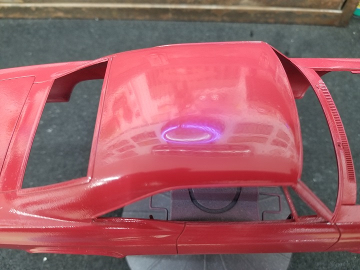

Zippi Posted April 27, 2021 Author Posted April 27, 2021 I got my test body painted earlier and I tried to repeat the process that I used yesterday on the spoons. Today was probably not the most ideal day to be airbrushing as the winds were gusting 20-30 mph. I stood at the back door of my garage spraying when the wind would let down. It came out better than I thought it would and nothing blew onto the paint. The paint has just a little orange peel but nothing really bad. I'll let this set for a couple hrs and then shoot the Rust-Oleum Gloss. I also polished the spoon I cleared yesterday. It's a little darker than yesterday and looks like it may have lost a little of the wet look but still not to bad. Like my granddaddy use to say....hope for the best and expect the worst.
Zippi Posted April 27, 2021 Author Posted April 27, 2021 (edited) Ok I got 4 good coats of the Rust-Oleum Gloss sprayed on the test body. The paint has some orange peel so once the Gloss cures we'll see if wet sanding with help it out any. It looks a little on the rough side. These pics were taken about 5 min after it was sprayed. I don't know.....I may have to start over and pick a day that's not so windy. Edited April 27, 2021 by Zippi

Zippi Posted April 28, 2021 Author Posted April 28, 2021 8 hours ago, Tim08 said: I used the turtle wax clean cut rubbing compound on the camaro body I'm working on right now...looked a little like that... Takes a little elbow grease to rub it out, but it looks pretty good. I'm going to try and wet sand a few area's this morning with 2000 thru 12000 and see what happens. If it doesn't turn out decent it's going for a bath. Keep in mind fellows that this is a test body so I'm trying different things to see what happens. This way I'll know what NOT to do next time. I'm stripping the body not matter what becasuse I didn't sand all the mold lines out and this is not the color I want for the 65 Impala anyway.

Zippi Posted April 28, 2021 Author Posted April 28, 2021 (edited) I will try that next time Rick. Ok fellows, I spent about 10 min this morning wet sanding the top of the test body with 1000, 2000, 4000, 6000, 12000. After that I used Novus 3 Heavy Scratch Remover then Novus 2 Fine Scatch Remover, and I finished up with Meguiar's Liquid Wax. I gotta say, it took out 95% of the orange peel and it looks pretty good. Now I'm not saying that it's perfect but it's a hell of a lot better than what is was. So....I guess the moral of the story is if you paint your model and you get a lot of orange peel all is not lost. At least for me. I have 2 pics that clearly show the before & after results. Let me hear the comments on the process I used fellows. I also bought a couple bottles of the Isopropyl Alcohol to strip the body once I'm finished testing. I looked at the purple stuff but what I read said it smelled pretty bad so I opted not to use it. If the wife gets a sniff of something bad in the garage she will crack down on me ☺ Edited April 28, 2021 by Zippi
