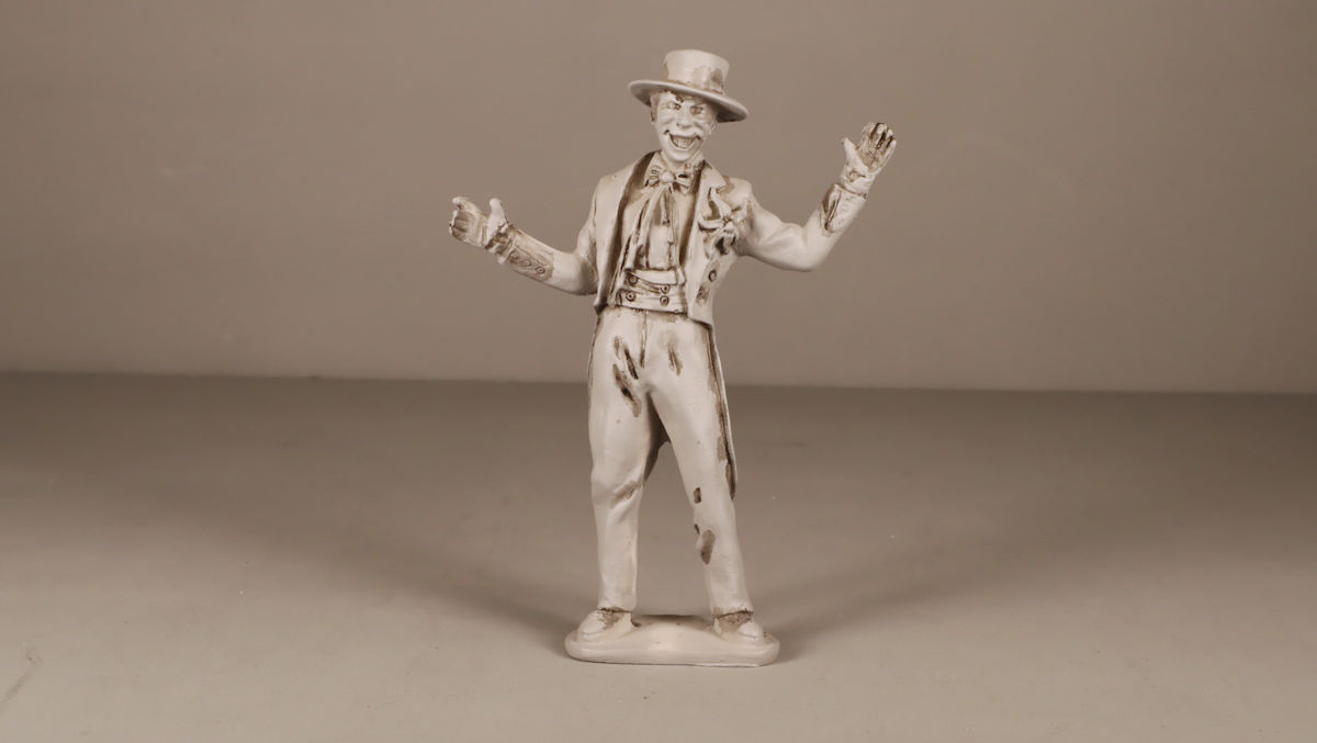

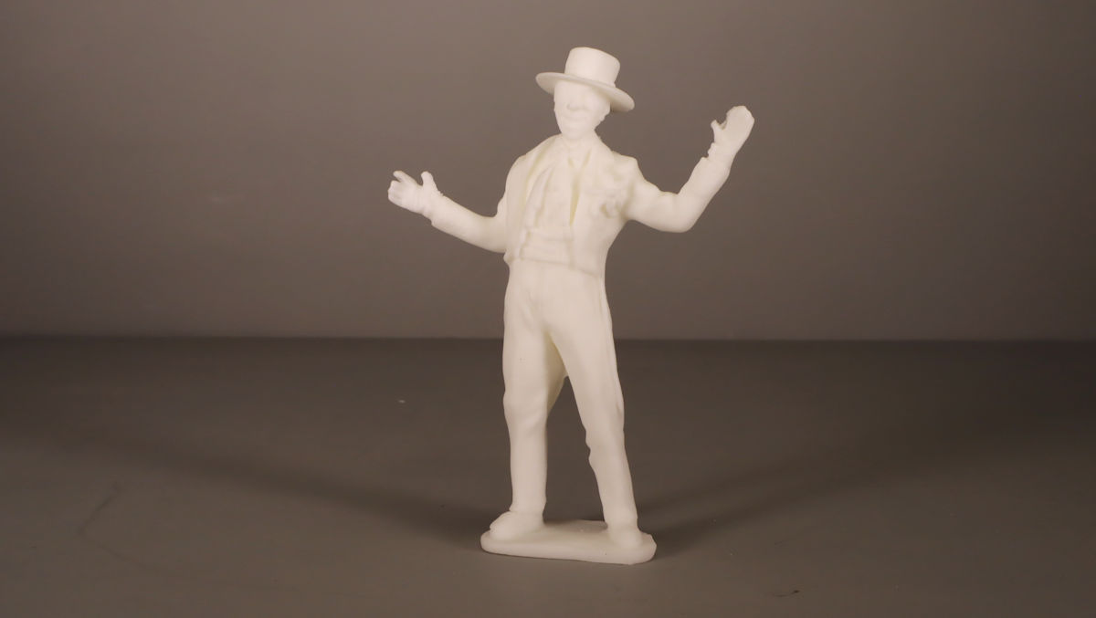

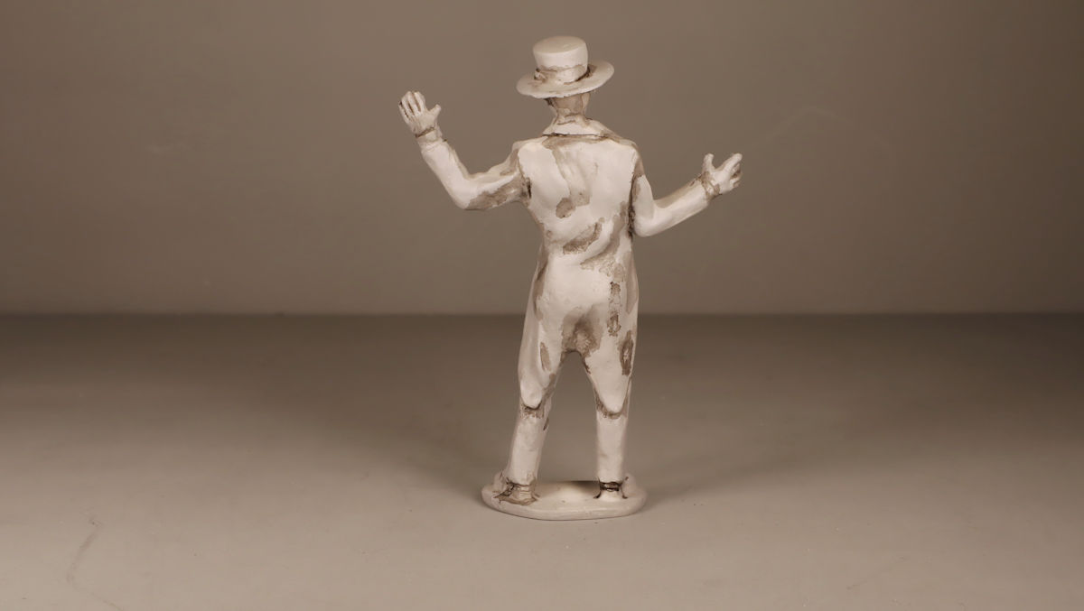

David G. Posted April 27, 2021 Posted April 27, 2021 (edited) Hello All. This is my first time painting a figure and my first time working with resin so any tips and hints will be appreciated. I'm making this as a companion to the 49 Mercury Joker-Mobile that I recently completed. I bought the figure on line, it was originally offered as a part of this kit. Here's the starting point. And here we are all cleaned up, primed and shaded. I'm working out the colors now an I plan to start painting soon. Thanks for stopping to look and as always, please feel free to comment. David G. Edited May 25, 2021 by David G.

Marcin M. Posted April 30, 2021 Posted April 30, 2021 Cool figurine. What paints do you have? Acrylic are better, they're drying faster. You should also think about making a wet palette, because straight from the jar they are too thick. Do not paint everything at once, better more thinned layers, like one thick one. Wet blending will work here Shading with washem doesn't make much sense at this stage. Perhaps it would be better to primer the figure with black in its entirety and gray with a 45-degree angle. Then you would have the shadows marked. I watch with interest, finally some figure SBS.
David G. Posted May 1, 2021 Author Posted May 1, 2021 On 4/30/2021 at 5:42 AM, Marcin M. said: Cool figurine. What paints do you have? Acrylic are better, they're drying faster. You should also think about making a wet palette, because straight from the jar they are too thick. Do not paint everything at once, better more thinned layers, like one thick one. Wet blending will work here Shading with washem doesn't make much sense at this stage. Perhaps it would be better to primer the figure with black in its entirety and gray with a 45-degree angle. Then you would have the shadows marked. I watch with interest, finally some figure SBS. Thank you for taking the time to offer some tips Marcin. By the time I got to read your suggestions I had already started painting but your pointers reinforce what I discovered. For paints I have one old Model Master acrylic for the lavender on the trousers and gloves, the rest are Tamiya acrylics. I did do a little thinning of the paints but found myself using more of a drybrush technique intending multiple coats. The shading was as much so I could see what I was painting as anything else. It did impart a little depth but as you suggested, it seems that additional paint coats will obscure most of it. In addition to a light blackwash, I plan to use tints of my base colors for highlight and shadow. I really do like the idea you offered regarding the use of primer to build light and shadow. I hadn't thought of that and it's a wonderful idea that I plan the use in the future. I hope to get some photos of the base colors today or tomorrow. I'm pleased with the results so far. And thanks again for taking the time to offer some pointers. David G.

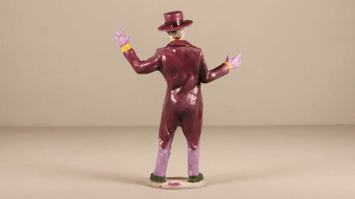

David G. Posted May 2, 2021 Author Posted May 2, 2021 Hello All. Here's most of the first color coat. I still have the shoes, flower, face and hair to do. I had to mix the color for the coat. I'll take care of the gloss at the end with an application of Dulcote. As always, thanks for taking the tine to look and please feel free to comment. David G.
David G. Posted May 6, 2021 Author Posted May 6, 2021 Okay, I got some shadow and highlight painted. I know that the coat is still glossy, Dulcote will be one of the last things apply. As always, thanks for taking the time to look and please feel free to post any comments, tips or advise. Thanks, David G.

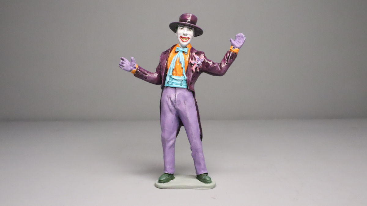

David G. Posted May 12, 2021 Author Posted May 12, 2021 Hi Everybody. Here is the next phase... the face. And some more fine tuning on the detail painting. Speaking of fine tuning, I'm finally getting the lighting dialed in. I went from two 100 Watt LED lamps in reflectors to two 40 watt LED lamps. I think the color is much better. It seems that regarding light, less is more. As always, thanks for looking and please feel free to comment. David G.

slusher Posted May 13, 2021 Posted May 13, 2021 impressive painting David, I looking for paint and colors for mine. What did you use..
David G. Posted May 14, 2021 Author Posted May 14, 2021 19 hours ago, slusher said: impressive painting David, I looking for paint and colors for mine. What did you use.. Thanks Carl, detail painting is one of my favorite parts of building. There aren't a lot of photos out there for this particular version of the Joker so I just tried to replicate the box art. There's no need to limit yourself to that as there are many iterations of the Joker character. Most of them use contrasting secondary colors, shades of violet, orange and green. Having said that, here is what I used. For the trousers and gloves I used Model Master Napoleonic Violet. The shirt is painted Tamiya X-6 Orange and the ascot in Model Master Turquoise. The coat is a mix of Tamiya X-16 Purple and X-7 Red, probably about 60/40. Regards, David G.
David G. Posted May 22, 2021 Author Posted May 22, 2021 Hey Yuns Guys, here's the next update. I think I'm done with this one. Overall I'm pretty happy with it as it is but I'm trying to decide if I want to try to clean up the eyes just a little more at the risk of messing them up or just Dulcote it and call it done. (Opinions and advice are welcome.) Of course the Dulcote will remove the shiny on the coat and hat. As always, thanks for taking the time to look and please feel free to offer advice and comments. David G.
David G. Posted May 23, 2021 Author Posted May 23, 2021 17 hours ago, GLMFAA1 said: I'd call it done greg Yeah, I'm seriously leaning in that direction. Thanks for the input. David G.
slusher Posted May 23, 2021 Posted May 23, 2021 David I would call it done. You did a wonderful job on yours. I have a question friend. What primer did you use?
David G. Posted May 24, 2021 Author Posted May 24, 2021 19 hours ago, slusher said: David I would call it done. You did a wonderful job on yours. I have a question friend. What primer did you use? Thanks Carl. I went ahead and finished it up yesterday afternoon. I plan to get some photos for posting today. The primer I used was Dupli-Color white sandable primer. David G.
