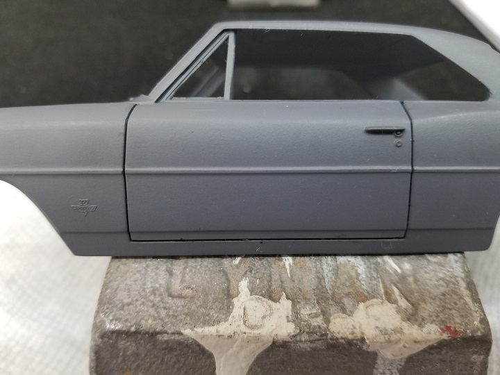

Zippi Posted May 2, 2021 Author Posted May 2, 2021 (edited) I cleaned up the body pretty good so I could spray it with Rust-Oleum flat primer this morning. Now I can see a few more area's that need to be cleaned up. Also got the distributor drilled out and plug wires glued in. Edited May 2, 2021 by Zippi
Snake45 Posted May 2, 2021 Posted May 2, 2021 That body has a couple nasty molding lines but looks like you got them off. Drive on!
Zippi Posted May 2, 2021 Author Posted May 2, 2021 3 hours ago, Snake45 said: That body has a couple nasty molding lines but looks like you got them off. Drive on! Yeah...at the rear of the side windows. It was pretty bad.
Snake45 Posted May 2, 2021 Posted May 2, 2021 Since you want it in gray, I'd start laying on the Rustoleum clear lacquer right over that nice even primer. Six to ten coats should do it--my bet would be eight.

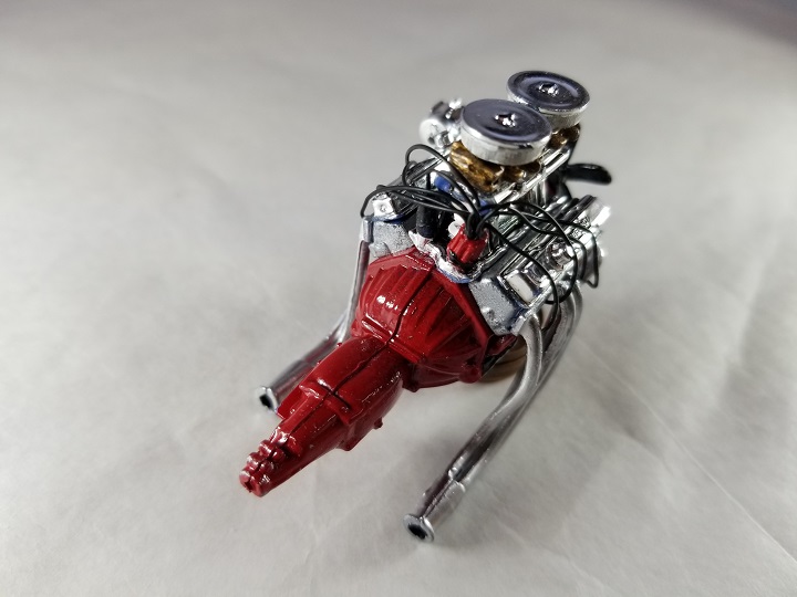

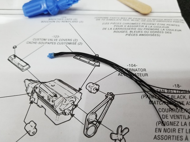

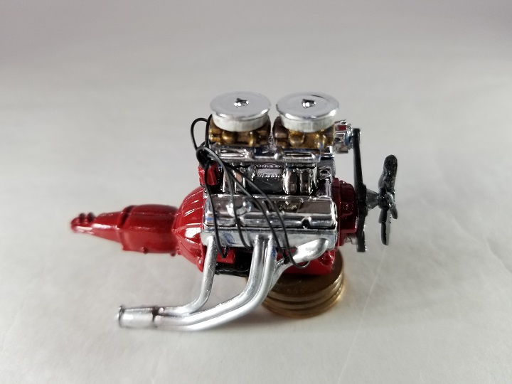

Zippi Posted May 11, 2021 Author Posted May 11, 2021 I got the engine put together. I always seem to have a problem after drilling the holes in the heads of getting the plug wires to stay in the holes. I end up getting more glue on the wire and head than needed. Then I have to go back and touch up the wires, heads, and headers. Anyone have a good way of getting plug wires to stay in?
espo Posted May 11, 2021 Posted May 11, 2021 The engine looks great. A thought on the plug wire holes in the engine. I will usually try the wire I'm using for the plug wires in the holes in my drill bit holder until I find the one that they just fit in. After painting the engine the wires will be real snug but you can use the bit to open the hole just enough for the wire to fit. Plug wires sizes can vary between suppliers so this has worked best for myself.
Zippi Posted May 11, 2021 Author Posted May 11, 2021 4 hours ago, espo said: The engine looks great. A thought on the plug wire holes in the engine. I will usually try the wire I'm using for the plug wires in the holes in my drill bit holder until I find the one that they just fit in. After painting the engine the wires will be real snug but you can use the bit to open the hole just enough for the wire to fit. Plug wires sizes can vary between suppliers so this has worked best for myself. Thanks for the info David.
TransAmMike Posted May 11, 2021 Posted May 11, 2021 4 hours ago, espo said: The engine looks great. A thought on the plug wire holes in the engine. I will usually try the wire I'm using for the plug wires in the holes in my drill bit holder until I find the one that they just fit in. After painting the engine the wires will be real snug but you can use the bit to open the hole just enough for the wire to fit. Plug wires sizes can vary between suppliers so this has worked best for myself. Ditto David. Usually for me at least the holes still wind up being too big. I use super glue so just a small drop on the end of the wire holds it in in a few seconds. And Bob, great looking engine my friend.?
Zippi Posted May 11, 2021 Author Posted May 11, 2021 2 hours ago, TransAmMike said: Ditto David. Usually for me at least the holes still wind up being too big. I use super glue so just a small drop on the end of the wire holds it in in a few seconds. And Bob, great looking engine my friend.? Thanks Mike. So....or you drilling just deep enough for the plug wire to bottom out in the head or through the head like I am?
TransAmMike Posted May 12, 2021 Posted May 12, 2021 17 hours ago, Zippi said: Thanks Mike. So....or you drilling just deep enough for the plug wire to bottom out in the head or through the head like I am? Usually thru the head and block. Just be sure the head is glued on good.

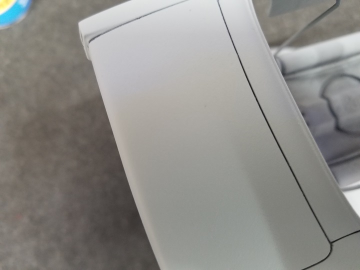

Zippi Posted May 12, 2021 Author Posted May 12, 2021 Ok.....I just painted the Chevy Nova body and hood with the Ceramcoat Bridgeport Grey inside my makeshift spray booth outside. It did a good job of blocking the wind and the paint seem to lay down a little better this time around. Got a little bit of trash that blew in on the body. Should I let it dry, sand, and spray another coat? The door gaps are still dark this time so I guess I scribe'd the gaps deep enough.
Snake45 Posted May 12, 2021 Posted May 12, 2021 Your door lines look better now. This is how you do it: Blacken the gaps before paint, and then leave them alone. For the future: Don't scribe the tulip pane lines (below the backlight) so deep, and don't darken them at all. This is a welded seam, not a movable panel, and should be seen as body color. Maybe you can still get some body color in there with a brush or something. Drive on!
