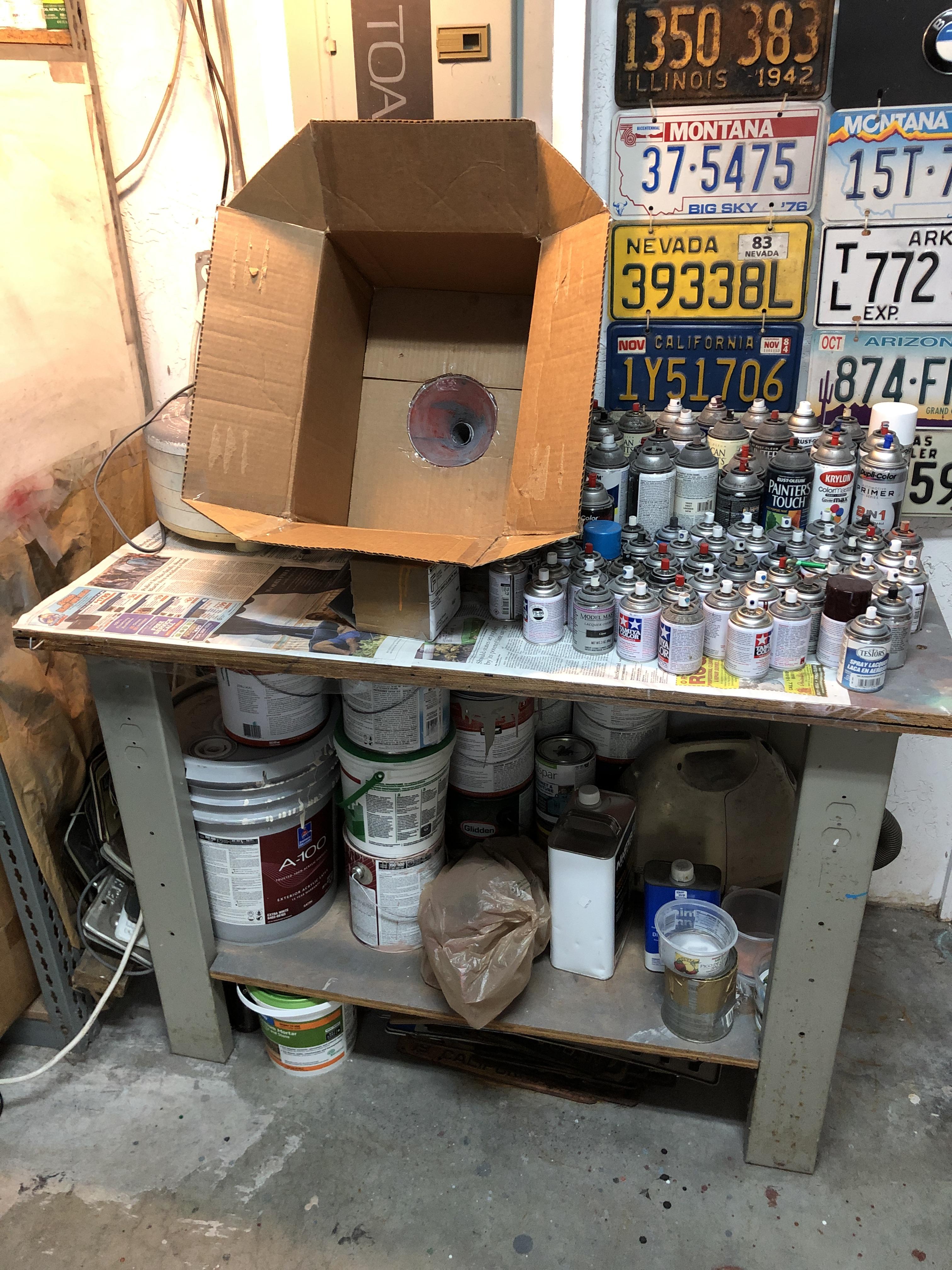

Rocking Rodney Rat Posted April 30, 2021 Posted April 30, 2021 Here's the worlds most 'Rube Goldberg' spray booth. I work in my garage and improvised this booth consists of a carboard box, a plastic funnel (with most of the small part cut off) and small vacuum cleaner to suck up the mist. It works. For awhile and and when it gets clogged up and gunked up, I tear it apart and start with a new box (shown here). With some scraping of overspray and a cleaning of the vacuum cleaner filter and I tape it together and start again. It's marginally better than getting everything in the garage covered with a fine coat of overspray.... -RRR
Zippi Posted April 30, 2021 Author Posted April 30, 2021 Nice RRR. Looks like the higher end cardboard box ☺ I like it. Where are all the lids to your rattle cans dude?

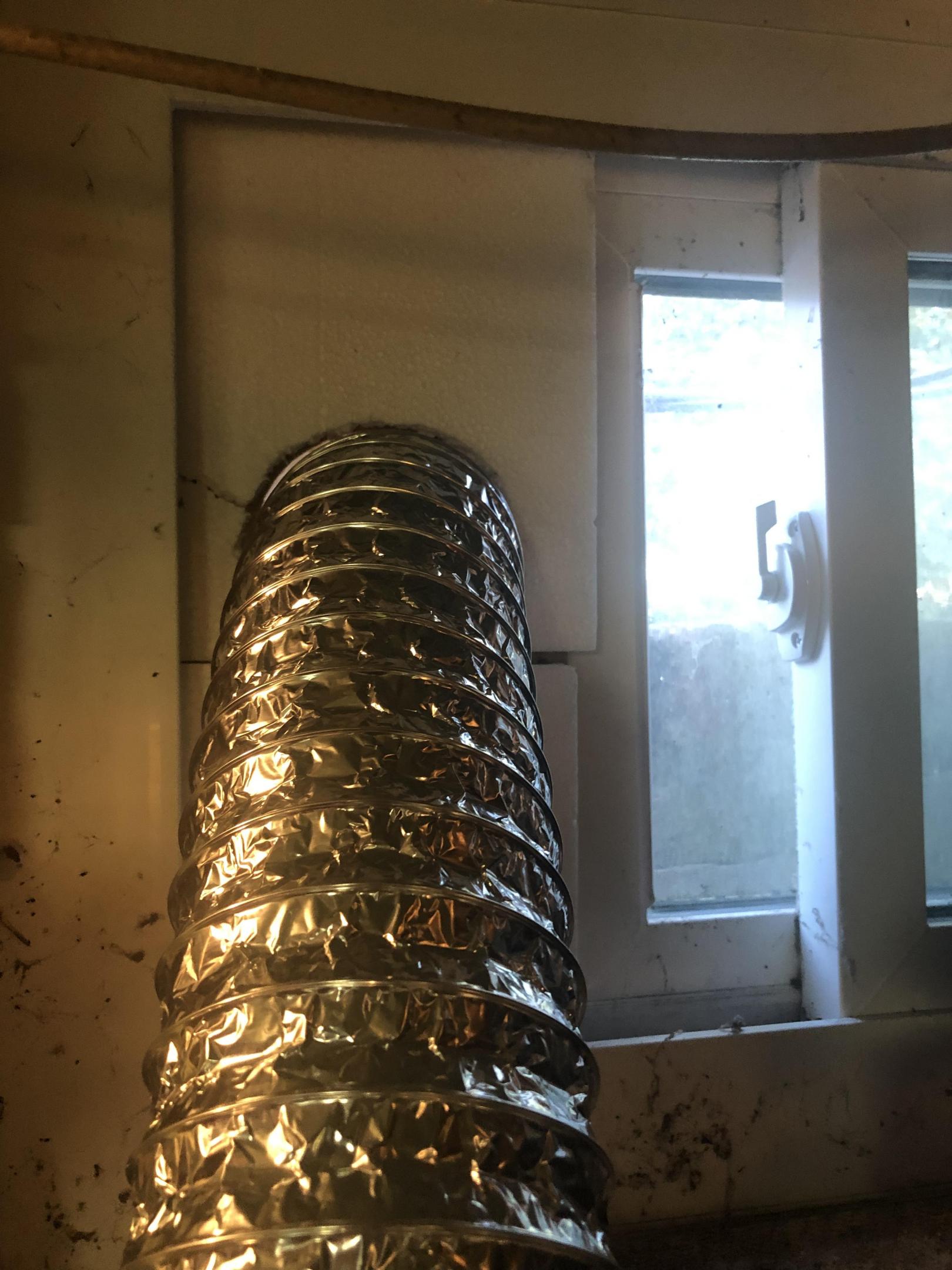

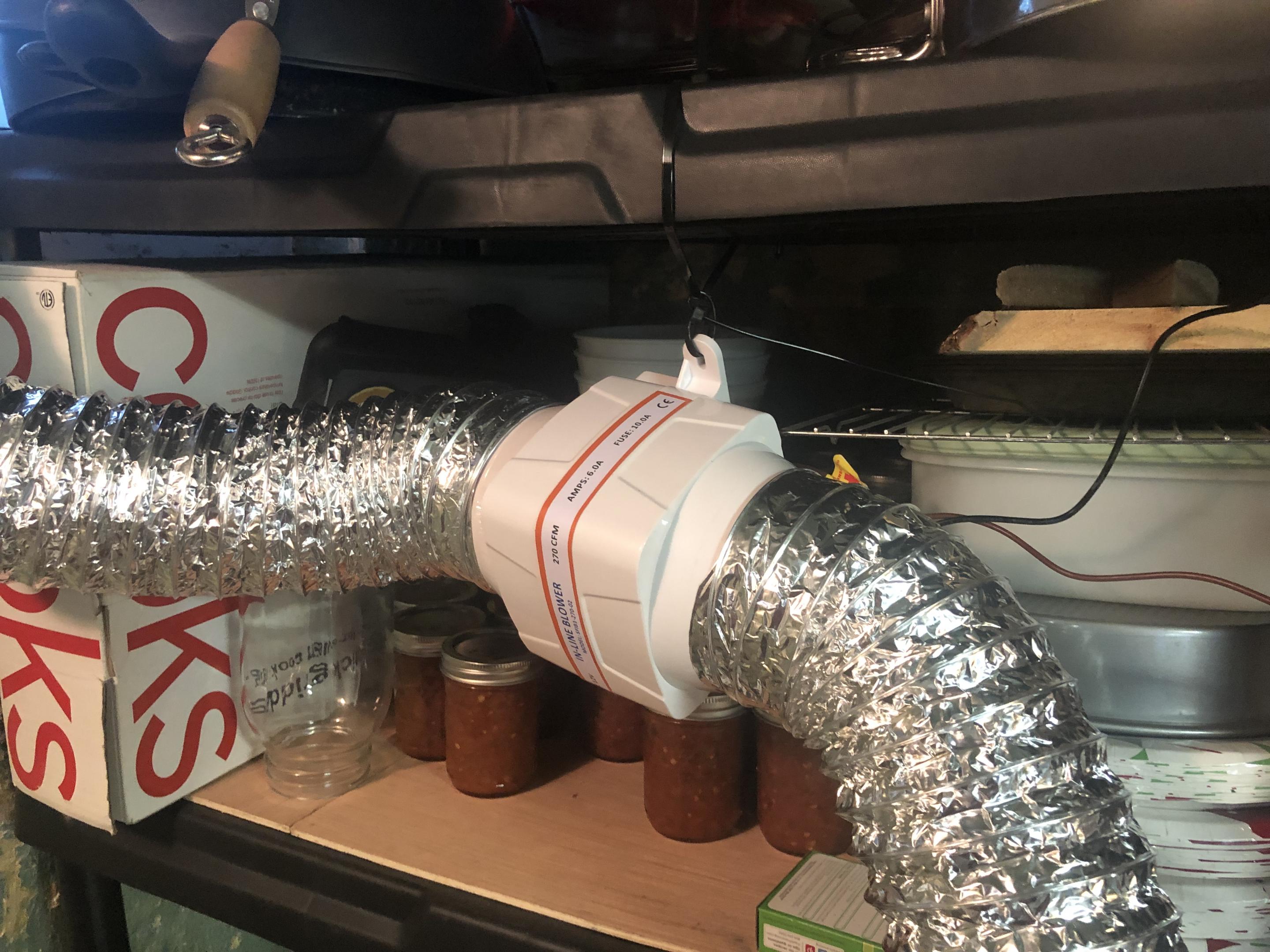

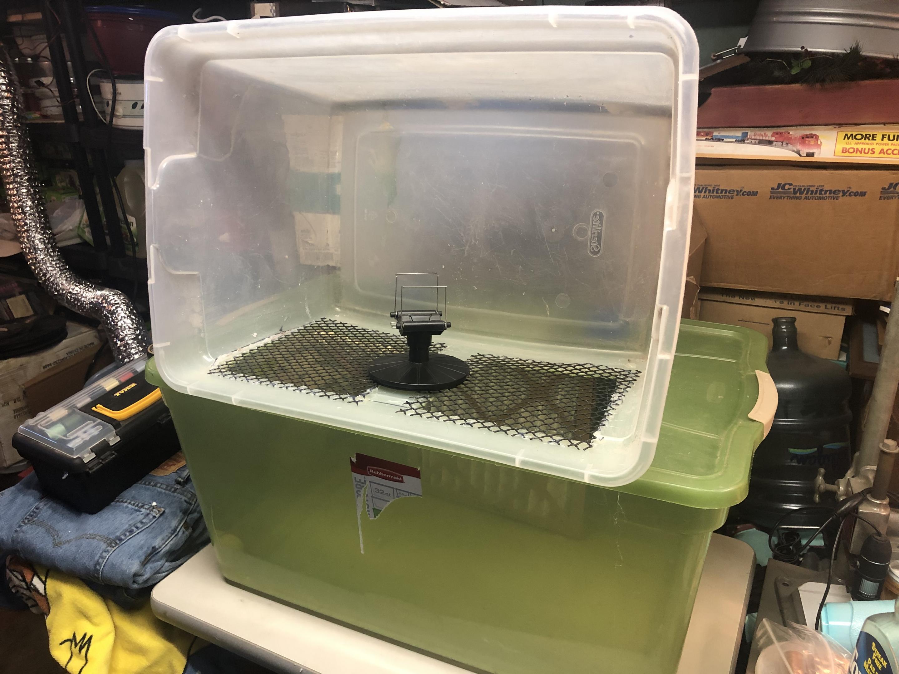

SCRWDRVR Posted April 30, 2021 Posted April 30, 2021 43 minutes ago, Zippi said: Where are all the lids to your rattle cans dude? I was wondering the same thing LOL.... My spray booth is 2 plastic totes glued together with a filter and vent out the back of the bottom tote. I have a bilge fan hooked on it and vent it out the window. If I would have mounted some stuff differently it could definitely be portable.
