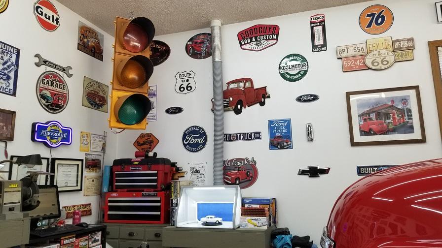

Zippi Posted April 29, 2022 Author Posted April 29, 2022 I have my new spray booth set up and vented.
ksnow Posted April 29, 2022 Posted April 29, 2022 That looks great. An indoor booth is a great asset to have.

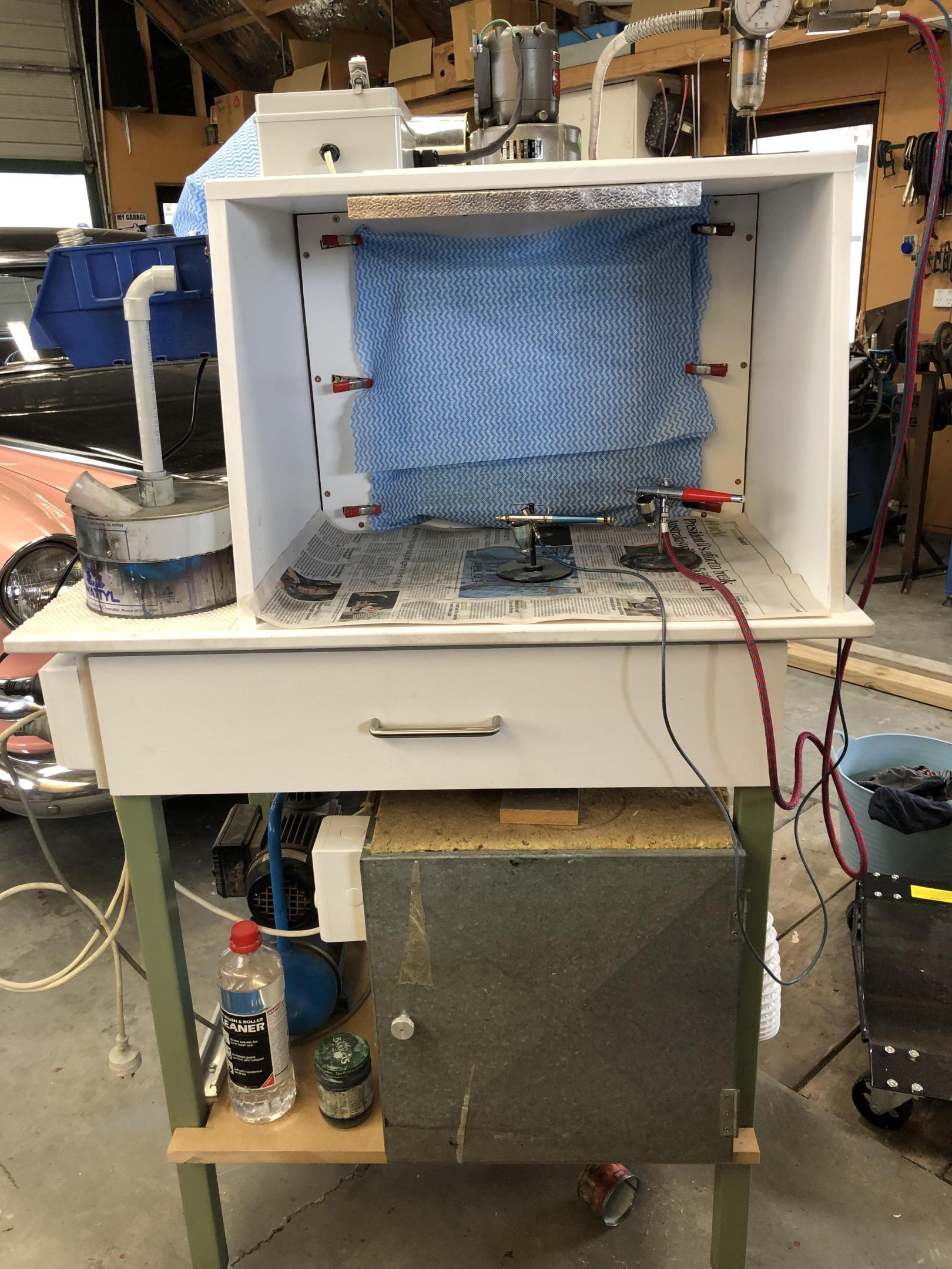

bill-e-boy Posted April 29, 2022 Posted April 29, 2022 Looks good Bob. Your booth is a smidgeon wider than the one I made up a little while ago. The secret to keeping BLAH_BLAH_BLAH_BLAH out of the paint is to move the painted items to a covered container to cure the paint. I use an insulated metal box with a light bulb on a dimmer but a dehydrator is supposedly good too. The deal is to move the painted object straight from the booth to the curing chamber to minimise any dust settling onto the wet paint. I also made a front cover to go over the open side of the booth to minimise dust and BLAH_BLAH_BLAH_BLAH getting into the booth. My workshop is general purpose with work stuff happening (self employed industrial electrician), metal working and worst of all woodworking - I try try to do the dustiest stuff outside I see you have a Paasche H air brush - good choice. I have one of these amongst the others I have collected over the years and my general go to is a Badger 200 that I picked up about 20yrs ago Pix of my set up below shows booth on top with the hot box curing chamber below
Zippi Posted April 29, 2022 Author Posted April 29, 2022 45 minutes ago, bill-e-boy said: Looks good Bob. Your booth is a smidgeon wider than the one I made up a little while ago. The secret to keeping BLAH_BLAH_BLAH_BLAH out of the paint is to move the painted items to a covered container to cure the paint. I use an insulated metal box with a light bulb on a dimmer but a dehydrator is supposedly good too. The deal is to move the painted object straight from the booth to the curing chamber to minimise any dust settling onto the wet paint. I also made a front cover to go over the open side of the booth to minimise dust and BLAH_BLAH_BLAH_BLAH getting into the booth. My workshop is general purpose with work stuff happening (self employed industrial electrician), metal working and worst of all woodworking - I try try to do the dustiest stuff outside I see you have a Paasche H air brush - good choice. I have one of these amongst the others I have collected over the years and my general go to is a Badger 200 that I picked up about 20yrs ago Pix of my set up below shows booth on top with the hot box curing chamber below Thanks man. Looks like you've got it figured out pretty good.

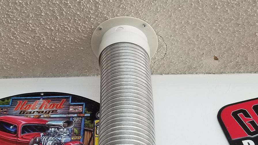

Dave G. Posted September 24, 2022 Posted September 24, 2022 Also Bob, that's a long run up and out, you may need a secondary blower up near the top to help suck those fumes out. You could cut a squirrel cage right into the existing venting.
Zippi Posted September 24, 2022 Author Posted September 24, 2022 2 hours ago, Dave G. said: Also Bob, that's a long run up and out, you may need a secondary blower up near the top to help suck those fumes out. You could cut a squirrel cage right into the existing venting. Thanks for the info Dave. Looks like I need to do a little research on some primer for my airbrush.
