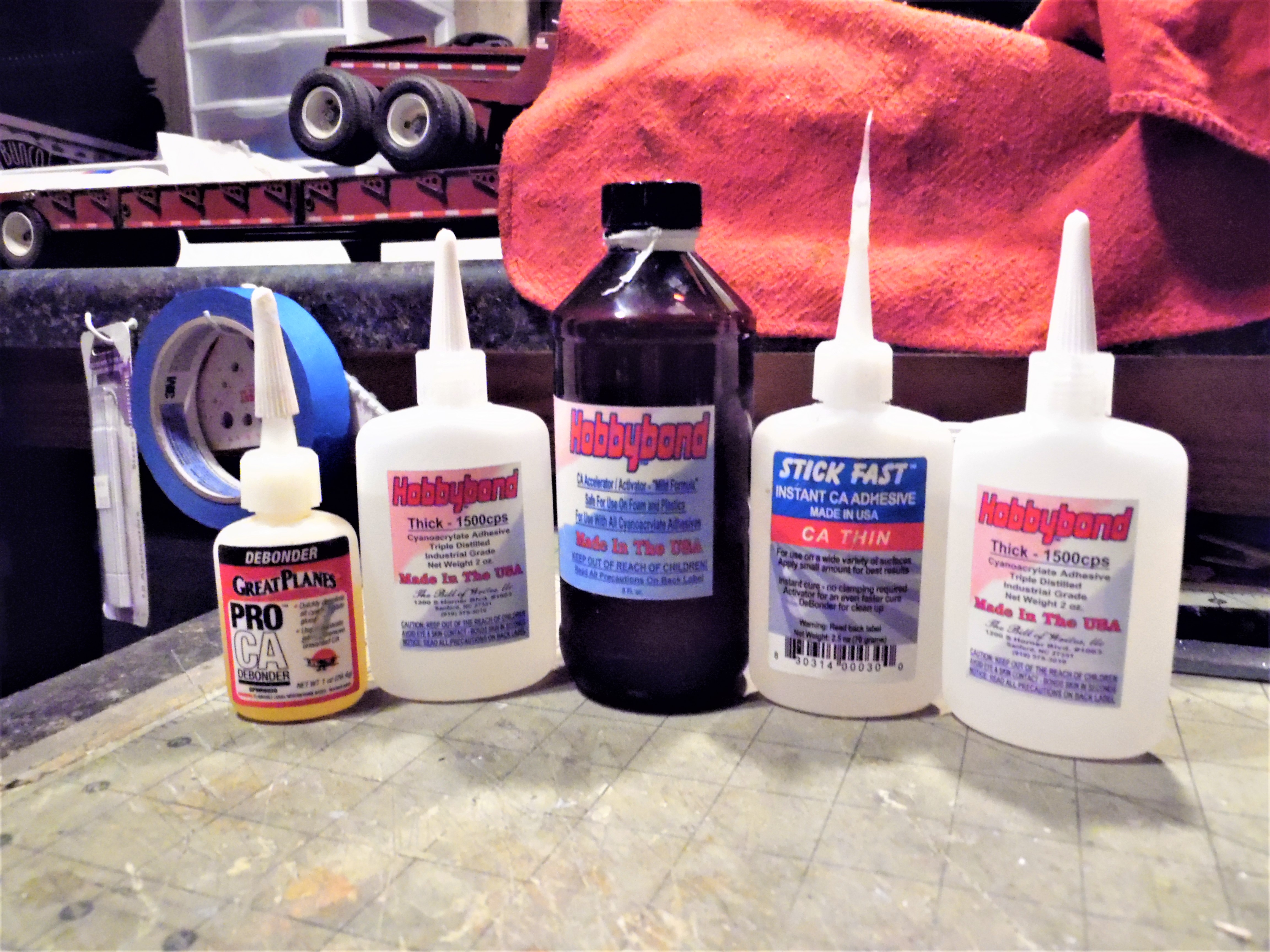

yh70 Posted May 4, 2021 Posted May 4, 2021 (edited) get u some Ca glue (super glue) and a kicker for instant set of the glue. i use thick and medium but do keep thin on hand. also get u some de-bounder and extra glue tips..u can find this all on ebay. i been getting it their for years... i also use a liquid glue (orange bottle is the best) made by plastruct. it can also be found on ebay or Amazon .i been using these glues for many years. they is nothing no better. and it does not have to be a name brand of GA glue to work better than others brands.. Edited May 4, 2021 by yh70
69_Stingray Posted May 4, 2021 Posted May 4, 2021 With the superglue, get you some debonder. Your going to glue your fingers together and need some to unstick them.

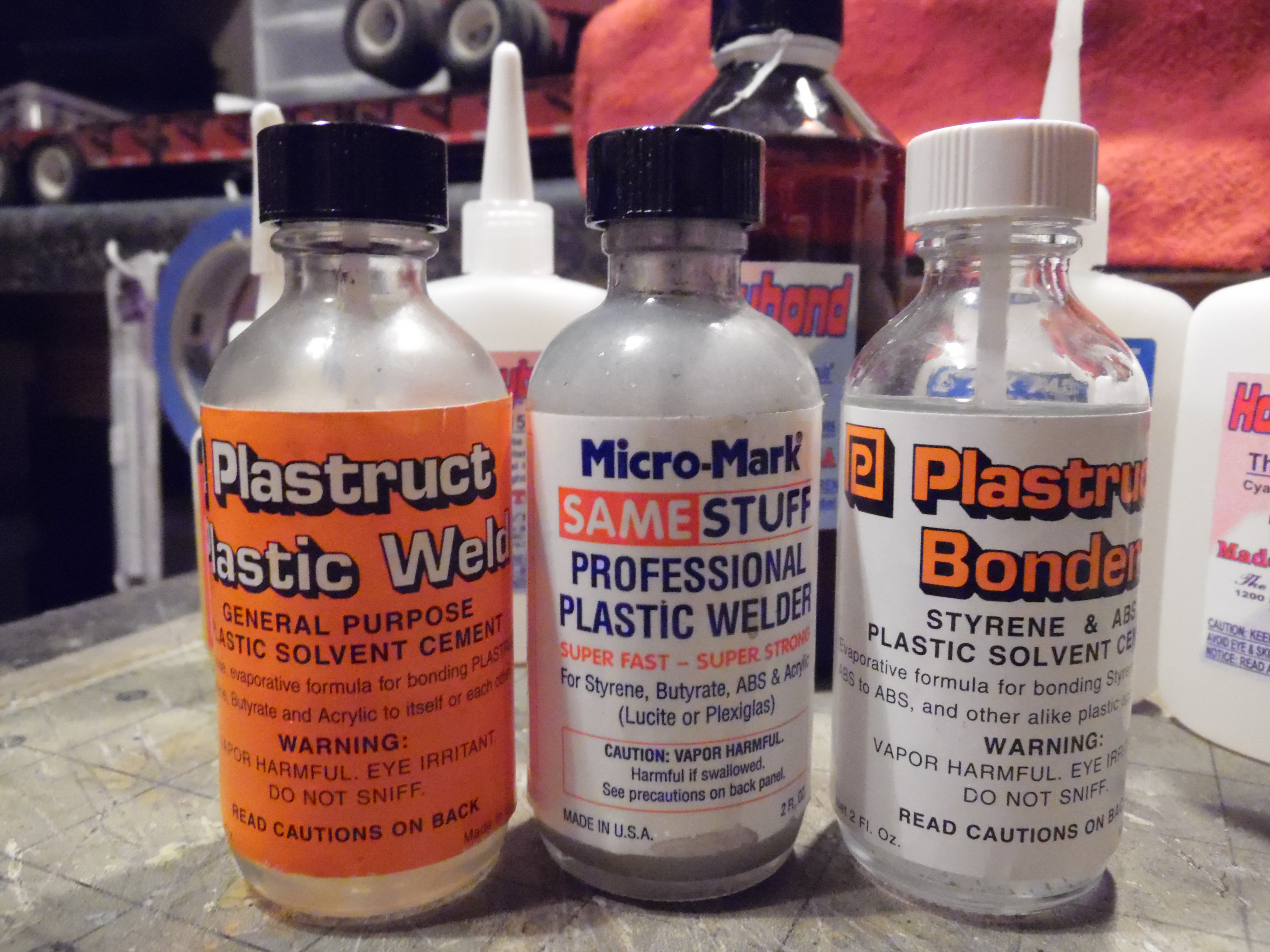

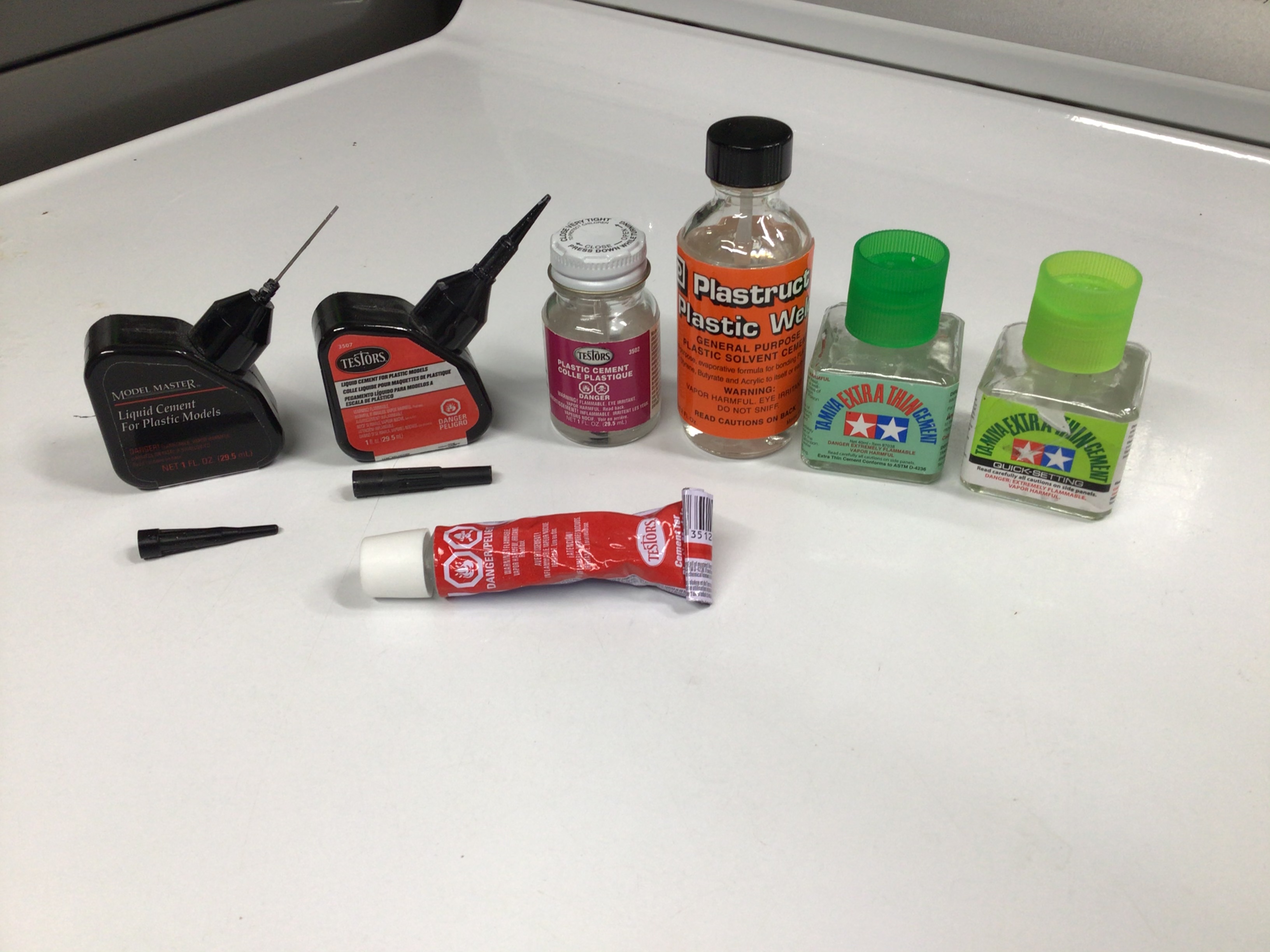

NOBLNG Posted May 6, 2021 Posted May 6, 2021 (edited) These are all of the “plastic melting” glues that I have. I use the Tamiya Quick Setting stuff now almost exclusively unless a non-solvent glue is required. They all work well in my experience, except the Plastruct. I bought it last week because the shop owner had it on sale so I figured why not? I glued some .156” half round styrene to some rectangle to make a muffler. When dry, I used a pin to dimple the end so I could drill a hole and it split apart.? Oh, and the plastic nozzle on the testors always plugs up.? Edited May 6, 2021 by NOBLNG
