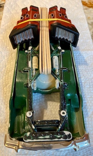

Just Jim Posted May 10, 2021 Author Posted May 10, 2021 Found my back engines! Not much like the small cylindrical ones on the cartoon car but it's what I have on hand and I think it looks cool so I'm going with it. ?

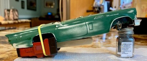

Just Jim Posted June 22, 2021 Author Posted June 22, 2021 In an attempt to give a little back to this forum and the people here who have provided me so many new ideas and so much guidance, I wanted to share the process I used to close up the wheel wells. The picture shows the type of styrene and bondo I used along with my trusty sanding block (I used 400 grit sandpaper). Some of the things I learned along the way in no particular order are: 1. Apply the bondo with a moist (not wet) fingertip. 2. The best way to remove bondo is by sanding. I had a random spec fall on the passenger door and made the mistake of scraping it off with my fingernail which caused a hole in the plastic. 3. If I had it to do again, I would place layers of styrene protruding beyond the body. Although doing so leads to more sanding, it is ultimately easier than filling it. If you look from the correct angle, you can see the plastic over the wheel wells is concave. 4. I ended-up using the baby powder/superglue method to fill the really small lines. I wasn’t able to get the bondo to fill the hairline cracks where the styrene and body met. 5. Be really careful when filing in areas next to lines you want to keep. Once the filler is in a body line, it’s tough to get out. As stated above, this is my first foray into the world of adding plastic so I'm sure I still have a lot to learn. Just doing what I can to try and help the next person looking to jump into the mix.

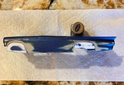

Just Jim Posted June 22, 2021 Author Posted June 22, 2021 Got the wheel wells and back end closed up and ready for paint! Attached the three fins on the trunk lid and shot some paint last night. Hoping to get updated pics online this week. Currently detailing the jet engines and fabricating the headers. More soon.

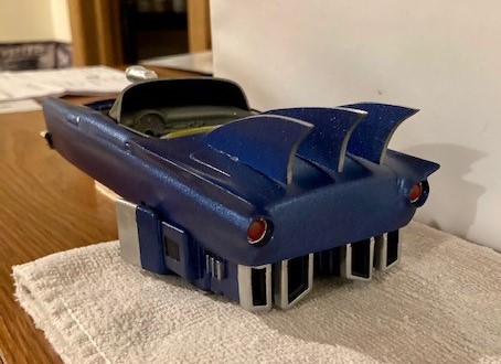

Just Jim Posted July 1, 2021 Author Posted July 1, 2021 My last WIP update for this one. I have a stand to place it on so it will look like it's hovering. I have fabricated the headers but have to figure out how to attach them. I am a little disappointed with the bug-eyed look of the headlights but with the headlight buckets and headlight plastic missing, it didn't make sense to me to paint both the headlights and the backing silver. So, since it has a yellow tint in the screen shot, I went with that. I think the black windshield I fabricated turned out pretty good. Normally I would have painted the "glass" silver but was concerned the silver windshield would cause the mostly silver engine to become invisible. Hopefully I can get some pictures in the Under Glass section by the end of the weekend.
