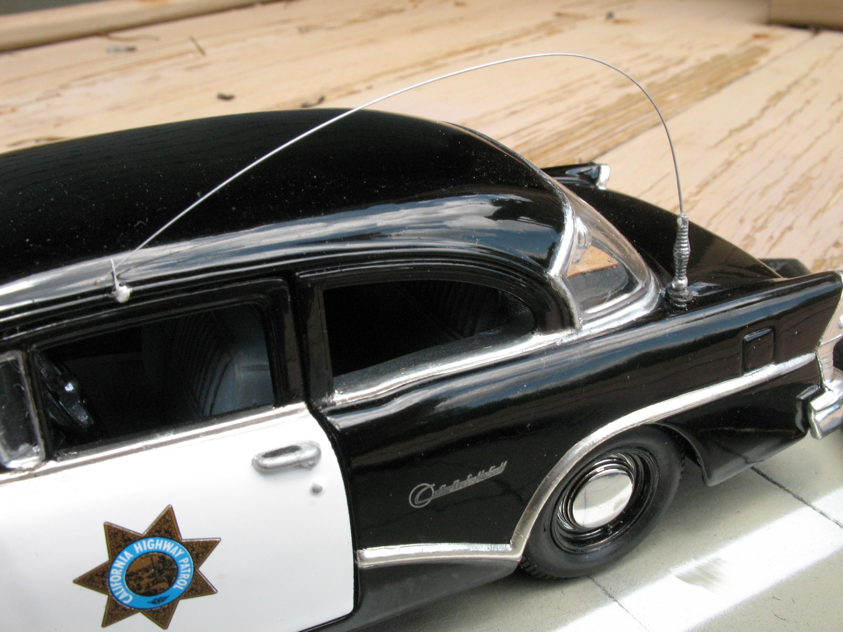

Mike999 Posted May 14, 2021 Posted May 14, 2021 Here's how I did it, on a diecast kit of the very car in your photo: the Model 68 '55 Buick built only for the California Highway Patrol. I found the diamond-shaped antenna base in the parts stash and made the hold-down clip on the rain gutter from a tiny piece of photo-etch metal scrap. I drilled thru the antenna base and added an antenna made of stretched sprue. That let me add the "ball" on the end, by simply heating the sprue. The antenna is painted with Molotow Liquid Chrome. I also added the rubber boot at the base of the antenna, but don't remember where that came from.

Danno Posted May 15, 2021 Posted May 15, 2021 21 hours ago, Mike999 said: Here's how I did it, on a diecast kit of the very car in your photo: the Model 68 '55 Buick built only for the California Highway Patrol. I found the diamond-shaped antenna base in the parts stash and made the hold-down clip on the rain gutter from a tiny piece of photo-etch metal scrap. I drilled thru the antenna base and added an antenna made of stretched sprue. That let me add the "ball" on the end, by simply heating the sprue. The antenna is painted with Molotow Liquid Chrome. I also added the rubber boot at the base of the antenna, but don't remember where that came from. Bingo! Good job, Mike. Very good job. Stretching sprue is another way to get a scale-dimension mast, but way more fiddly work than I'm up for, so the guitar string does the trick for me. ??
