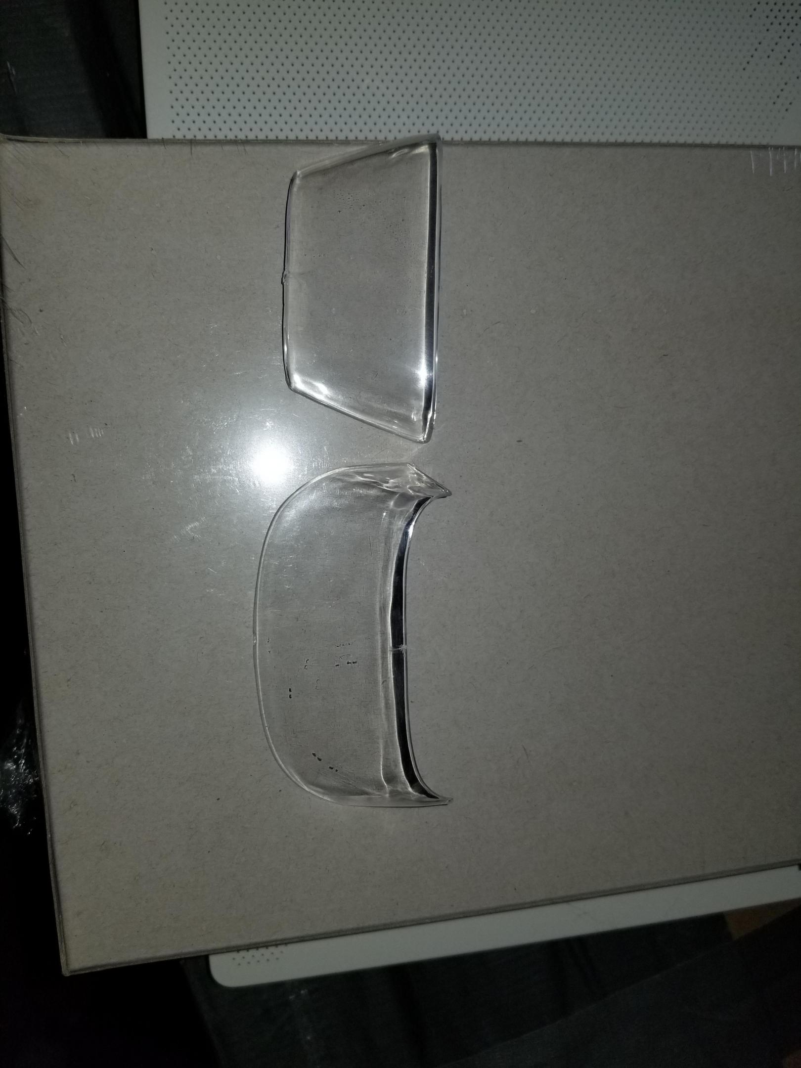

youpey Posted May 11, 2021 Author Posted May 11, 2021 (edited) Here is my work with the tamiya and the microgloss liquid abrasive. I cant get 2 of the very small chips out. I sanded and sanded and i feel the divot still, so short of somehow filling it somehow, its going to stay like this. Other than the small chips they are clear. I gave it another coating of the microgloss and polish each one for really long time and then did final cleaning with new rag. I wish i took a before picture but i didn't. they were in horrible shape with scratches all over the front and back windows Its a little hard to tell but they look amazing. If it wasn't for the tiny chips i would be so happy with the results. I dont have any more hazing that i can see. They look great now Edited May 11, 2021 by youpey
