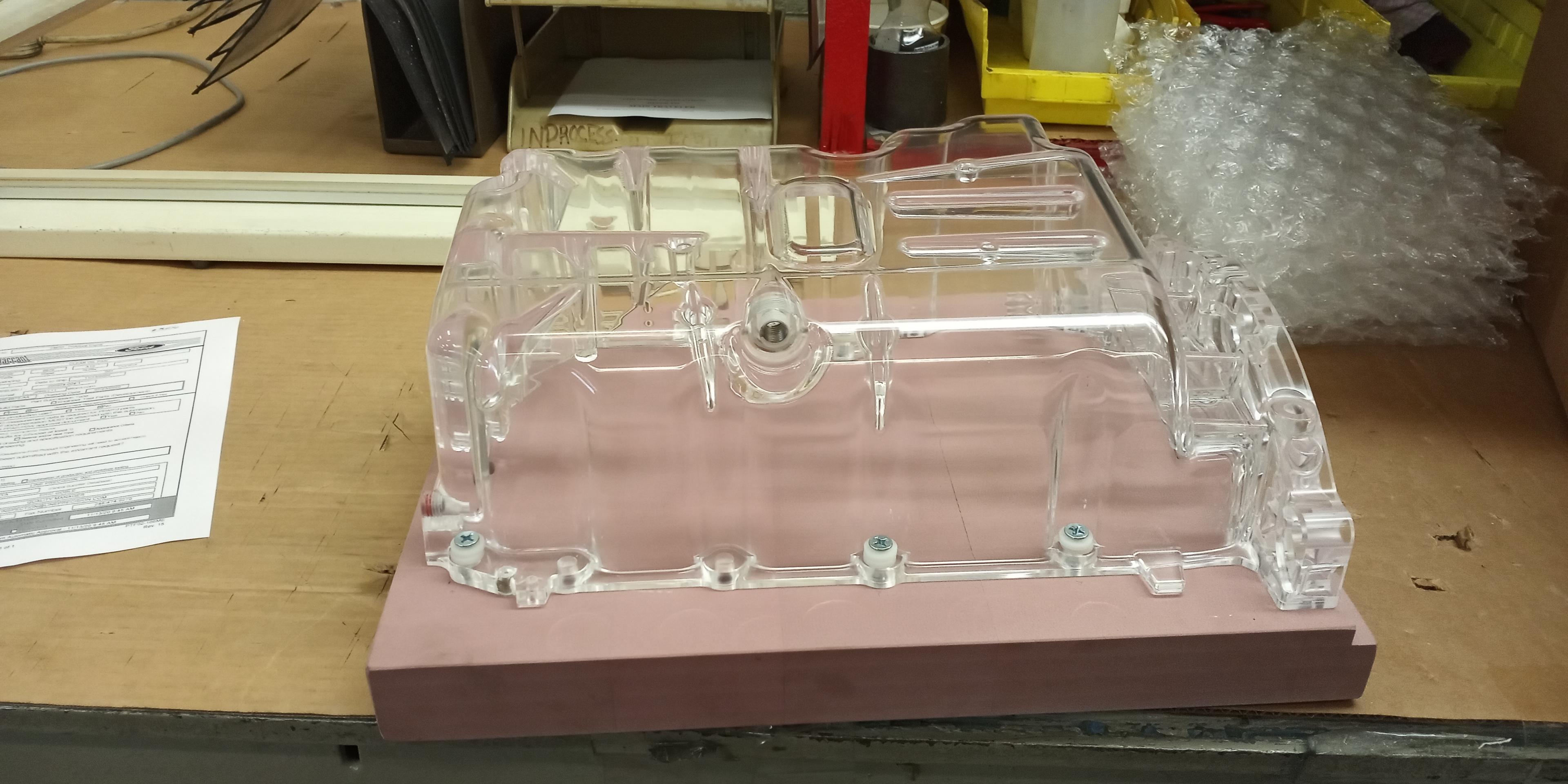

Deuces ll Posted May 11, 2021 Posted May 11, 2021 (edited) We use Novus waxes here at work for polishing clear acrylic oil pans, cam covers, and timing covers.... All machined from a solid block of acrylic...? Here's an oil pan... Edited May 11, 2021 by Deuces ll
TransAmMike Posted May 11, 2021 Posted May 11, 2021 3 hours ago, Deuces ll said: We use Novus waxes here at work for polishing clear acrylic oil pans, cam covers, and timing covers.... All machined from a solid block of acrylic...? Here's an oil pan... Gotta ask, what is an acrylic oil pan used on???
