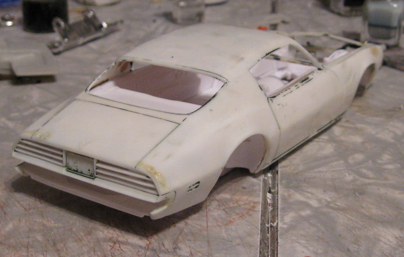

Can-Con Posted May 26, 2021 Posted May 26, 2021 (edited) 12 minutes ago, slusher said: Do all the kits work/ fit together? Does the Revell interior work in AMT Trans am? Takes a little trimming but, , , With a little work you can get everything,including the glass from the Revell kit into the MPC body [AMT never made a 2nd gen Firebird] The decals are from Keith Marks and hood and scoop is from Missing Link. It'll be painted dark silver with red interior. Edited May 26, 2021 by Can-Con 1
Can-Con Posted May 26, 2021 Posted May 26, 2021 (edited) 3 minutes ago, Can-Con said: BTW, that's an MPC '74 annual body I've had since the early '80s. Edited May 26, 2021 by Can-Con

Can-Con Posted June 1, 2021 Posted June 1, 2021 1 hour ago, Sledsel said: I assume the this is an old MPC tool? Yes. That's the second tool MPC cut to keep up with demand for the Blackbird kit. It's the same kit that's out now in this box,, The '79 that's been out for a couple years was the annual.

Can-Con Posted June 5, 2021 Posted June 5, 2021 5 hours ago, Hawk312 said: I am still struggling with that front clip, which just looks to bulky under the headlights, and the headlights look just a little shallow. Thats just to my eyes. That said, I remember seeing your build years ago Can-Con, and it is FANTASTIC and inspiring. Great color and great wheels! Is that the kit decals? What tires and outer rim did you use? Thanks David, The decals are Keith Marks' and the wheel rims are made from copies of the large steel wheels in the older issues of the MPC Dodge pickups that I had cast myself and had plated.

Oldcarfan27 Posted June 6, 2021 Posted June 6, 2021 On 6/5/2021 at 7:46 AM, Luc Janssens said: Could the front clip of the Revell be adapted to fit the Mpc kit, or the grilles/headlamp assy'? (Don't have the Revell kit myself, that's why the question) IIRC, I think I used the Revell grilles in the MPC nose, which made it look better. I'll have to dig it out for pictures. The only part of the MPC body I didn't like was the rear spoiler - it looked like a straight up billboard back there! That's why I said it should be massaged to fit better. 1
