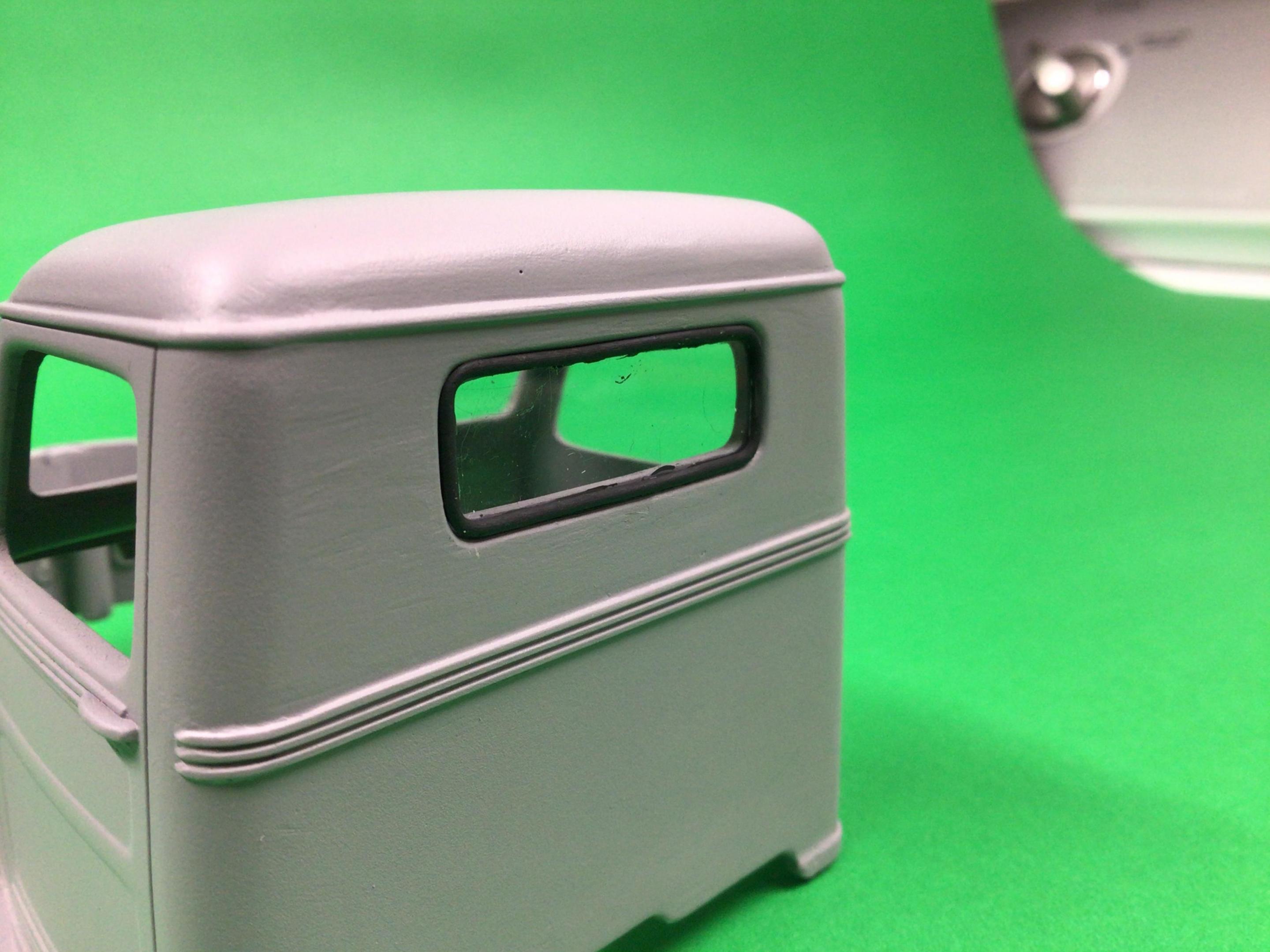

NOBLNG Posted May 24, 2021 Posted May 24, 2021 (edited) Do you mean the rubber moldings that the glass is set in? If so, I made these out of .040” half round and painted the them with Tamiya XF-85 rubber black. Edited May 25, 2021 by NOBLNG
chas3840@yahoo.com Posted May 27, 2021 Author Posted May 27, 2021 Thanks a lot! Looks good. Just to be sure, that is half round styrene rod?

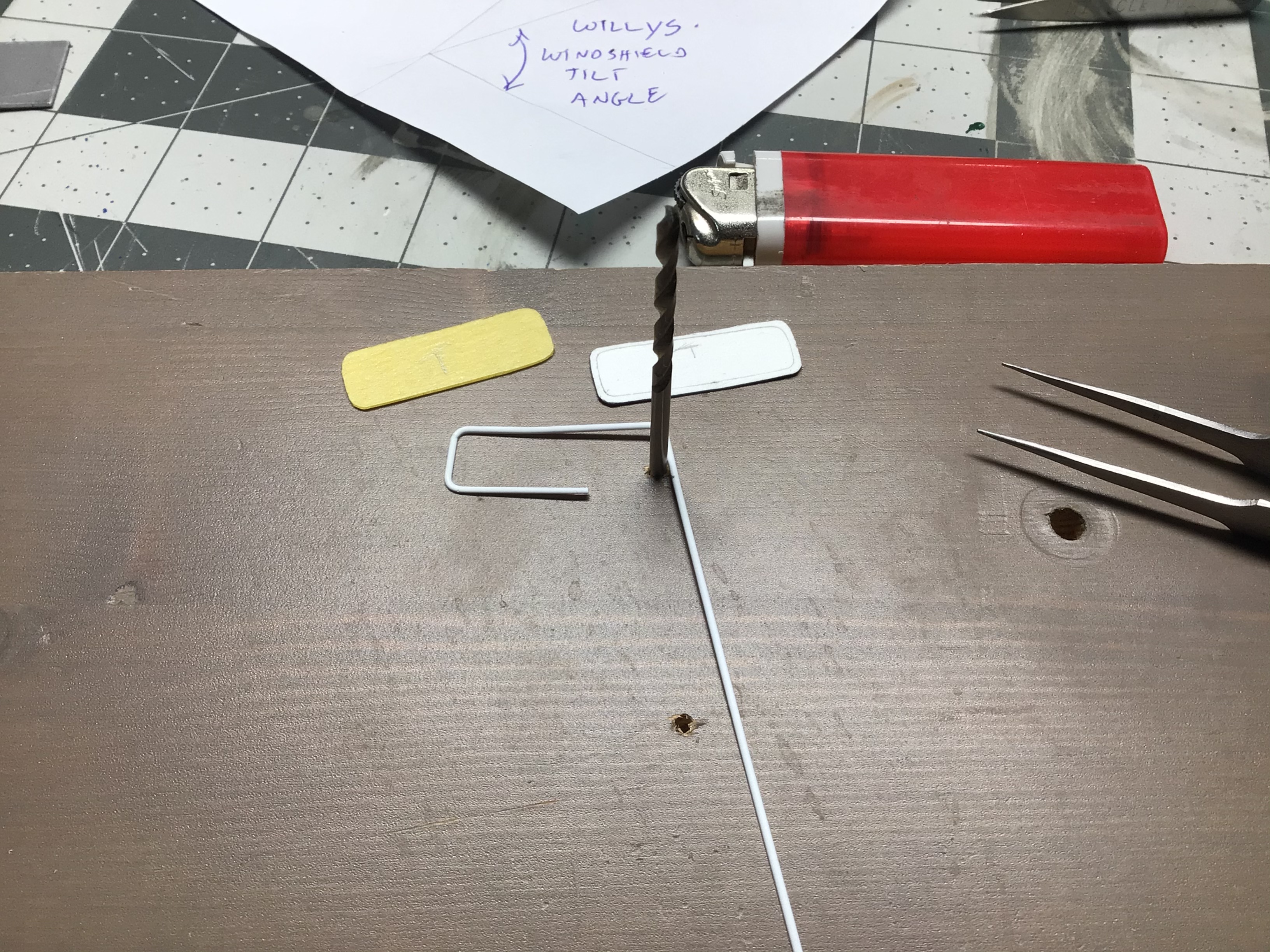

NOBLNG Posted May 27, 2021 Posted May 27, 2021 Yes. Evergreen and Plastruct have it in different sizes. If I recall, I cold bent it around the drill bit while holding it flat to the board with the tweezers. Then warmed it slightly with the lighter to “set” the bend.
