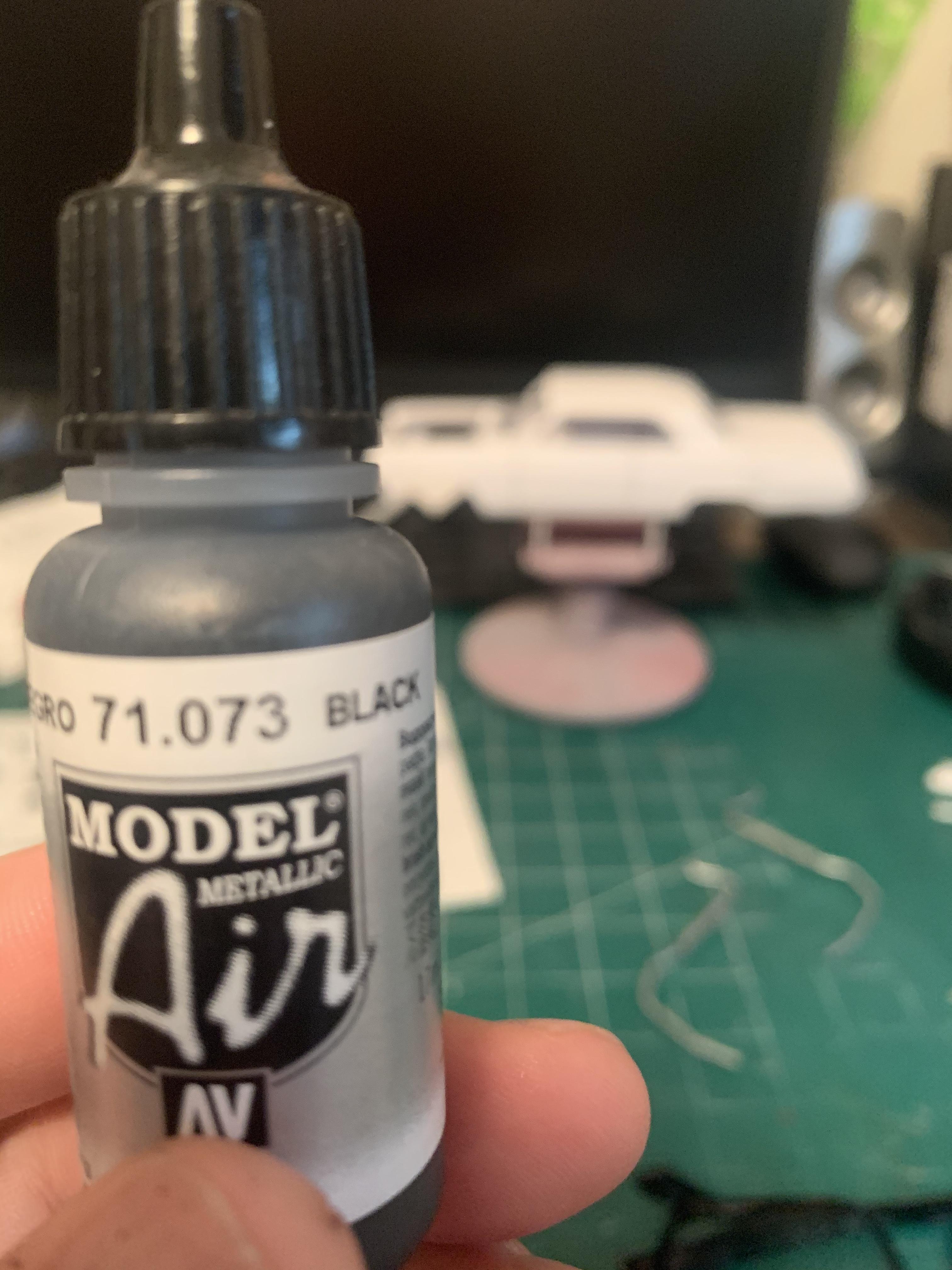

Brutalform Posted May 27, 2021 Posted May 27, 2021 (edited) I use the Vallejo Air all the time. Just shake well, and it’s thinner than the Model Color counterpart to use in an airbrush so you won’t have to add water. For the Model Color bottles, I add just enough water with a eye dropper to get the correct consistency I need. Also be aware that there is a black metallic available. It’s printed small on the label. I bought the metallic by mistake. I don’t even bother with the Tamiya jar paints anymore as the Vallejo will leave brush strokes, but no where near as difficult to level as the Tamiya paint. Edited May 27, 2021 by Brutalform
