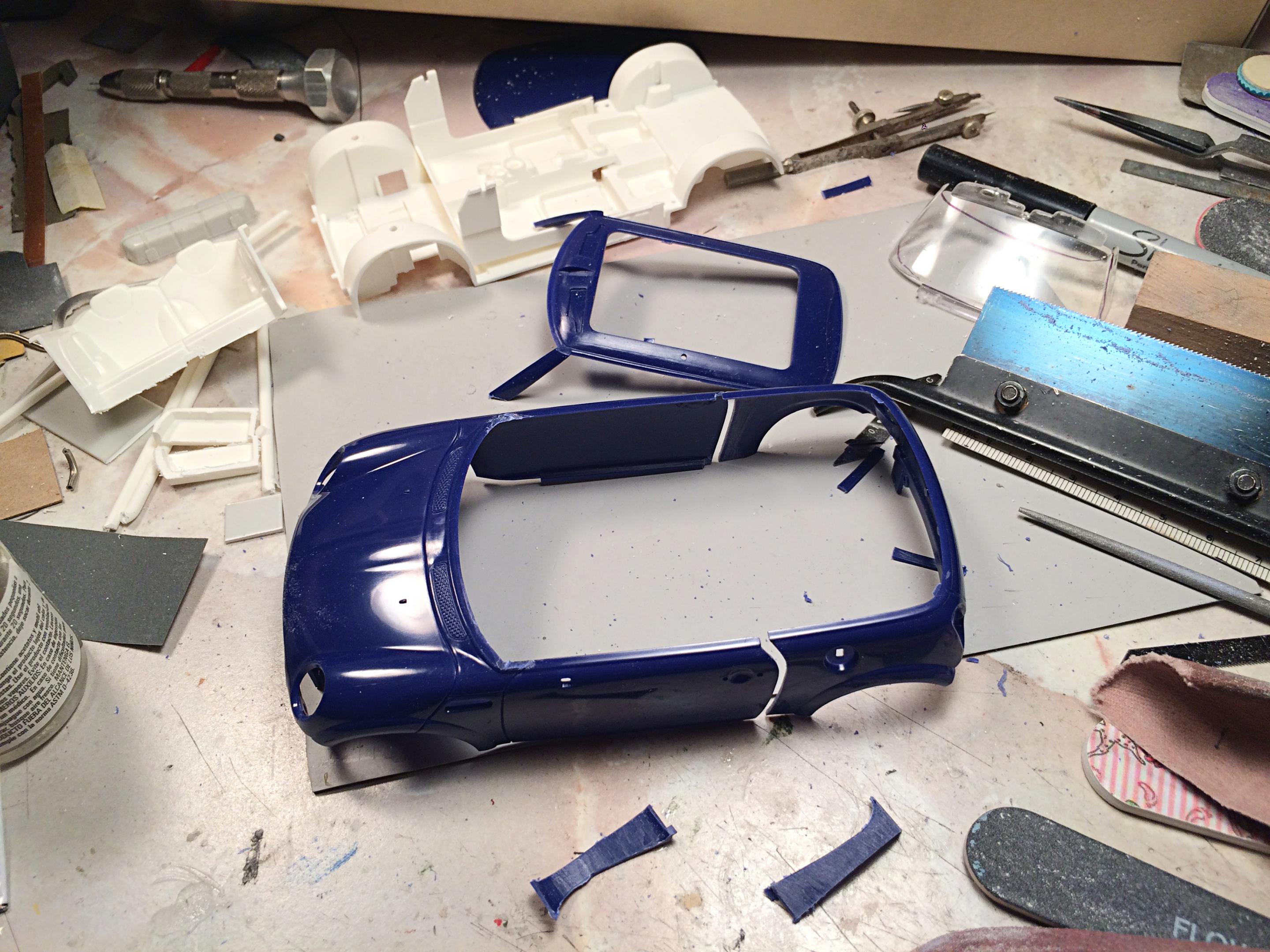

bh1701 Posted May 29, 2021 Posted May 29, 2021 I have this window insert from a Mini Cooper model kit. I am going to modify this kit (which is the hardtop version) into a convertible. I will need to remove everything except for the front windshield and the portion with the sun visors. As I seem to remember, cutting clear plastic can be a little tricky. If I am not mistaken, clear plastic seems to be a little more brittle and can be prone to cracking when you try to cut it. Any suggestions on the best way to do this would be appreciated! Thanks, Bart
