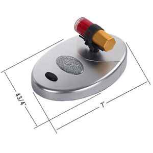

ewetwo Posted May 29, 2021 Posted May 29, 2021 This might have been on here but I didn't see it. So I thought I would share it. I ordered on of these today. Hopefully it works well. 1
wayne00 Posted June 1, 2021 Posted June 1, 2021 I was curious so I looked them up online. Found this one on Amazon: Amazon.com: Shaken Not Stirred Tattoo Ink Shaker Hobby Paint Mixer Permanent Makeup Pigment Nail Polish Gel Lacquer Microblading Varnish Bottle Shaking Machine: Beauty Looks to be similar to the one OP has. Rog?

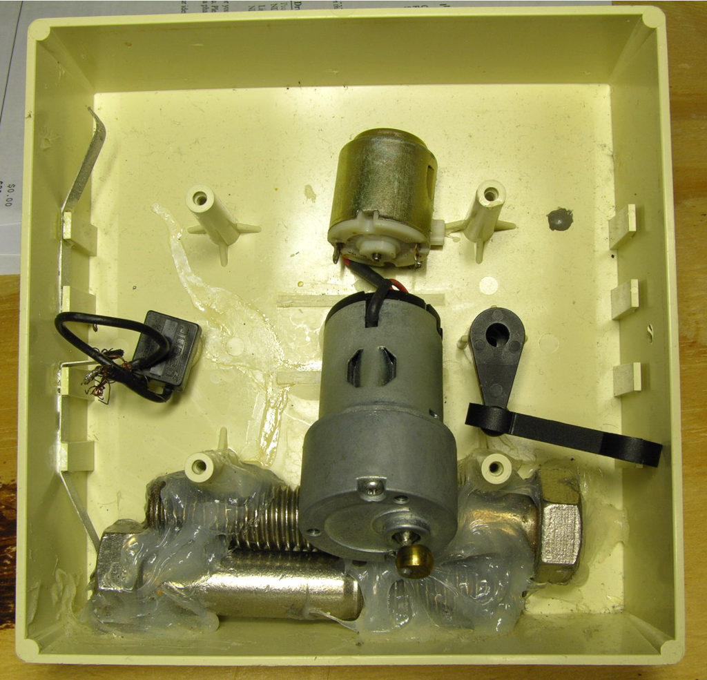

peteski Posted June 1, 2021 Posted June 1, 2021 (edited) I bought a similar shaker from Micro-Mark about 20 years ago. It is made by Robart. It was originally designed for battery power, but it was upgraded to AC-power (included a permanently wired wall-wart). It worked really well for small bottles (1/2 OZ. or smaller), but the motor didn't have enough "oomph" for larger bottles (1OZ. or larger) and it would really slow down. It also used to walk on my workbench. I glued in couple of large steel bolts in the battery compartment for ballast and that solved the walking problem. I also found much more powerful geared motor I'm going to retrofit in the shaker. For now the shaker is out of commission. This is the current version. Mine was cream color and had a different label. Edited June 1, 2021 by peteski 1

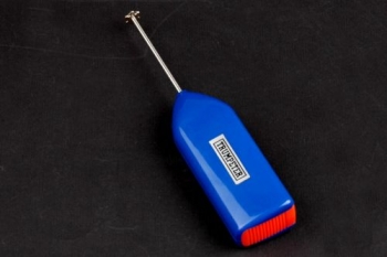

NOBLNG Posted June 1, 2021 Posted June 1, 2021 Shaken or stirred, which is better? I use one of these so the lids don’t get paint all over them. ? 2
iBorg Posted June 1, 2021 Posted June 1, 2021 3 hours ago, peteski said: I bought a similar shaker from Micro-Mark about 20 years ago. It is made by Robart. It was originally designed for battery power, but it was upgraded to AC-power (included a permanently wired wall-wart). It worked really well for small bottles (1/2 OZ. or smaller), but the motor didn't have enough "oomph" for larger bottles (1OZ. or larger) and it would really slow down. It also used to walk on my workbench. I glued in couple of large steel bolts in the battery compartment for ballast and that solved the walking problem. I also found much more powerful geared motor I'm going to retrofit in the shaker. For now the shaker is out of commission. This is the current version. Mine was cream color and had a different label. I'd love to see the motor retrofit and info on it. I've got one of these also twenty years old and would like to update.
Xingu Posted June 1, 2021 Posted June 1, 2021 8 hours ago, iBorg said: I'd love to see the motor retrofit and info on it. I've got one of these also twenty years old and would like to update. I have one of these that I bought about 5 years ago and it does just fine with the 1 oz. jars of airbrush paint that I buy. Maybe they upgraded these at some point.

peteski Posted June 2, 2021 Posted June 2, 2021 (edited) 9 hours ago, Xingu said: I have one of these that I bought about 5 years ago and it does just fine with the 1 oz. jars of airbrush paint that I buy. Maybe they upgraded these at some point. Quite possible since I had mine for a long time. Mine was powered by a small motor, similar to what powers inexpensive motorized toy cars. It would still shake 1OZ. bottles but at about 1/3 of the oscillations of the small Testors bottles. You got me curious. If you feel adventurous, and have some spare time, maybe you could unscrew the bottom plate and take a photo of the innards? Edited June 2, 2021 by peteski
Curt Posted June 2, 2021 Posted June 2, 2021 David, I just bought the one you show in the picture and I’m very happy with it. It has no problem shaking the 2 oz. bottles.
ewetwo Posted June 2, 2021 Author Posted June 2, 2021 20 hours ago, Curt said: David, I just bought the one you show in the picture and I’m very happy with it. It has no problem shaking the 2 oz. bottles. Thank you Curt. Happy to know it'll work fine.
peteski Posted June 6, 2021 Posted June 6, 2021 On 6/1/2021 at 2:00 AM, iBorg said: I'd love to see the motor retrofit and info on it. I've got one of these also twenty years old and would like to update. On top of the photo is the original motor. The motor with the gearhead is much larger and has lots more torque. The output shaft was rather large diameter, so I had to grind it down until I could fit the spherical brass coupler onto it. Now I just need to create a mounting bracket for that motor, and put it all back together. I also have a new wall-wart with a higher amperage rating that the one powering the original motor. You can also see the large bolts I glued in to prevent the shaker from walking on the bench. 1
Xingu Posted June 7, 2021 Posted June 7, 2021 18 hours ago, peteski said: On top of the photo is the original motor. The motor with the gearhead is much larger and has lots more torque. The output shaft was rather large diameter, so I had to grind it down until I could fit the spherical brass coupler onto it. Now I just need to create a mounting bracket for that motor, and put it all back together. I also have a new wall-wart with a higher amperage rating that the one powering the original motor. You can also see the large bolts I glued in to prevent the shaker from walking on the bench. Mike - mine is similar in size as this one. I cracked it open right after your post and forgot to take a photo of it or even reply to your post. Sorry. I was shocked at how small it was. It has no trouble mixing 1 oz. jars from MCW. Maybe having the mixing ball in the jar helps though.
peteski Posted June 7, 2021 Posted June 7, 2021 24 minutes ago, Xingu said: Mike - mine is similar in size as this one. I cracked it open right after your post and forgot to take a photo of it or even reply to your post. Sorry. I was shocked at how small it was. It has no trouble mixing 1 oz. jars from MCW. Maybe having the mixing ball in the jar helps though. Well mine would shake 1 oz. bottles but fairly slowly compared to smaller bottles (which where oscillating like crazy). It was really struggling.
modelercarl Posted June 8, 2021 Posted June 8, 2021 Just received mine from Amazon and tried it out with 1 oz. MCW without mixing ball(s). It was amazingly quick completely mixing the paint that had completely separated. Probably been stored for 5+ years. No more sore 80 year old arm! Tried it out on a bottle of MCW metallic and it mixed the separated paint but not the metallic flakes after 2 minutes, but it was easier mixing the flakes by hand than it used to be. Will try leaving metallic in the mixer for longer period of time at a later date.
Bainford Posted June 10, 2021 Posted June 10, 2021 I wonder if it would have mixed the metallic flakes with a couple BBs tossed into the bottle. 1
Capt. Speirs Posted June 12, 2021 Posted June 12, 2021 On 5/31/2021 at 7:34 PM, NOBLNG said: Shaken or stirred, which is better? I use one of these so the lids don’t get paint all over them. ? Stirred, shaken adds bubbles.
peteski Posted June 13, 2021 Posted June 13, 2021 On 6/11/2021 at 11:18 PM, Capt. Speirs said: Stirred, shaken adds bubbles. Yes, I have heard this mentioned numerous times. Yet, shaking is the only mixing method used in thousands of hardware stores and home improvement stores all over the U.S. And the latex paint those paint shakers mix, shaking the bejesus out of is rather thick, so it should be really prone to trapping air bubbles. I have never had any air-bubbles problems with my latex paint after it was being shaken, and I never heard of anybody complain that the paint shakers create air bubbles, making the paint difficult to apply. Most of our hobby paints are also less viscous than the latex house paint, so bubbles should even be less of a concern. 1
NOBLNG Posted June 13, 2021 Posted June 13, 2021 (edited) I don’t think bubbles are too much of a concern, especially if you are blowing it through an airbrush. The mess on the lids is my main irk. I have had some old testors paints that I couldn’t get the lids off with a pair of pliers.? Edited June 13, 2021 by NOBLNG 1

Skip Posted June 22, 2021 Posted June 22, 2021 On 5/29/2021 at 7:44 AM, ewetwo said: This might have been on here but I didn't see it. So I thought I would share it. I ordered on of these today. Hopefully it works well. Got the same shaker off of eBay, I love it. For high solid/pigment acrylics or the square Testers enamels in glass bottles you can’t beat it. I’ve always had issues with some acrylics getting the pigment fully mixed in with the acrylic and this always does the trick! I’ve used it with everything I shoot through my airbrush, never had any issues with air bubbles in the mix, but I normally allow the mix to rest after any heavy agitation of any kind. After the mix rests it’s normally stirred gently just like you’d normally do with any automotive paint. I also have a Badger paint mixer, which in my opinion doesn’t do quite as good as the shaker does, especially on enamels that the pigment is all sitting on the bottom of the bottle. The mixer left pigment on the bottom of the jar where the shakers agitation left none. Paint shops and hardware stores shake paint for a reason, probably because mixing is messier or maybe because it works better…. They’ve probably tried about every way to mix paint that there is and they shake away! Probably the best $30 I’ve spent on any paint gadget in a while, if I could get my One Shot enamels (1/2 pints) to shake on it I would in a heartbeat!
ewetwo Posted June 22, 2021 Author Posted June 22, 2021 11 hours ago, Skip said: Got the same shaker off of eBay, I love it. For high solid/pigment acrylics or the square Testers enamels in glass bottles you can’t beat it. I’ve always had issues with some acrylics getting the pigment fully mixed in with the acrylic and this always does the trick! I’ve used it with everything I shoot through my airbrush, never had any issues with air bubbles in the mix, but I normally allow the mix to rest after any heavy agitation of any kind. After the mix rests it’s normally stirred gently just like you’d normally do with any automotive paint. I also have a Badger paint mixer, which in my opinion doesn’t do quite as good as the shaker does, especially on enamels that the pigment is all sitting on the bottom of the bottle. The mixer left pigment on the bottom of the jar where the shakers agitation left none. Paint shops and hardware stores shake paint for a reason, probably because mixing is messier or maybe because it works better…. They’ve probably tried about every way to mix paint that there is and they shake away! Probably the best $30 I’ve spent on any paint gadget in a while, if I could get my One Shot enamels (1/2 pints) to shake on it I would in a heartbeat! Yes. I used mine and it works really well. It does move on the table a bit. But I was amazed at how heavy it was.
