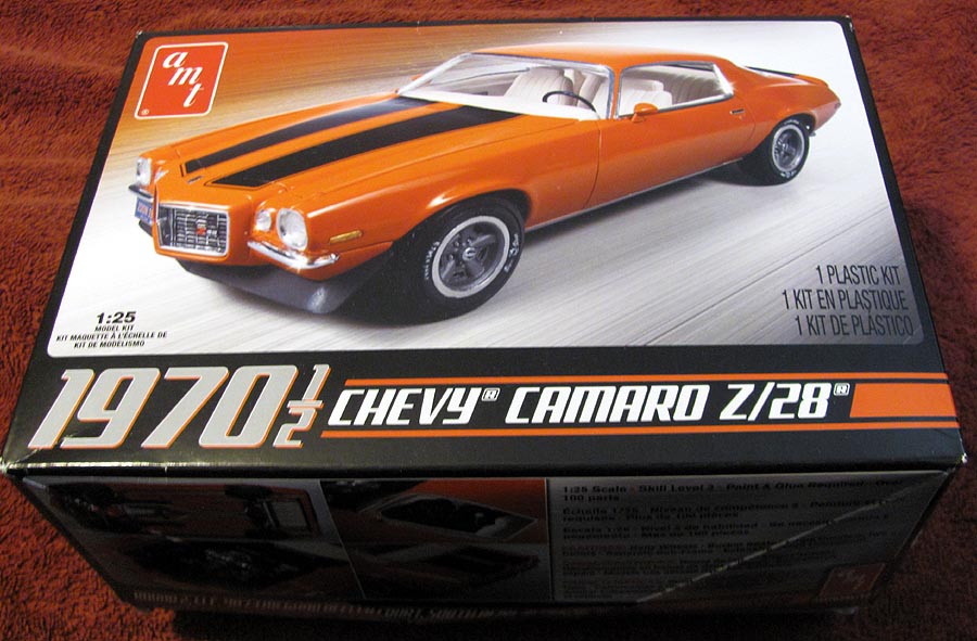

MarkJ Posted June 8, 2021 Posted June 8, 2021 (edited) Here is the kit. I will need to change the front and rear to have it pass as a 74. I will also need to make new bumpers. I know I could have gotten a 74 kit, maybe if I could have found one, and pay big bucks for it, and I know a 74 Camaro resin is available, but its more fun to do it this way. I stole the engine out of this kit for a 65 Chevelle I built because it came with a big block and I needed a small block for the Chevelle. I bought a 70 Corvette kit to get a small block for this build. I will use the big block from the Chevelle kit for the 70 Corvette whenever I build it. Edited June 8, 2021 by MarkJ

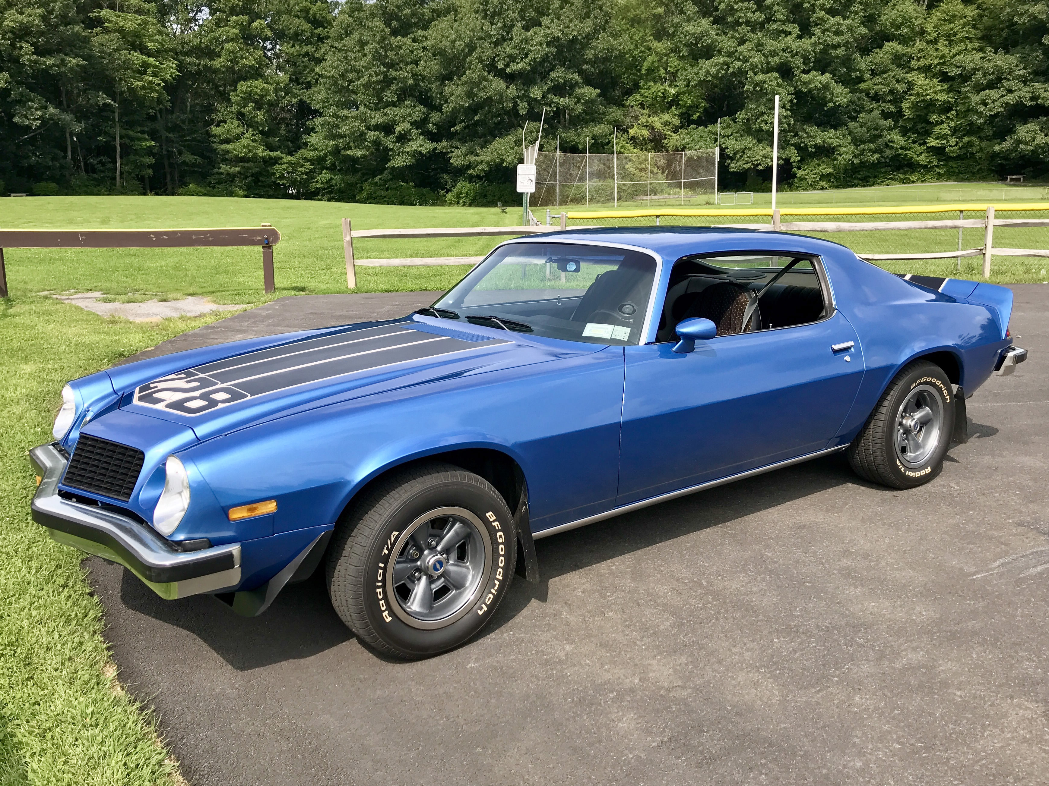

Oldcarfan27 Posted June 9, 2021 Posted June 9, 2021 Your not too far wrong with your procedure. My first car was a 74 Camaro and when I took it all apart to rebuild it, I found out that the hood and fenders are the same ones as 70-73, with die-cast caps for the headlight areas and a fiberglass nose for the turn signal/grille area. All used to blend into the battering ram aluminum bumper. Just remember that the headlight openings aren't perfectly round, but slightly squared. Check Google for shapes. Rear panel is more involved as the quarter panels were redesigned and restamped for the wrap around taillights. But for your model, sheet plastic should shape it just fine. Can't wait to see how you do this conversion.

MarkJ Posted June 10, 2021 Author Posted June 10, 2021 35 minutes ago, MeatMan said: Nice start! I needed to do a 75 last year. I may revisit that now. Thanks for posting. Thanks, Dennis. Yes, there really is not that much difference between the kit i'm using and a 74 or a 75. i think the back glass on the 75 and up might have been wider, kinda wrapped around. You could still do it, just have to make your own back glass.

AMT68 Posted June 12, 2021 Posted June 12, 2021 Excellent work smoothing the front fascia. Are you going to include the rather bold hood decal as seen on the 1:1 car?
