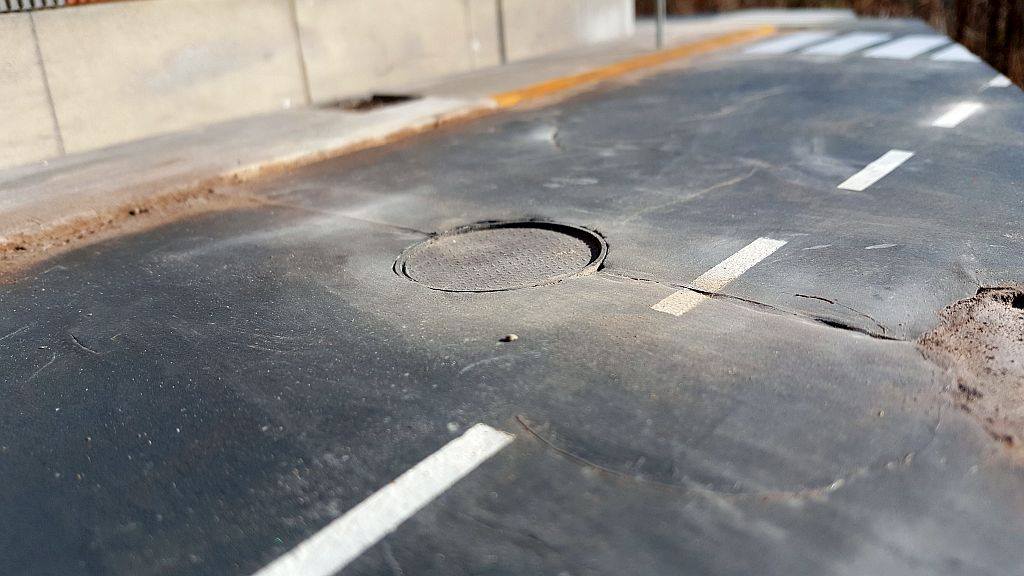

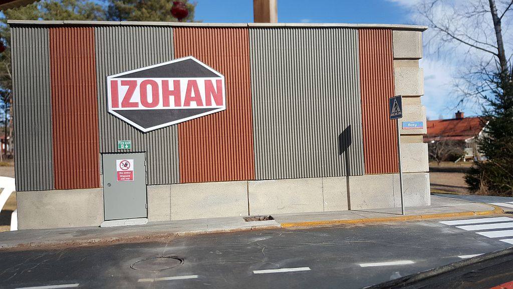

tiking Posted June 15, 2021 Posted June 15, 2021 (edited) The material used here are form board through out the entire diorama. The asphalt is represented by fine grade sand paper. The sidewalk is foamboard painted with a concrete color mix, I had mixed at my local paint store. I used the same paint mix on the concrete portion of the building then used a damp sponge with a mixture of brown and concrete color to blend the colors together to get the brownish look on the building. The corrugated reddish and grey colors are paper material 3 3rd 1stbought from a store in England. The sign was printed on paper from logos I found on the net. The steel door is styrene. Edited June 22, 2021 by tiking 2

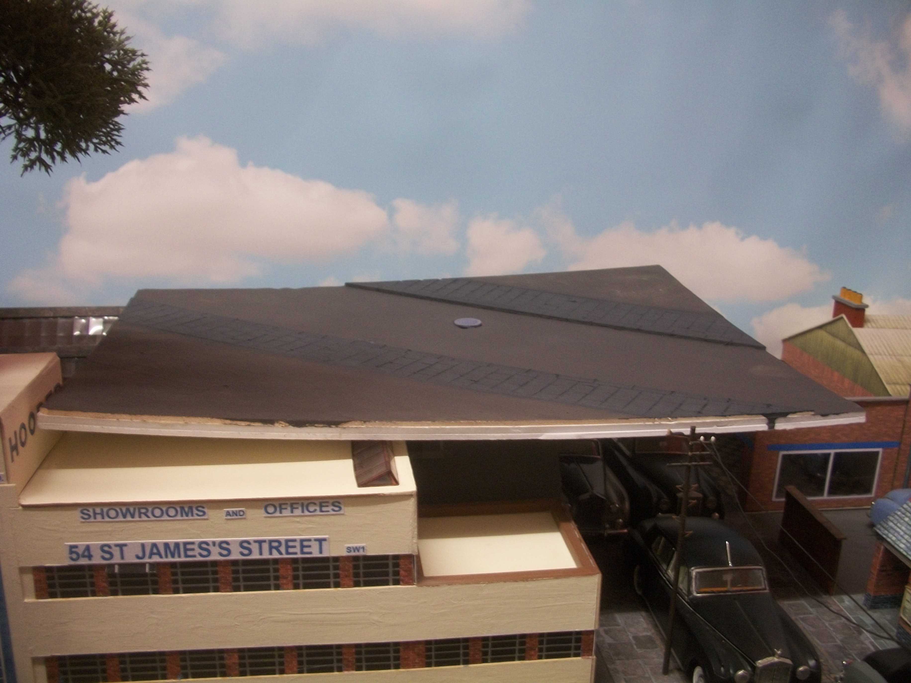

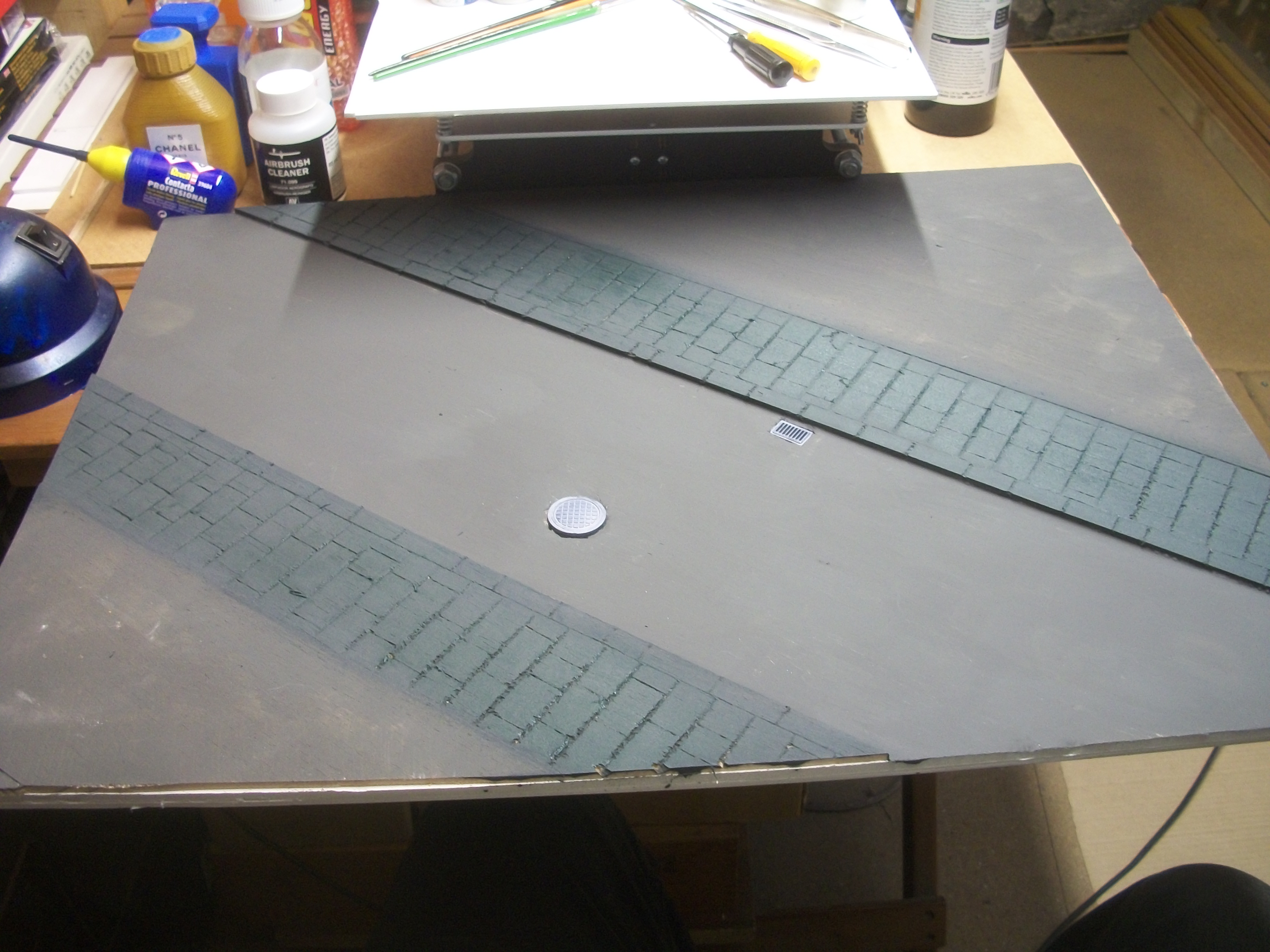

Anglia105E Posted June 25, 2021 Posted June 25, 2021 As other members on here are saying, the level of realism that you have achieved with this particular diorama is exceptional, and I am even more impressed than usual, having viewed all of your previous diorama work. I do have one question, Charles...... Do you have any issues with foamboard warping badly ? Previously I have had display boards made from foamboard warping terribly, inside a humid marquee during a June exhibition of scale model dioramas, and just this past week, I have a 1:32 scale baseboard that is now warping excessively. The layer of foamboard is attached to a Foamex board underneath with strong, wide double-sided tape, like a laminate, but now that emulsion paint has been applied the baseboard is curling upwards. What are your thoughts on this issue, please? (the paving is balsa wood). Thanks, David
tiking Posted June 26, 2021 Author Posted June 26, 2021 (edited) Hi David. I am no pro on this matter but here are a few tips, I've learnt: 1. Use a rattle-can of solvent based primer to seal the object. Test a scrap to see if the solvent attacks the foam. Solvent based clear polyurethane works, too. 1a. Acrylic paint is ideal on foam core because you do not need to use solvents like with oil paints. Acrylic it fast-drying, durable and adheres to most surfaces. It also has an even sheen and does not need a base coat. 2. If you don't need the foam board to be stiff, you can remove the paper by first soaking it with rubbing alcohol. This will diminish warping and allow you to bend it, shape it or apply it to a flat board. I usually just peel the backing off with a sharp hobby knife. 3. If you apply too much paint at once, the outer layer of paper on the foam gets saturated, and as it dries, the paper shrinks but the foam inside doesn't, and that cause the edges of the paper to curl and warp. By you using balsa wood and painting it with water you run the risk of the wood soaking up the moisture thus warping the balsa easily, in turn warping the foam board. I think that's what happened in your case. I could be wrong. I am sure there is more to add...Hope this helps. Edited June 26, 2021 by tiking

David G. Posted June 26, 2021 Posted June 26, 2021 (edited) 12 hours ago, Anglia105E said: As other members on here are saying, the level of realism that you have achieved with this particular diorama is exceptional, and I am even more impressed than usual, having viewed all of your previous diorama work. I do have one question, Charles...... Do you have any issues with foamboard warping badly ? Previously I have had display boards made from foamboard warping terribly, inside a humid marquee during a June exhibition of scale model dioramas, and just this past week, I have a 1:32 scale baseboard that is now warping excessively. The layer of foamboard is attached to a Foamex board underneath with strong, wide double-sided tape, like a laminate, but now that emulsion paint has been applied the baseboard is curling upwards. What are your thoughts on this issue, please? (the paving is balsa wood). Thanks, David In this case David, I think it may be the balsa wood causing the warpage. I've done a bit of model railroading and balsa is generally not recommended for building model structures because in that hobby it has an affinity for moisture and is rather unstable as a result. For something like your diorama bass wood would be more typically used as it is much more stable than balsa very to work with. Hope that's helpful. It looks like you have some good work going there too. David G. Edited June 26, 2021 by David G. typo
